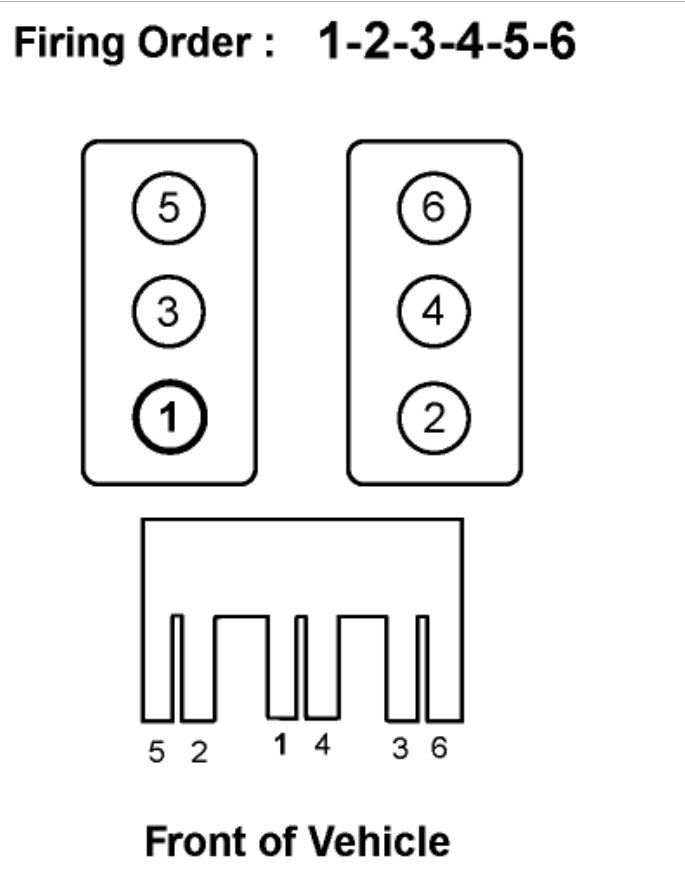

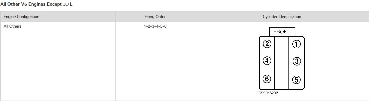

we changed the spark plugs, howver, we need to know the firing order as nothing is working
Sep 25, 2009 at 7:12 PM

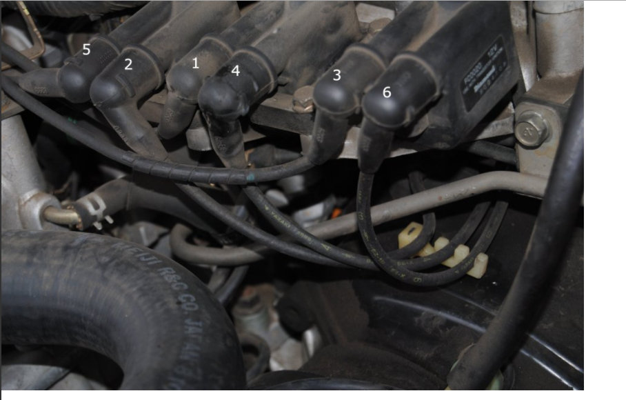

Yes this is an easy engine to mix up the firing order for the spark plugs on. Here are some diagrams that should help you get them back on correctly.
Oct 12, 2017 at 8:10 PM

I am looking for the diagram for the firing order for my Mitsubishi Montero Sport 3.5L V6 4X4 DHOC, and cannot find one. Can you help me with this?
Oct 12, 2017 at 8:10 PM (Merged)
MHPAUTOS
  • 31,937 POSTS
See pic for firing order and cylinder location

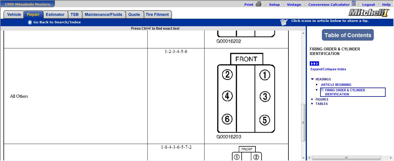

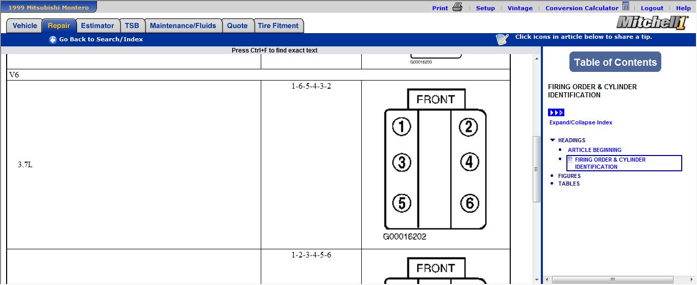

i need the fireing order for a 1999 mitsubishi montero 3.5 v6 can you please help
RASMATAZ
  • 75,992 POSTS
See below

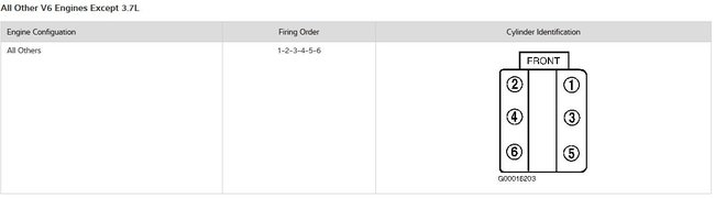

need to know firing order and how it goes for cylinders does it start on the pansenger side and go 1 then to driver side for 2 then second one back on passenger side is 3 then second one back on driver side is 4 then third one back on passenger is 5 and third one back on driver side is 6
If you are facing the engine the 1, 3, 5 cylinders are on your left and the 2, 4, 6 are on your right. Here are the firing order for your car.

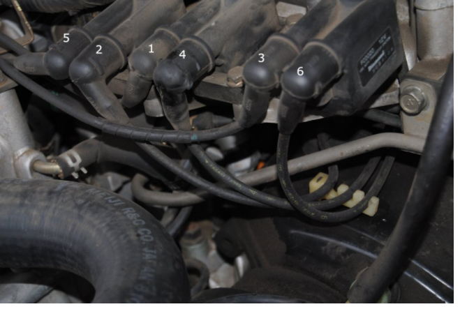

need the order of the cables for spark plug from 1 to 6 in my engine.thank for your help
Dec 3, 2020 at 8:47 AM (Merged)
RASMATAZ
  • 75,992 POSTS
Firing Order Specification . Check out the diagrams (Below). Please let us know if you need anything else to get the problem fixed.
https://www.2carpros.com/forum/automotive_pictures/12900_forder_1.jpg
