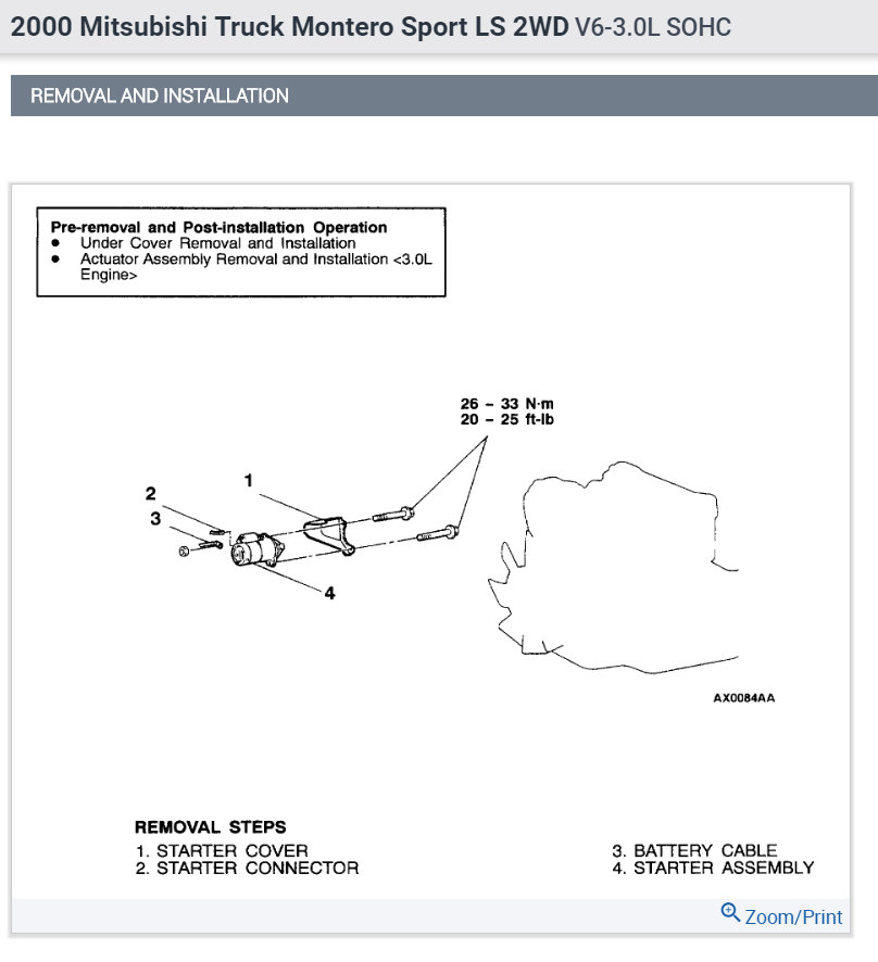

Where is the starter located on this model? Do you have a diagram of where it is?
Thanks
Dec 30, 2009 at 11:05 AM
MERLIN2021
  • 17,250 POSTS
The starter motor is on the right side of the engine down low here is a guide to help you change it out with a diagram below so you can see where it is on your car.
