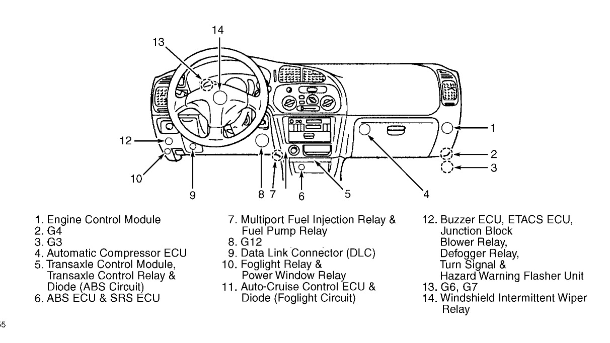

I have a engine code P0120 Throttle Pedal Position Sensor/Switch A Circuit Malfunction on my car, how do i fix this problem? Where is the ECM for my car located at?

if it doesn'tsay expert by the name it's not form 2carpros to fix the throttle position check to seeif it is adjustable first as some are worst case will be to replace it ecm pic location enclosed. but that shouldn't be the problem.
