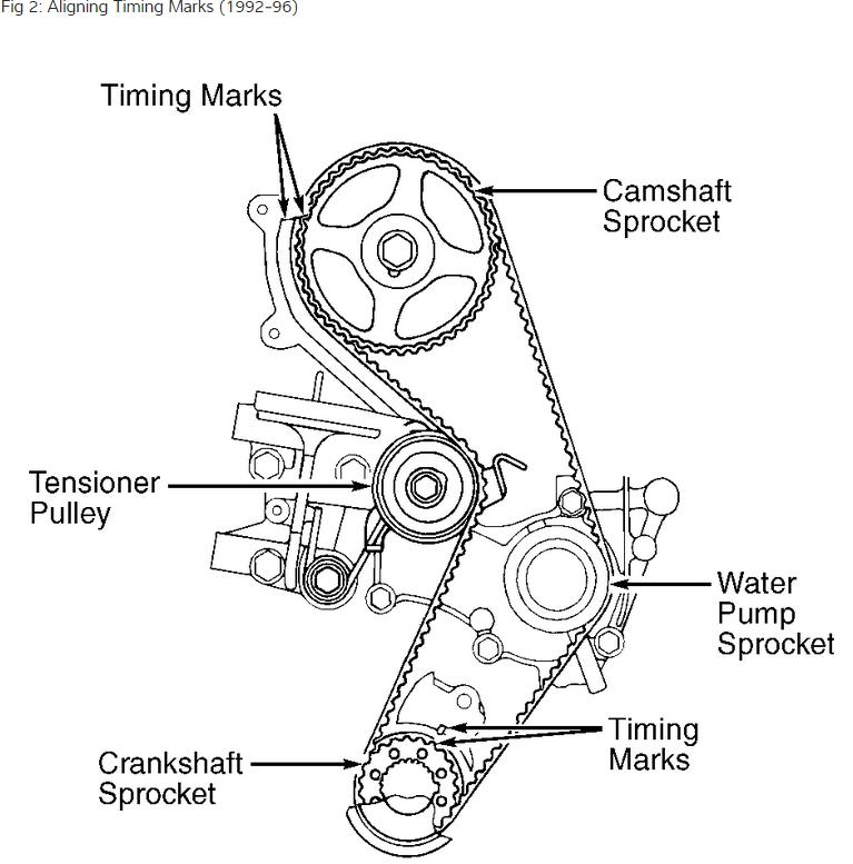

i need to know the timing marks on the pulleys where the timing belt goes they got moved and now car wont start

On the lower gear I aligned the circle on the gear with one at approximately 12 o'clock or slightly later, on the top it currently is around 3 o'clock and the rooter points to 11 o'clock not 4 o'clock where piston 1 is. The books I look suggest the top gear at around 11 oclock. Can you straighten me out so I can put the timing belt back on thankyou so very much dan bender

Refer to diagram

Thank you may I ask. You something my bottom gear is shown I bought Chilton manuel but the top gear would have to rotate by half and then would the rotor point to no.1 spark plug.? Thanks really daniel

Thanks for u r help, I think I have the marks right, is it correct the rotor should point to o1 and then on piston at tdc, how do you know if it is on compression stroke thanks again

i wanna know the timing marks for my 1995 mitsubishi mirage ls 1.8 engine
