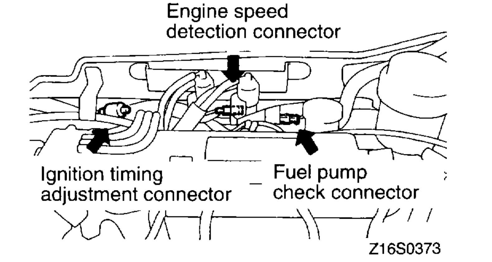

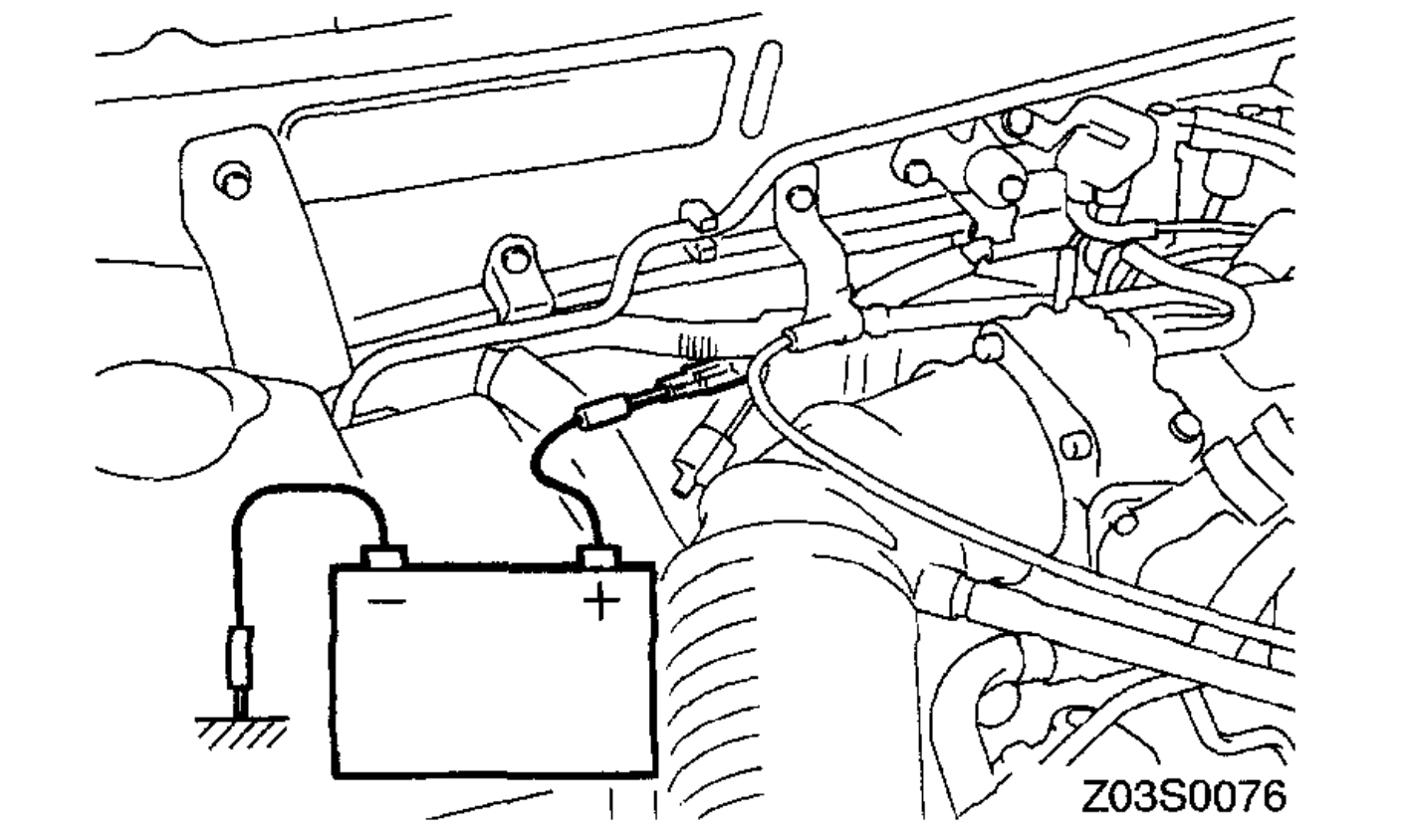

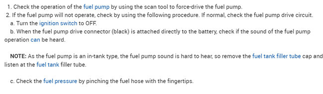

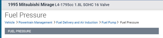

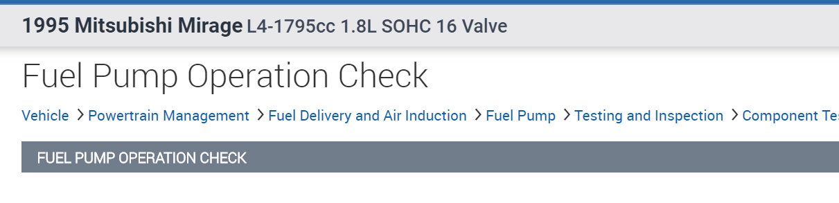

It sounds more like the fuel pump has gone out due to being run dry.To be sure lets run a pressure test. here is a guide to help us get started:

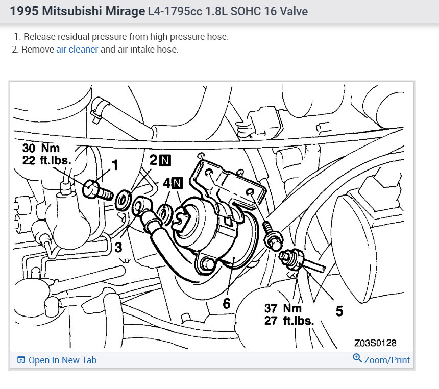

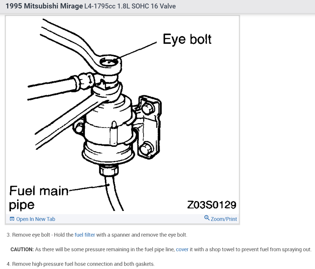

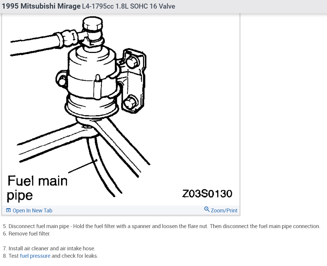

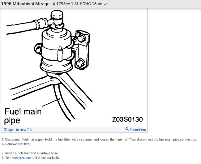

Here is a guide on how to change the filter as well with diagrams below to show you on your car:
https://www.2carpros.com/articles/how-to-change-a-fuel-filter

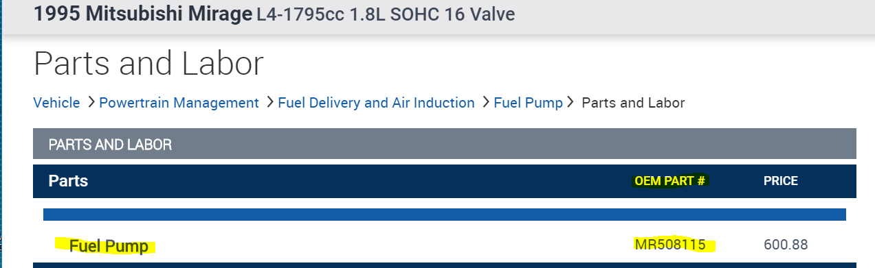

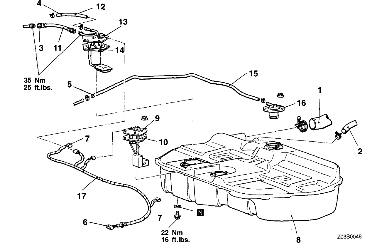

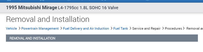

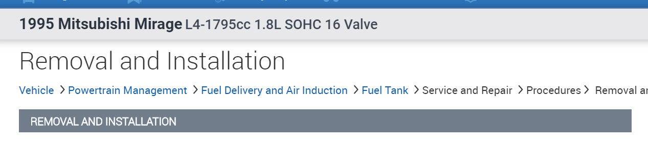

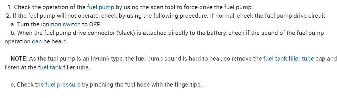

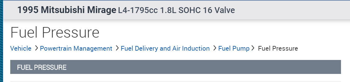

In the diagrams down below i have included guides for testing and inspecting your vehicle's fuel pump, fuel pressure and also instructions for the removal and installation of the fuel pump should it be bad. Please go through these guides and get back to us with what you are able to find out.
Thanks,
Alex
2CarPros
