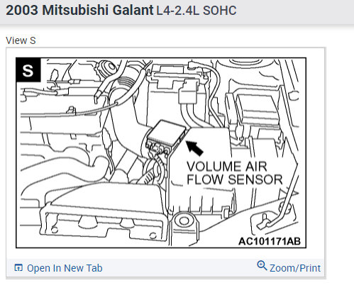

This could be due to a dirty mass air flow sensor.
That sensor is located at the end of the air intake tubing, just before the air filter box.
You can service the mass air flow sensor by cleaning it. That could fix the issue.
You might find these articles helpful:
https://www.2carpros.com/articles/how-a-mass-air-flow-sensor-works-maf
https://www.2carpros.com/articles/mass-air-flow-service
Many times with poor idle the check engine light gets triggered.
Is your check engine light illuminated? If you retrieve the codes as it can help with the diagnostics.
I have attached the diagram for your reference.
