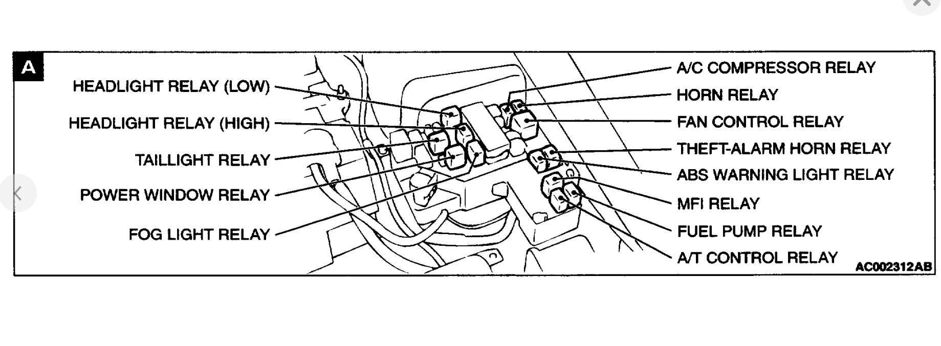

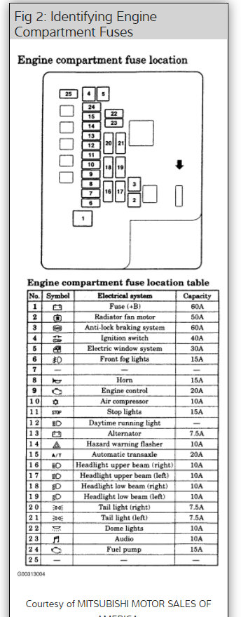

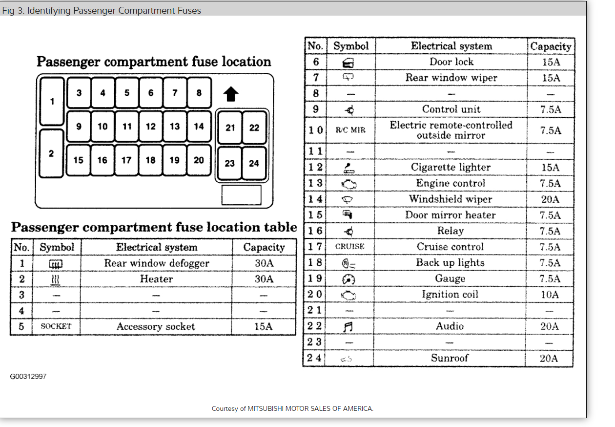

You tested fuses- 4,6,7,19,22,23 ? The last two are in the underhood power center. All that you describe is powered through the ETACS ECU, which is the body controller. Here is a guid to help check the fuses for power and the fuse location in the diagrams below.
Check out the diagrams (Below). Let us know what happens and please upload pictures or videos of the problem.
