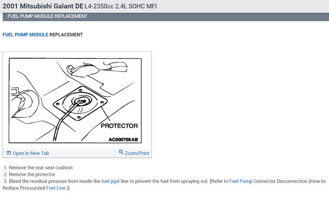

Where is my fuel filter located on my ES model?
Aug 16, 2010 at 2:32 PM
DOCFIXIT
  • 18,828 POSTS

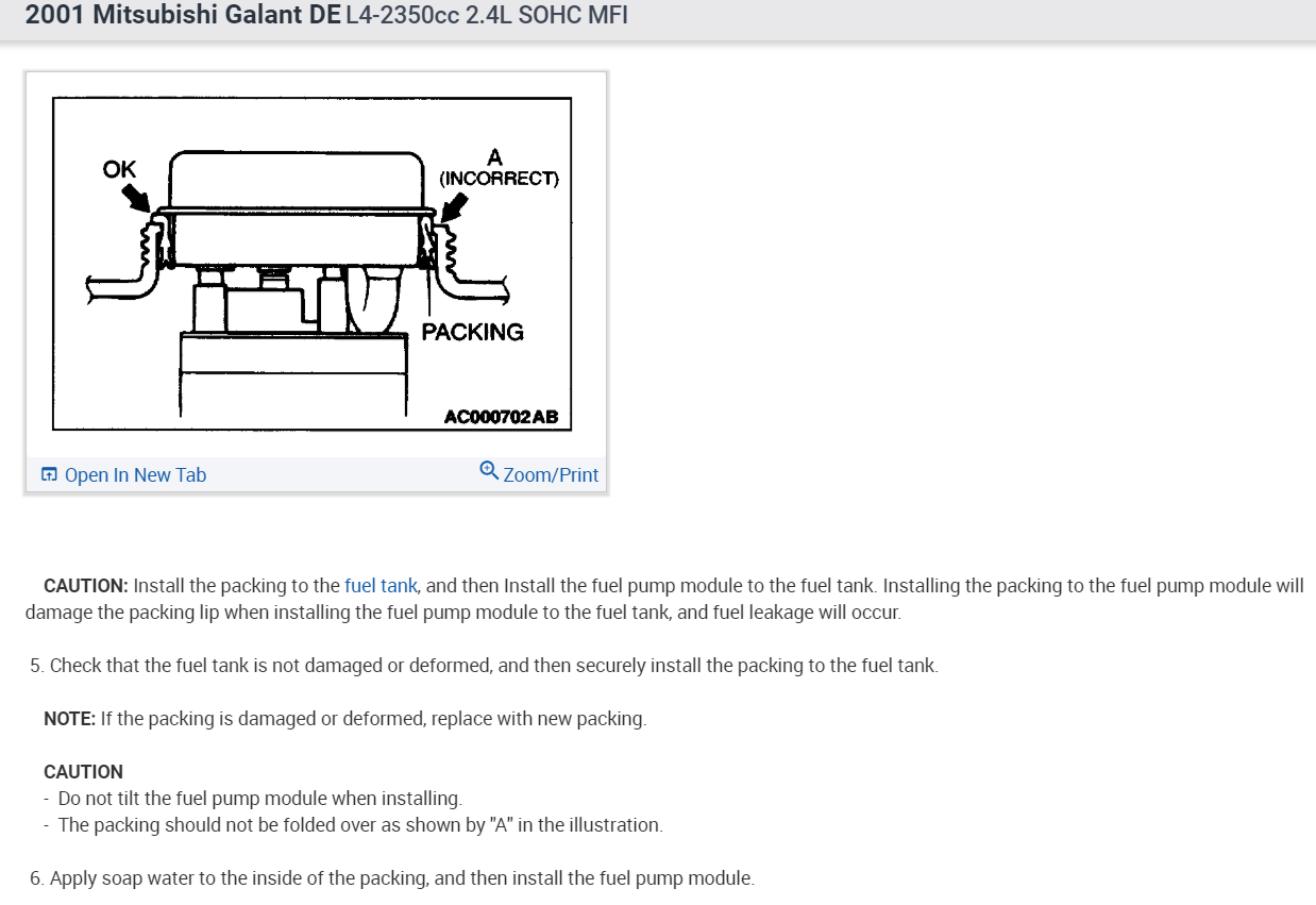

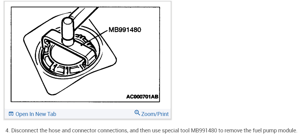

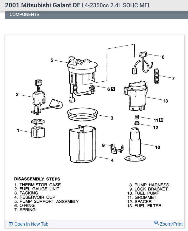

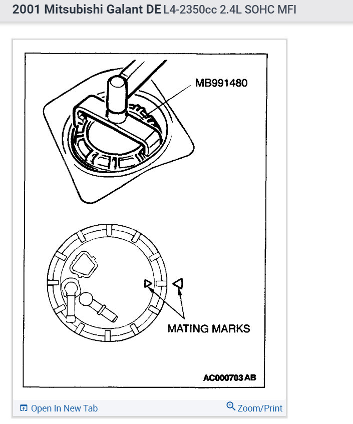

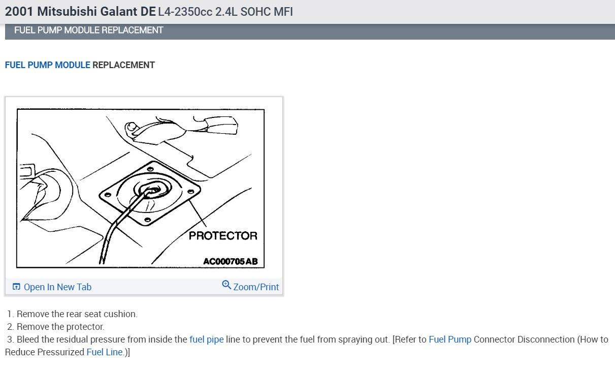

THe fuel filter for this car is in the fuel tank with the fuel pump here is a guide and diagrams below to show you how to change it out. The pump has a trap door which is nice so you don't need to drop the tank
Cheers

There is only a in tank filter in the pump, normally you do a fuel flow & pressure test and if it is below spec's you replace the pump.

If no fuel filter is found at the firewall, it would be in-tank, together with the fuel pump access from under the rear seat.

HERC20002003
  • 11 POSTS
Under the back seat remove the cover then remove the fuel pump. The strainer is on the bottom.
