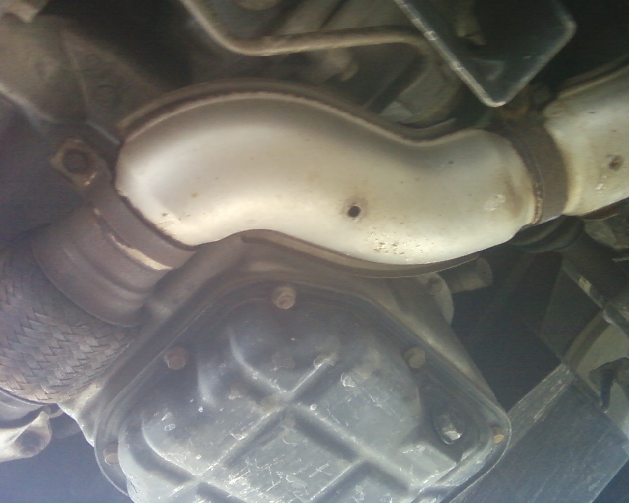

Thanks,Cardiodoc :) I found what seems to be the rattling problem I was having. One of (if not both) of my heat plates are rusted off. At the end of the strap that holds them in, the plate is coming off. When I tapped the exhaust line, the rattling was at that point. Unfortunately, I'll have to go to the dealer to get the part(s) needed. I will be sure to tell them of the smell again. HOPEFULLY, they will listen this time, as now Im out of warranty, but when I first complained about it, I was IN warranty. Gotta love dealers. :/ But the smell is definitely from the tailpipe end, versus the battery. (Never heard of THAT one before). I learn something new every day. :)

Rattling heat shields can be tack-welded with a wire feed welder. A simple do-it-yourself trick is to band it with a large screw-type hose clamp. Use two of them, end-to-end, if you need a longer one. If that holds the two halves together yet lets them rattle over the pipe, simply bend them a little flatter to remove part of their curve, then clamping them will hold them tighter to the pipe. Another trick is to wedge a piece of metal through a hole or through a slot you cut in the shield to take up the gap between the pipe and shield, then clamp it in place with the hose clamp. Also, if you can find a soft spot, typically due to rust, you can pound in a depression, then wrap the hose clamp around it with a small piece of metal pipe in the depression. The hose clamp will squeeze the pipe to hold the shield against the exhaust pipe. These things work on many import vehicles that have two half shields welded together as appears to be the case in your photo. If you have just one half shield, those are easier to flatten out by hand so the clamp will hold it to the pipe better. The shield in your photo has a smaller diameter on the end where it holds onto the pipe. That is a good place for a hose clamp. First try to bend the edge of the shield up in just a few small spots. That will give the slots in the hose clamp something to bite onto to prevent the clamp from sliding off the shield.

Thanks so much Caradiodoc. I honestly never thought of doing that. It may just work!! I am by far, no car expert. So me finding this little nuance is half my battle :) I had no loss of power,engine tone-- nothing. So eventually I figured out it was a simple rattle. After banging on the tailpipe, I worked my way to this little section in the picture. My problem is, I would (possibly) need a diagram to see if the two shields are ONE, or if they're two SEPARATE pieces. If I do as you say, that is- to make little dents in it to keep it from rattling on itself, will it affect the way the shield is supposed to work. My understanding is, they're not actually supposed to touch the pipe. Will the few dents I make affect that purpose? And would you believe, in the world of Internet Everything, I cannot find ANYTHING online about a diagram of this car's exhaust parts?! Unbelievable! Its the ONE THING you cant find online these days!! :) If you look at the pic,the shield is only loose/ broken off on the left side (closest to the engine side). My concern is, if I loosen the 2 bands holding it in, is the bent shield piece thats rusted off ONE shield, or is it part of a whole, larger piece. Because these shields go up into where I cannot reach. Thats why I need a diagram. Hopefully the dealer will have THAT much for me :) Thanks once again for all your help. I will definitely try the metal band trick!!!!!!!!!

Let me clarify about the shields. You have two-piece shields crimped together on the sides. Some cars have just a half shield on the bottom. They are designed to keep leaves away from hot parts. Full shields like yours reduce heat transfer to nearby engine and transmission parts and wiring harnesses. Minor modifications like dents and adding clamps will not have any affect.
One more trick I forgot about that is real easy is to drill about a 1/8" hole in the middle of a shield, then run a self-tapping screw through it. Grind the point off first so it doesn't try to go into the pipe. Also, the point would wear down over time and the shield will rattle again. This only works when the two halves of the shields are still solidly attached to each other.

Well, caradiodoc-- I ended up at the dealer today. Found out, I still have some warranty. about 4000+ miles, or 9 months. So THAT was some good news this morning. They told me theyre 'just going to rip it off.(the shield) Mitsubishi is telling us to just do that- there's no more replacing those parts'
I stood there in shock for a minute. "WHAT?!" My logic is, if it was there to begin with, it needs to be put back on,right?! :) I know it's just a shield, but I dont know-- to me, it sounds as if they dont want to be bothered, or they have no solution to fix it (But YOU DID!!!!) I am going to let them do it. Since I am under warranty, I might as well use it. And theyre going to check out the egg smell/ cat converter--- but the dealer told me, "If theres no light, no codes, then we cant do anything for you.There would be nothing wrong"... Well, I will be documented for TWO complaints, so we'll see where THAT gets me later. But definitely after warranty, I will be looking for a foreign/Mitsu.repair shop around me. This dealer cant do much more than brakes and rotors.
