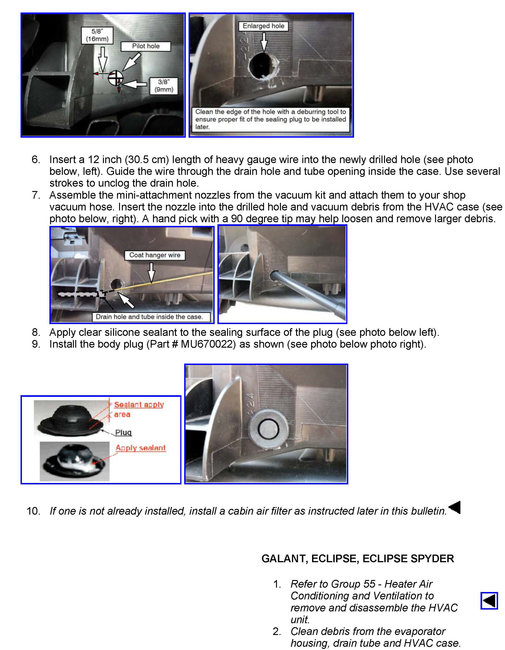

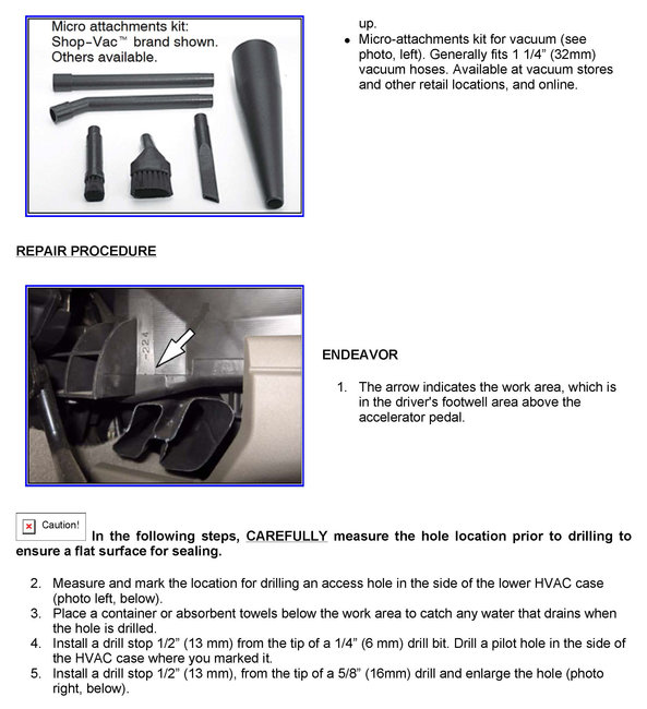

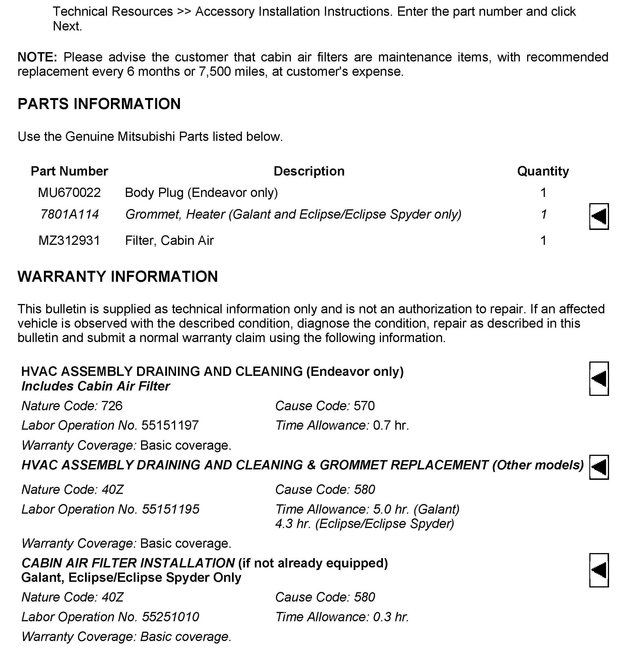

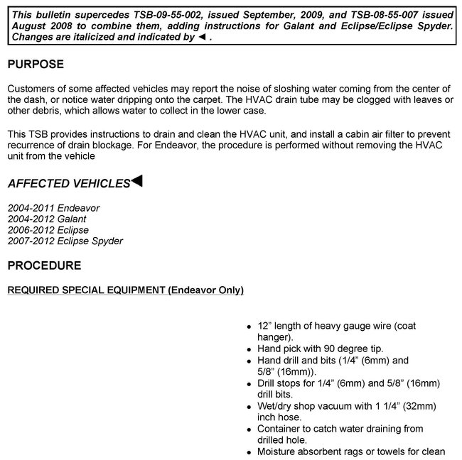

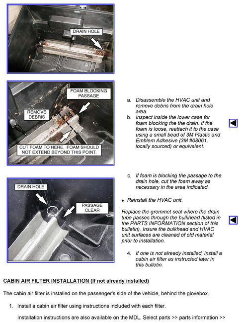

The TSB listed above has been superseded. Here is the most updated one that explains how to fix the issue. The attached pics correlate with the directions.
2004 Mitsubishi Truck Endeavor V6-3.8L SOHC
A/C - Sloshing Noise From Dash/Water Dripping Onto Carpet
Vehicle Maintenance Filters A/C - Sloshing Noise From Dash/Water Dripping Onto Carpet
A/C - SLOSHING NOISE FROM DASH/WATER DRIPPING ONTO CARPET
No: TSB-12-55-002
DATE: April, 2012
MODEL: See Below
pic 1
pic 2
pic 3
pic 4
pic 5
SUBJECT:
WATER SLOSHING NOISE OR WATER LEAK FROM
HVAC CASE - REVISED
