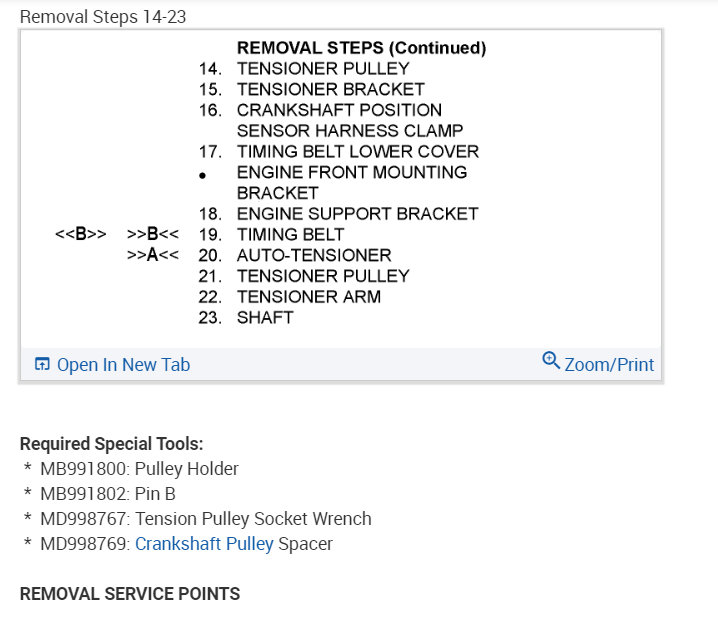

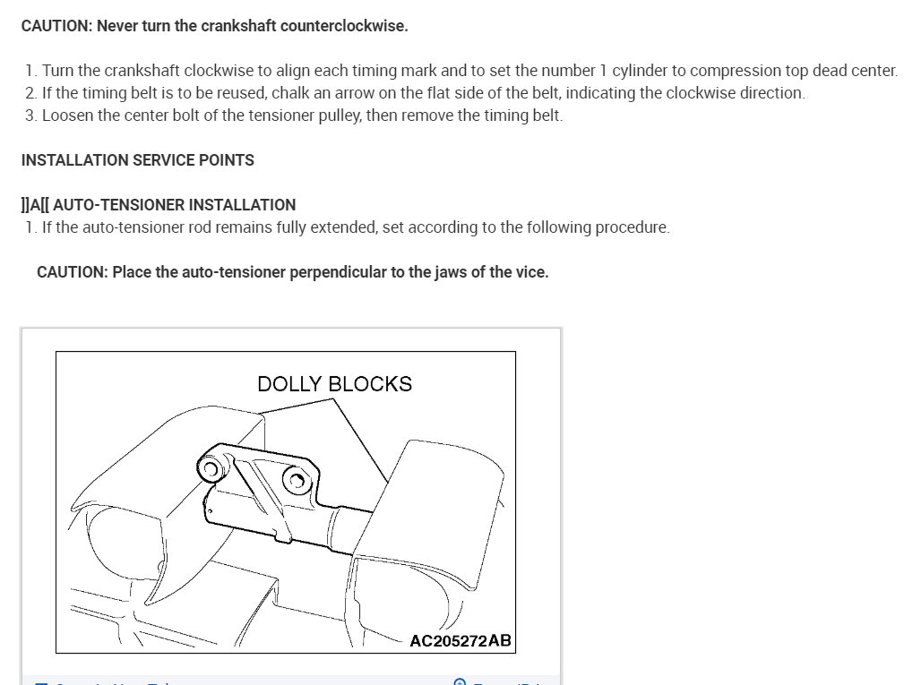

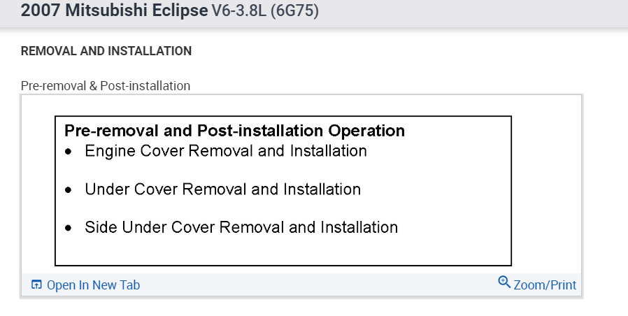

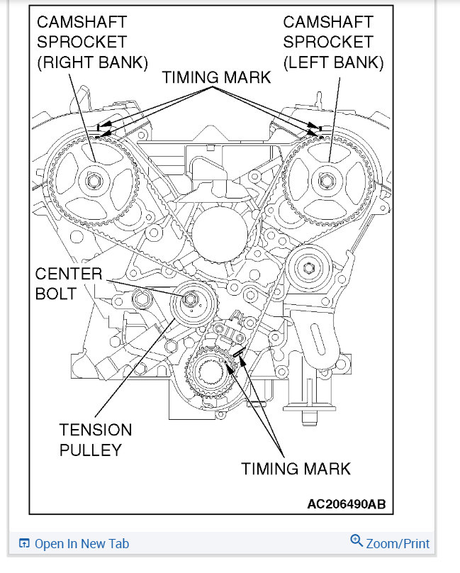

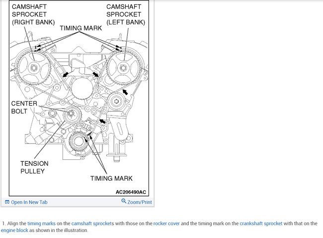

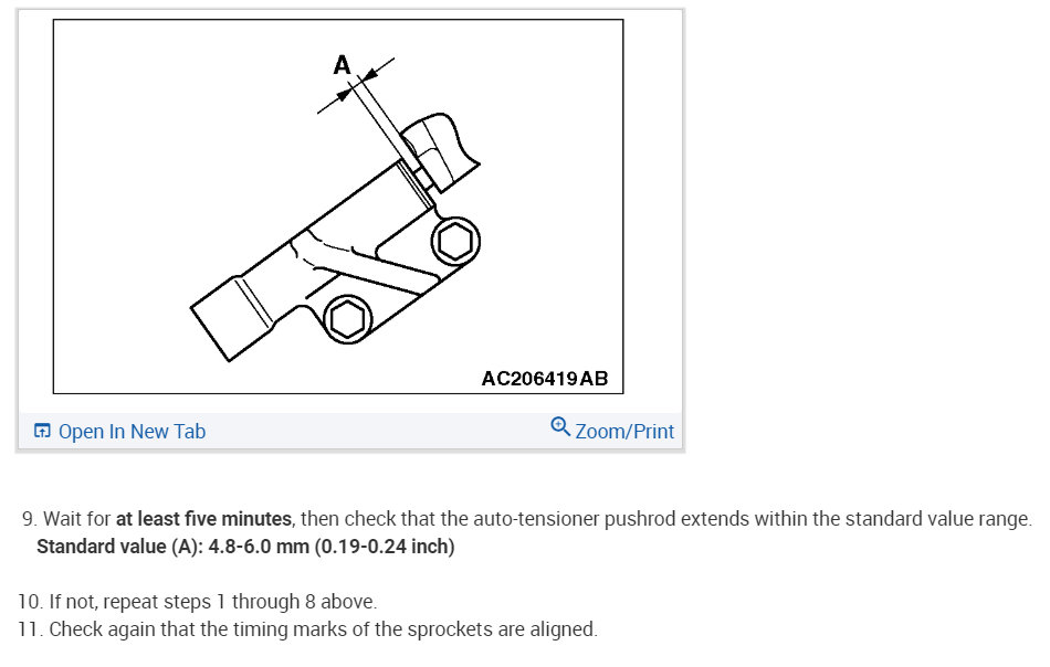

does 3.8 liter v6 have a timing belt and is it hard to replace?
May 10, 2010 at 9:04 AM
MHPAUTOS
  • 31,937 POSTS

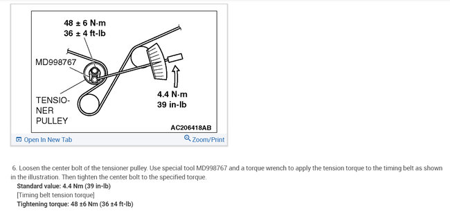

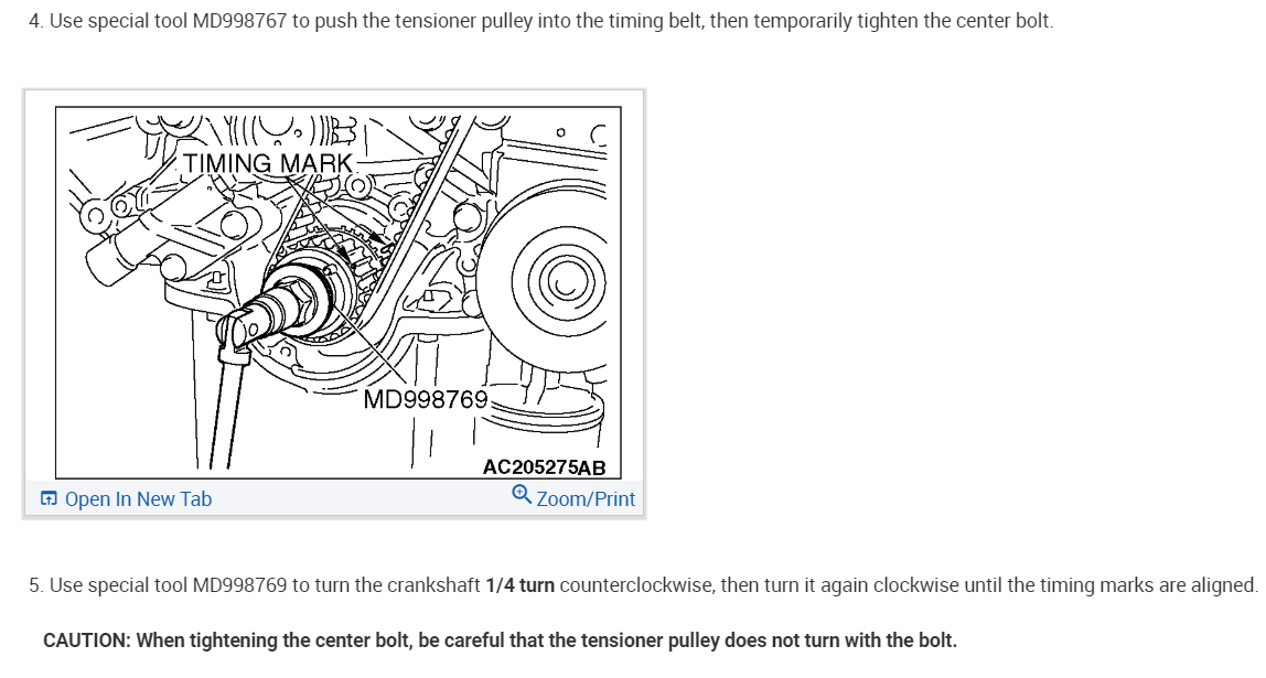

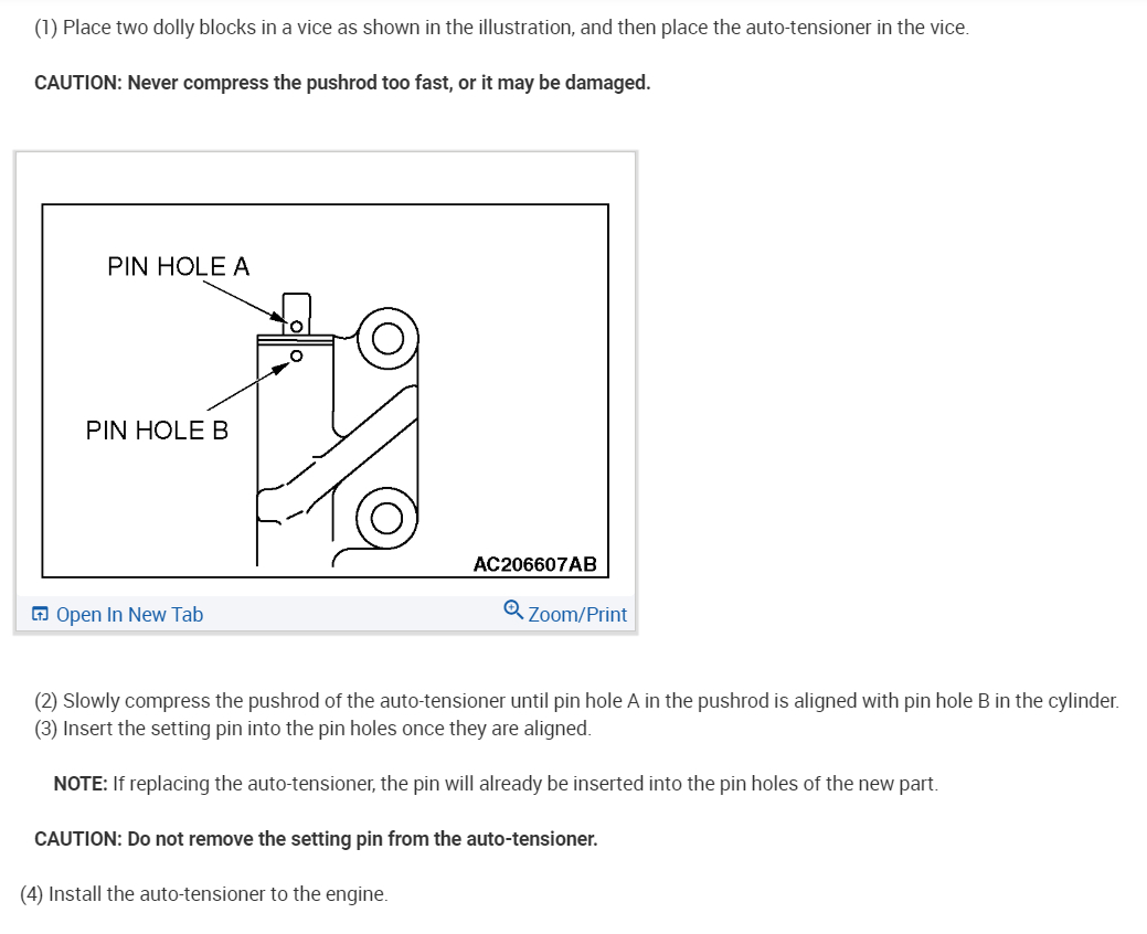

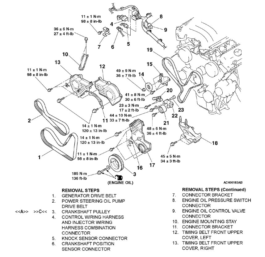

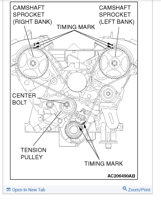

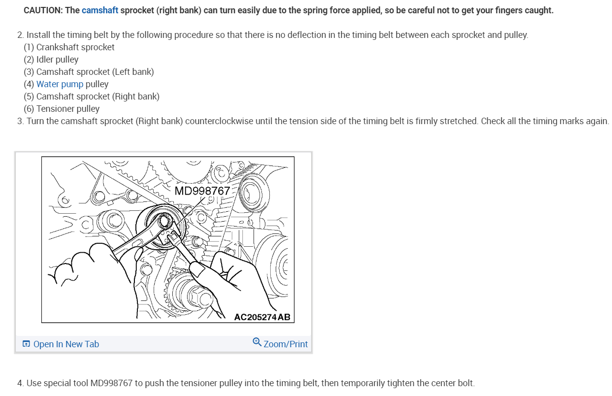

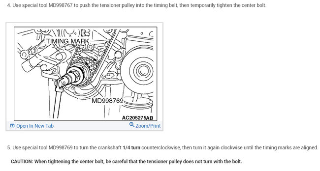

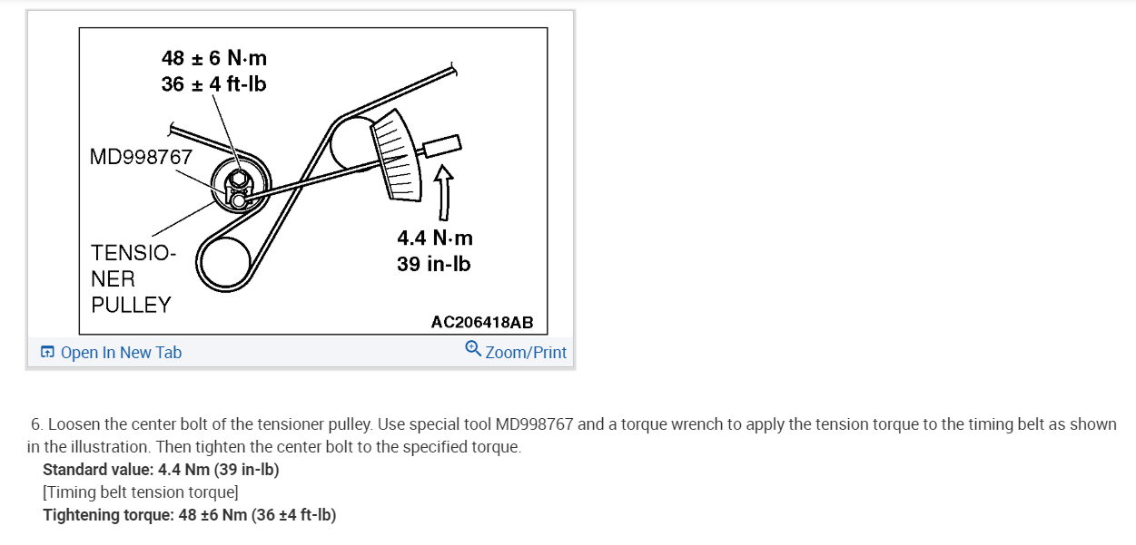

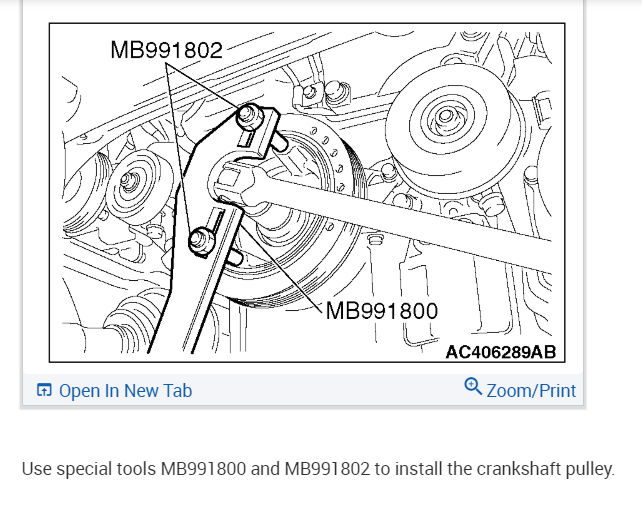

Hi there,

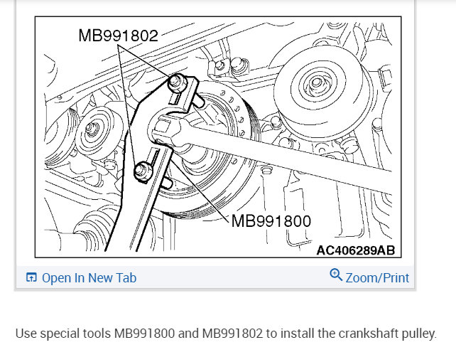

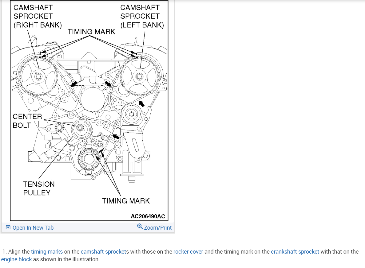

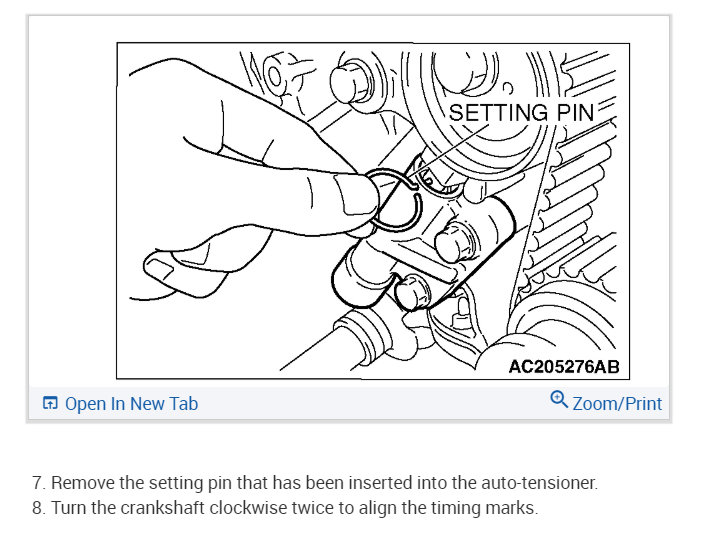

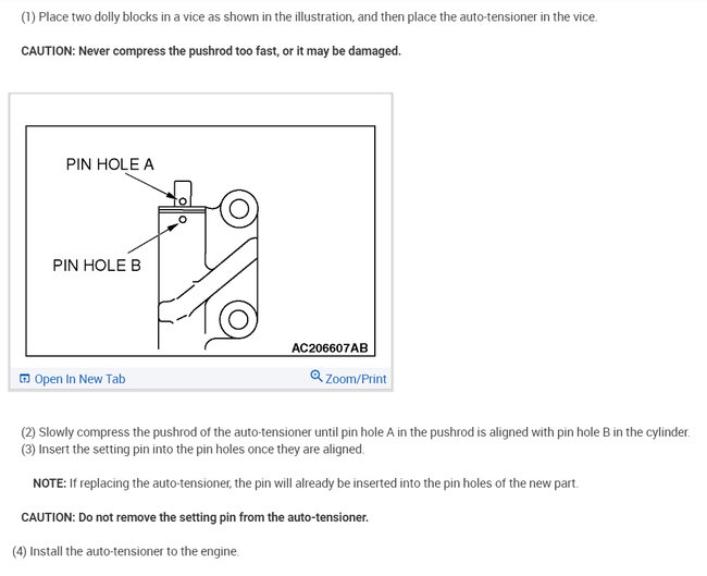

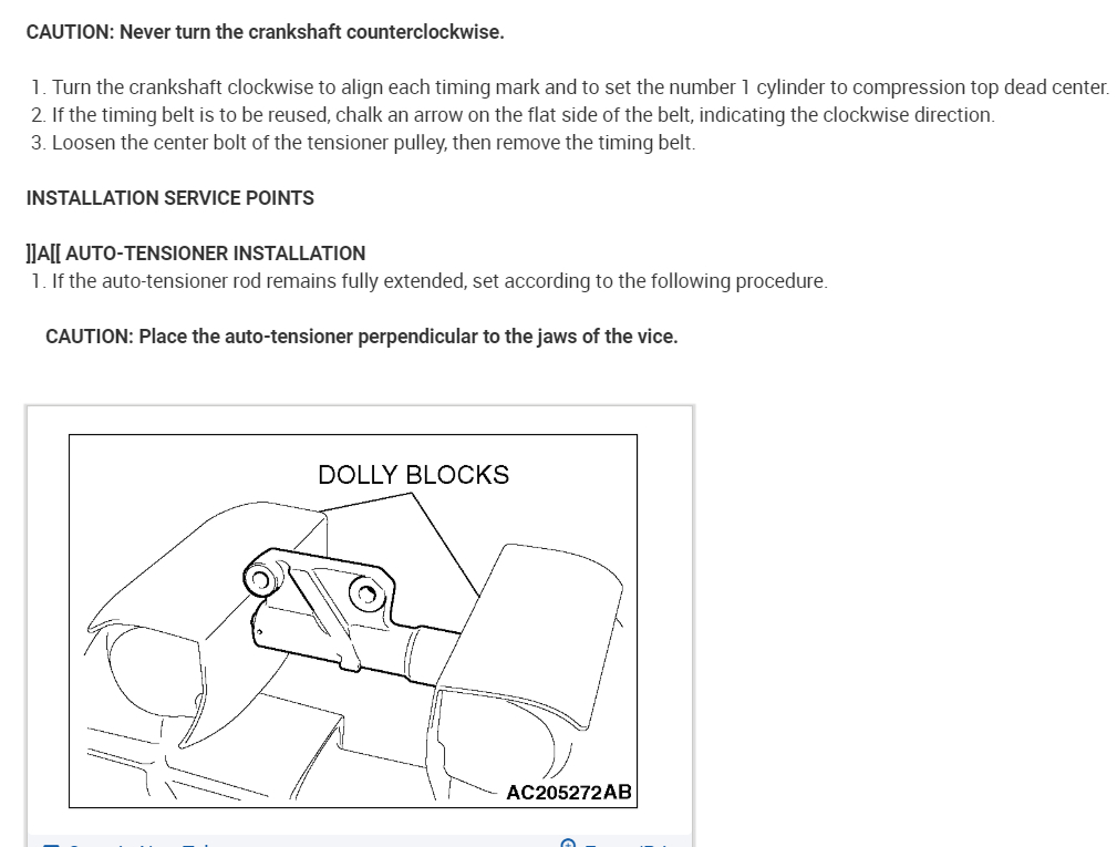

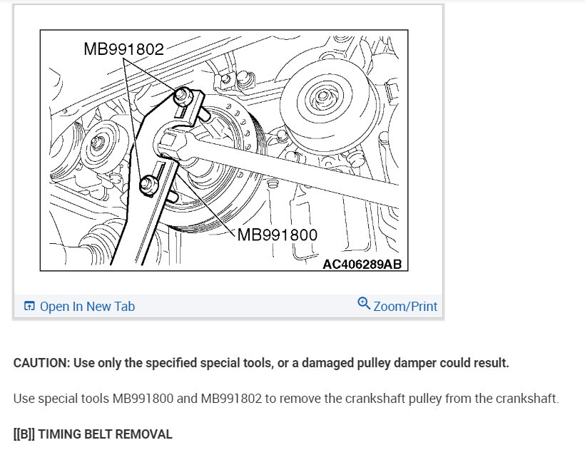

This engine has a timing belt, here is how to replace the timing belt int he diagrams and instructions below. Check out the diagrams (Below). Please let us know if you need anything else to get the problem fixed.
May 10, 2010 at 9:12 AM
