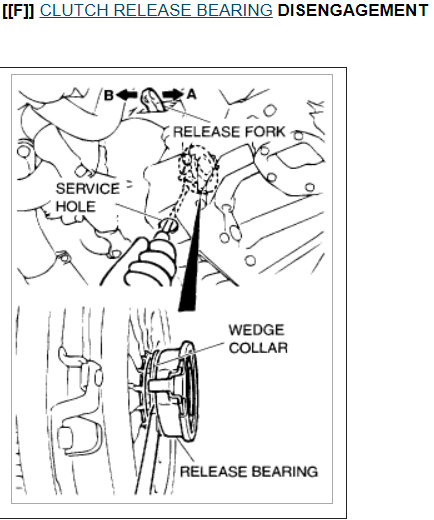

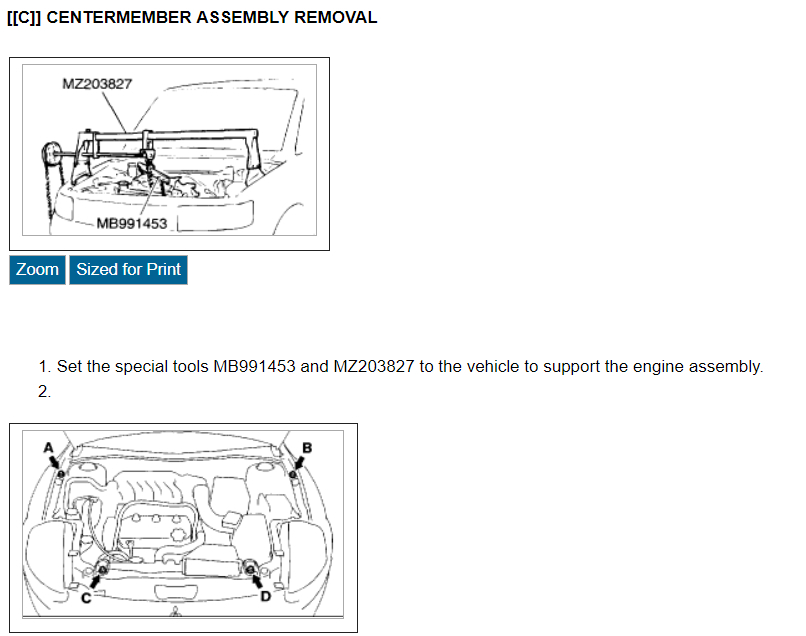

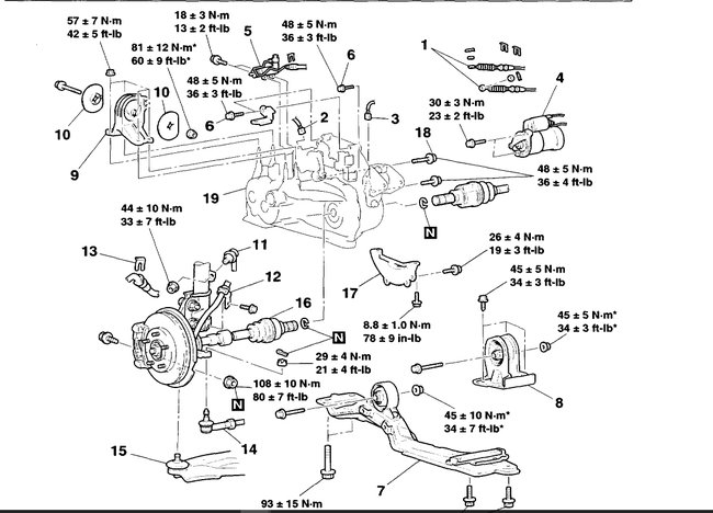

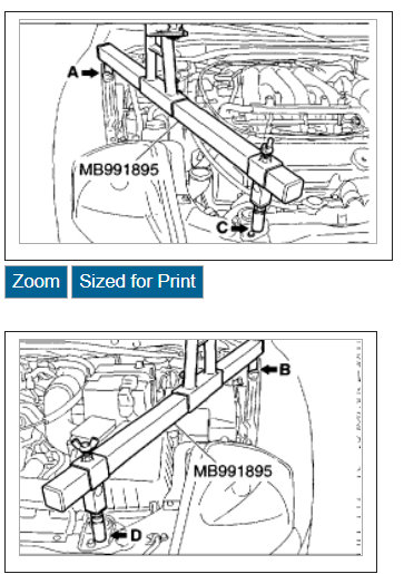

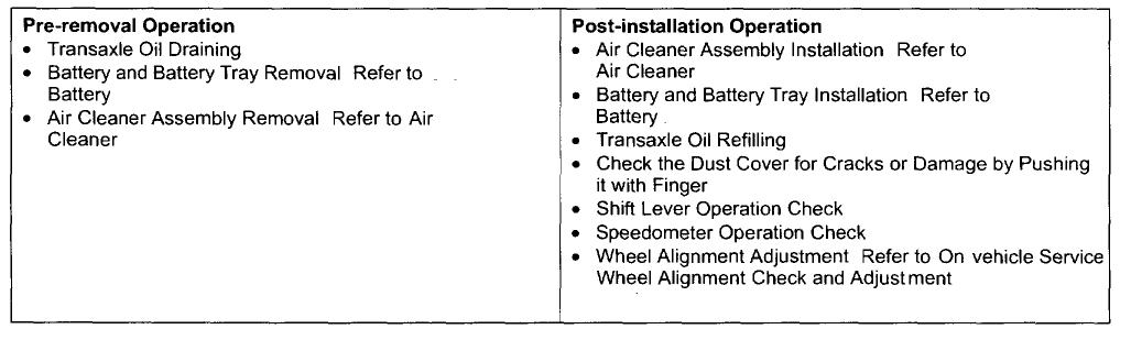

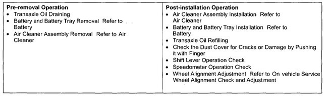

It sounds like the clutch disc has fallen part leaving no material to grab with. Here is a guide to help you see what you are in for when changing the clutch out by removing the transmission.
https://www.2carpros.com/articles/transmission-replacement-removal-manual
and
https://www.2carpros.com/articles/how-to-replace-a-clutch
You will need to remove the CV axle.
https://www.2carpros.com/articles/replace-cv-axle
