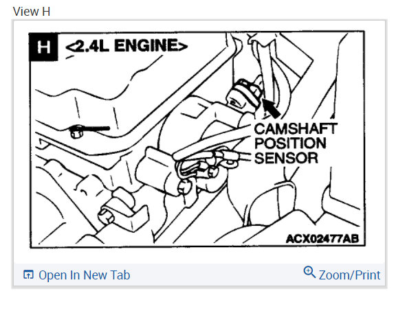

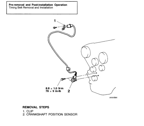

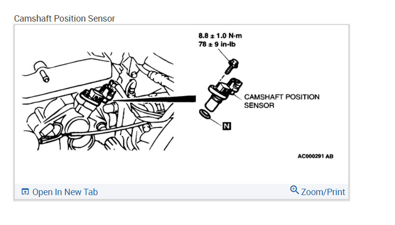

When completely stopped in drive, there is a vibration that shakes the entire car. When in park there is still a vibration, just less severe. While driving, the ride is smooth. The check engine light is on and it read that the crank and cam sensors were bad. I changed the crank sensor and the problem remains, the code reader still reads a bad cam sensor also. How do I replace it?
