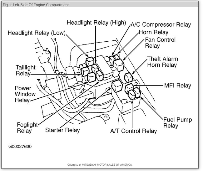

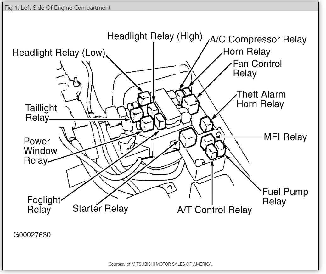

Where is the fuel pump relay located on this vehicle?
May 31, 2009 at 2:43 PM
Hello, The fuel pump relay is located under the hood in the relay center. Here is a guide that will help you do some testing. https://www.2carpros.com/articles/how-to-check-an-electrical-relay-and-wiring-control-circuit
https://www.2carpros.com/forum/automotive_pictures/188069_01eclipserelaybox_1.jpg
Here is the location BELOW Please let us know what happens. Cheers, Ken

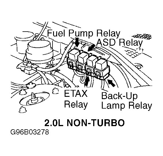

I looking for a diagram for where to remove and install fuel pump relay (none turbo).
Nov 17, 2017 at 6:13 PM (Merged)
HARRY P
  • 2,292 POSTS
This is under the hood, drivers side if I am not mistaken.
RONNY MARSDEN
Mine only had two in that same area it sure help after seeing three other diagrams. so I picked the left one our if the two and it works now. thank you
