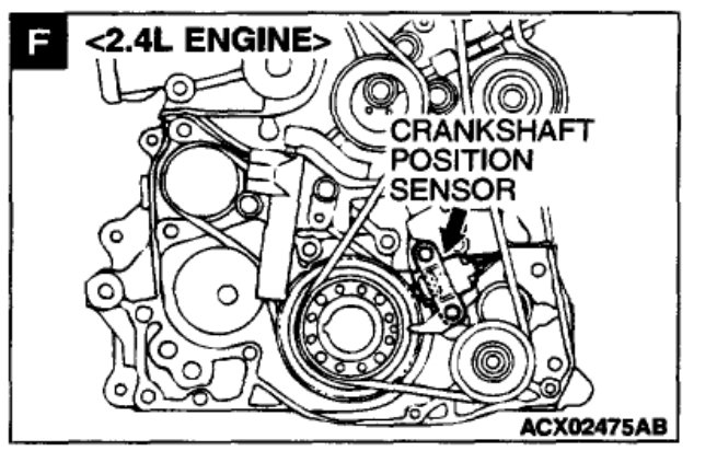

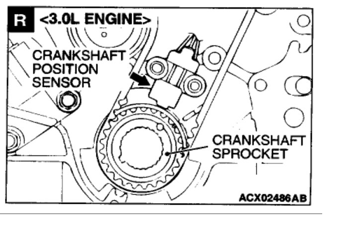

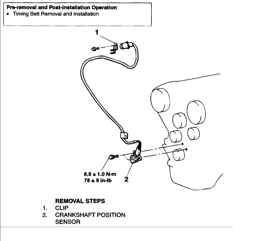

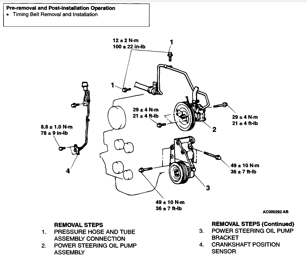

The crankshaft sensor for this car both 4 and 6 cylinder engines is in the front of the engine by the bottom timing belt gear.
Here is a guide on what you are in for when doing the job.
Here are some diagrams for both 4 and 6 cylinder engines. (below)
