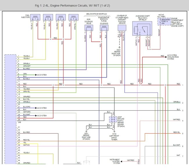

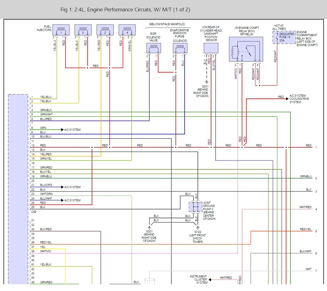

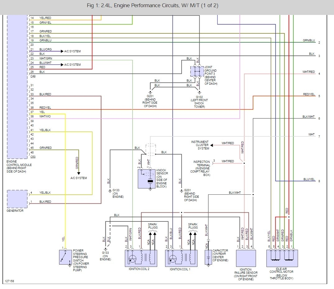

There is an ignition failure sensor that can go out causing the injectors to stop working as a safety feature. here is a wiring diagram that can help you test for the problem.
Check to see if everything is getting power and a good ground.
Please run some tests and get back to us so we can continue helping you.

Although it would require some testing with a lab scope to find out, it sounds like the ignition module may be having a problem forwarding the tach signal to the PCM but that's just a wild guess.
Mar 22, 2017 at 6:42 PM (Merged)
JTMECH
  • 4 POSTS
thanks wrenchtech, do you think the ignition module could only cause cyl's 3 and 4 to pulse every 3 to 4 seconds? thanks
Mar 22, 2017 at 6:43 PM (Merged)
WRENCHTECH
  • 20,761 POSTS
Yes, I just said it was POSSIBLE but I'm NOT saying to automatically replace it.
JTMECH
  • 4 POSTS
is'nt the ignition module in the ecm?
WRENCHTECH
  • 20,761 POSTS
Yes, after looking at the wiring diagram again, it appears you are correct. I thought that one had a separate igniter but it doesn't.
