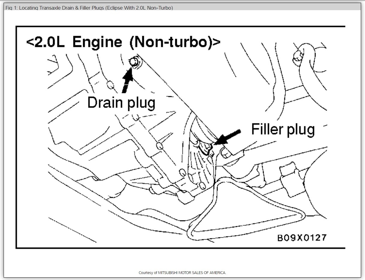

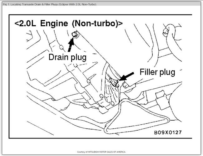

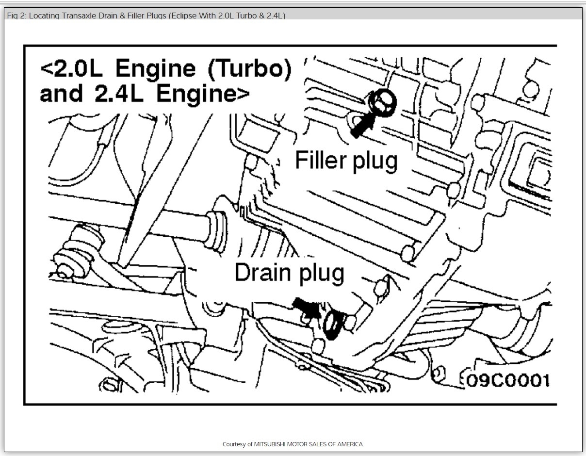

Hello, I need to check and possibly fill my transmission fluid, however I can not locate the dip stick. If possible, can you include a picture or diagram as to where I can locate this in your response. Thanks!
