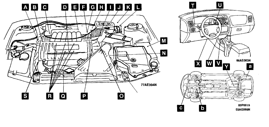

I need to know location of oxygen sensor sensor 1 bank 2 please help me!

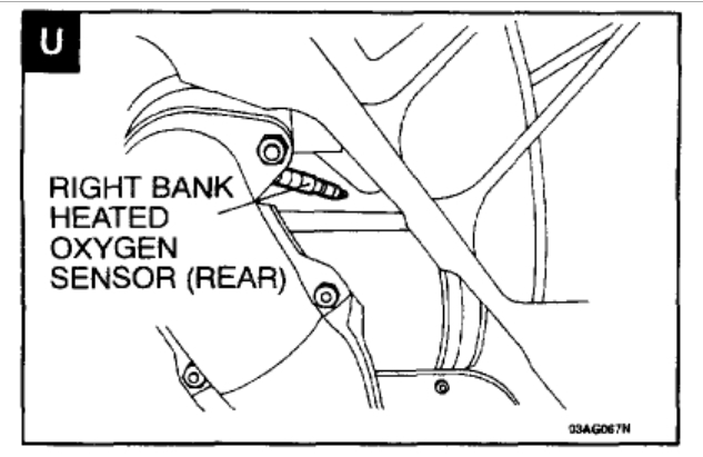

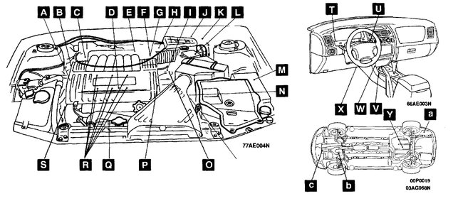

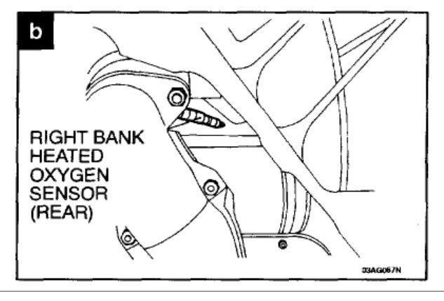

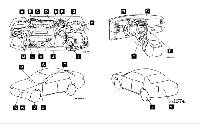

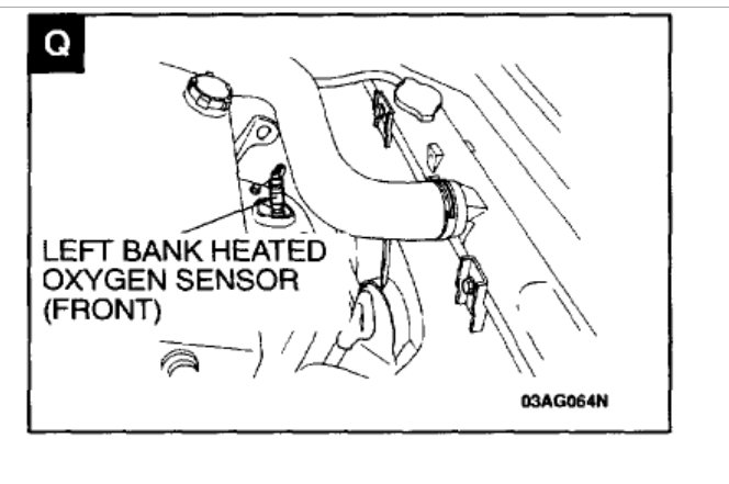

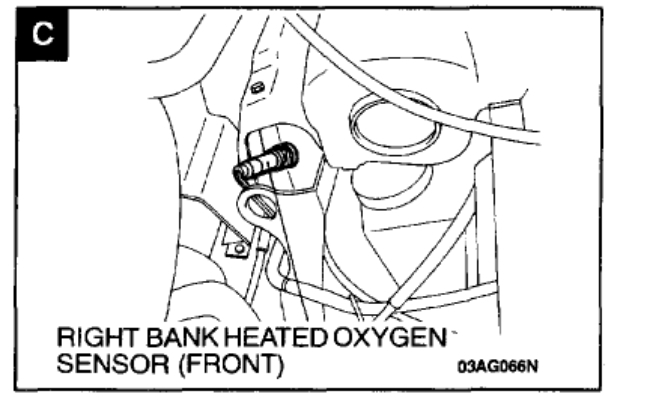

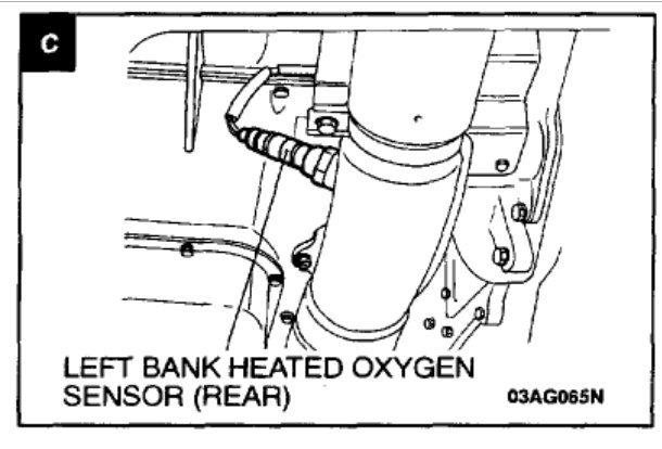

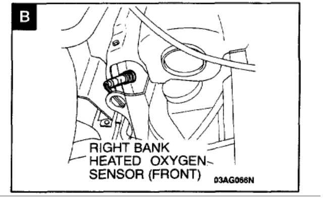

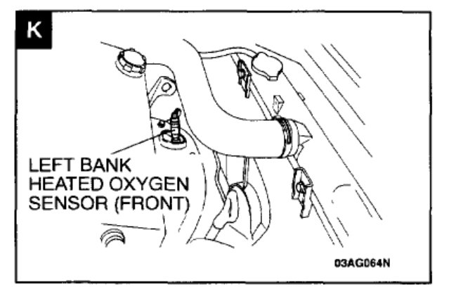

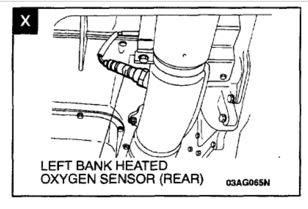

Here are the locations of each oxygen sensor both bank 1 and 2 upstream and downstream sensors.
