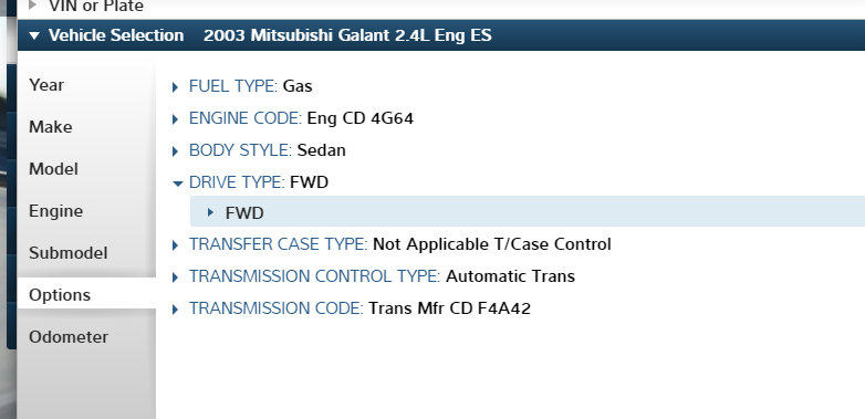

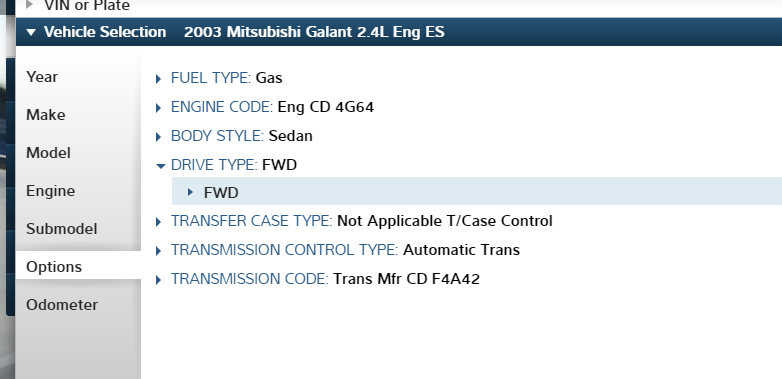

Yes. This is possible on most all vehicles but I don't show this being an option for your vehicle. That means this is extremely more complicated. This means that you have to now source the parts that will fit your vehicle and fabricate the parts needed to hold them in place. In other words, because this was not an option, I would not try it. If an AWD option was available for this vehicle then it would be just a matter of getting the parts and they would bolt up but again, I would not try this.
It would be far easier to purchase a vehicle that is AWD and sell this one as is.
I attached the options below showing that FWD is the only option. Let me know if you have other questions on this. Thanks

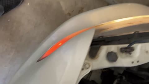

I don’t trust myself to do that it’s bad you can’t start it with the hood open or it damages your ears it’s as loud as an alarm if not louder.

It sounds so bad I have no idea what it is.

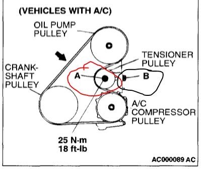

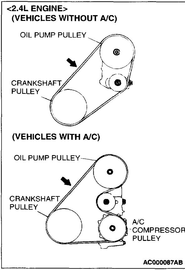

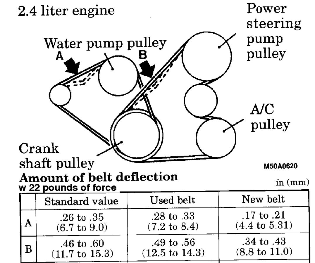

That is belt squeal, Easy test, take a spray bottle or just some water and with it running spray some on the belt in the wheel well between the AC and the crank pulley. The bearing in the pulley on them can cause a lot of drag when they start to fail. The other main screamer could be the alternator. Use the water and see where using it changes the sound. You say it goes away after a while so that sort of makes me think it's alternator, If you let it stop, then turn on the lights and heater blower to high does it start again? Another trick to spot a binding item, take a piece of chalk or a marker and with the engine off draw a line across each of the pulleys. Then have someone start it while you watch them.

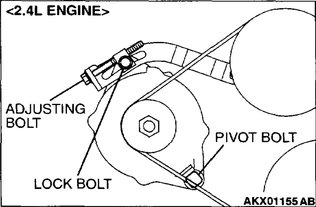

The last thing is that it could simply be the belt is loose. Both of those have manual tensioning instead of automatic, so as a belt wears and stretches it will need to be tightened. To do that the images below show the locations of the tensioner bolts. You loosen the pivots on the alternator and tighten the bolt to put more tension on the belt. To measure if it's correct, simply push down on the center area between the two pulleys, it should move about one quarter inch. Tighten the pivots back down, then start it and see if the noise is gone. To adjust the other belt you go to the pulley between the PS pump and the AC, loosen the center bolt on the tensioner and use the indicated bolt to tighten that belt to about the same amount. Try it again, if it's quiet you're done.
Apr 17, 2021 at 2:34 PM

Is this on the alternator???
Apr 17, 2021 at 3:37 PM
STEVE W.
  • 15,113 POSTS
Yes, that is on the alternator, the other adjuster is between the AC and power steering.
Apr 17, 2021 at 4:09 PM
JACOBPAULSEN
  • 64 POSTS
Found it.
