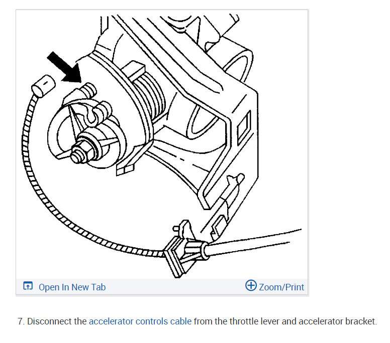

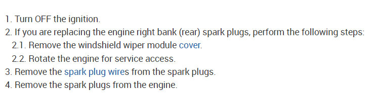

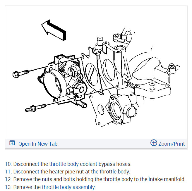

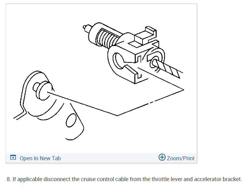

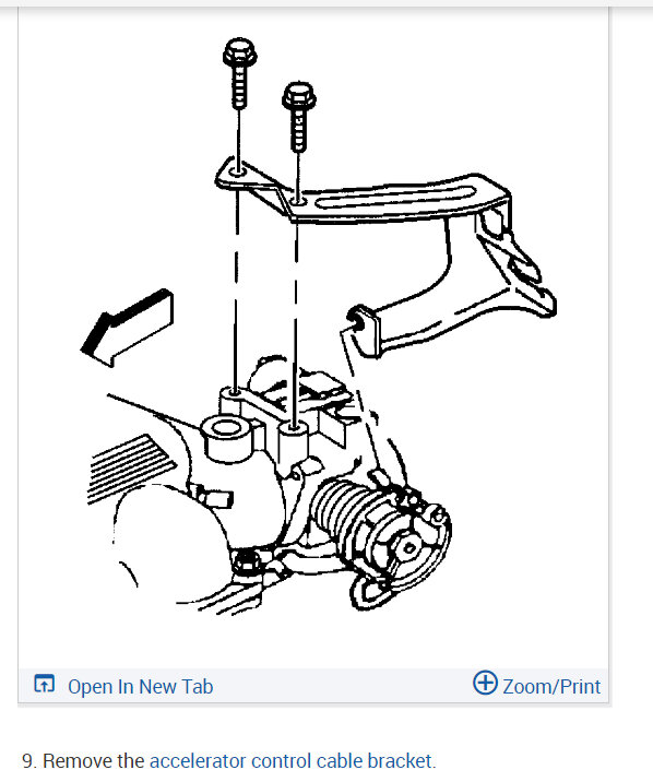

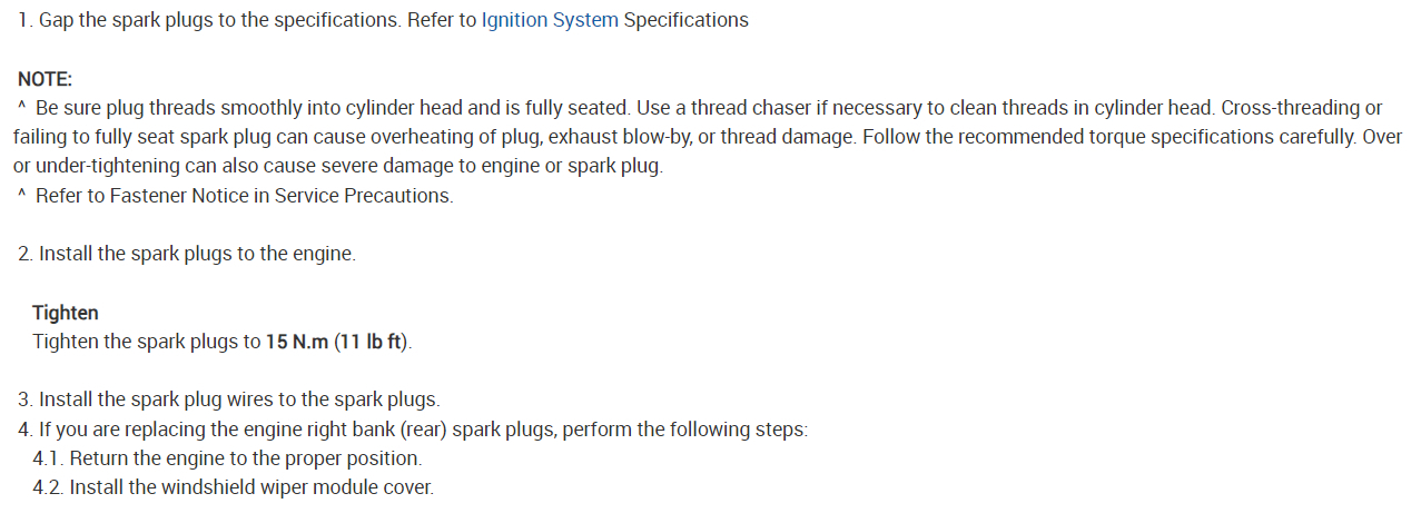

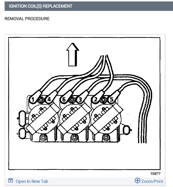

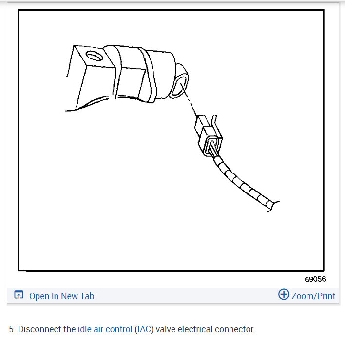

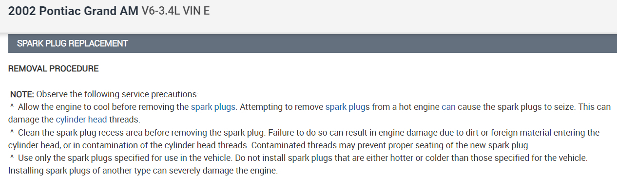

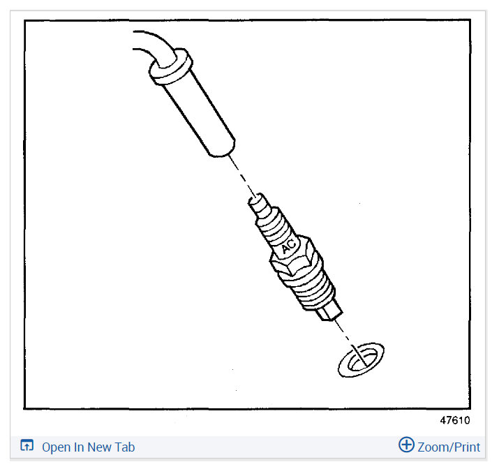

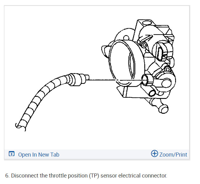

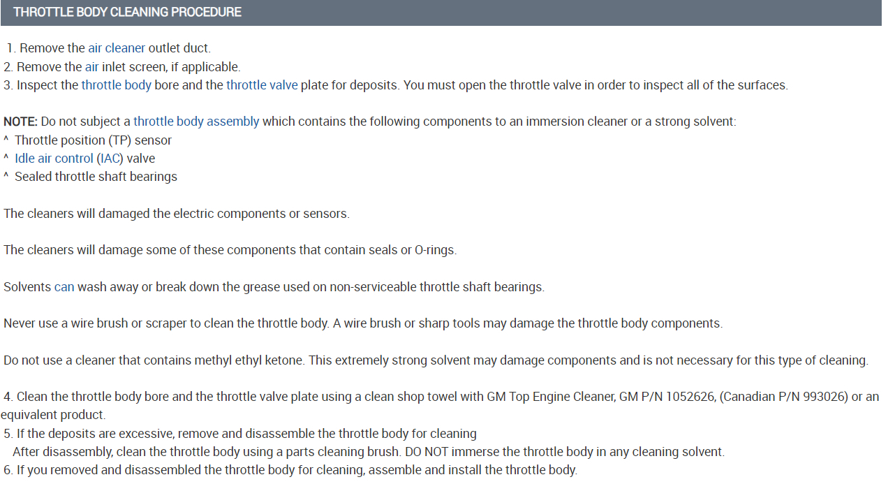

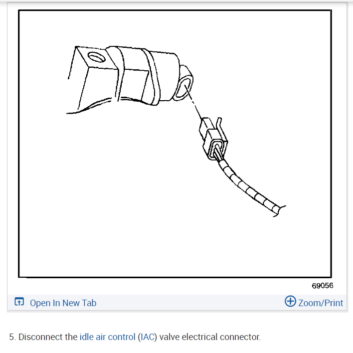

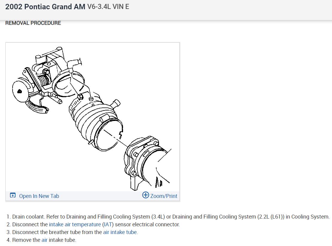

I would start with a tune up, new spark plugs and wires, also service the throttle bore and IAC. I have also seen the coil pack go bad, but I would start with the plugs and wires. This guide can help walk you through the service with instructions in the images below for your car:
https://www.2carpros.com/articles/how-to-tune-up-a-car-engine
and
Spark Plug .................... AC Type 41-940
1.52 mm (0.060 in)

The book is calling for a
This plug might have been superseded.
