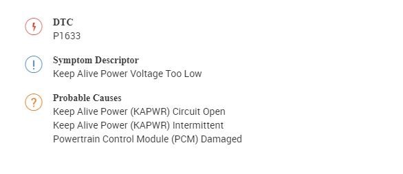

Is 1633 the only code?
This code is for the keep alive memory for the PCM. Make sure he checks all the fuses for power on both sides. This is not a visual test, it is a power test.
QB: DTCs P0603 or P1633: Keep Alive Power
QB: Introduction See: Computers and Control Systems > Pinpoint Tests > QB: DTCs P0603 or P1633: Keep Alive Power - Introduction
QB1 CHECK THE 12-VOLT BATTERY TERMINALS
Note:If KAPWR is interrupted to the PCM when a breakout box is installed or the battery is disconnected, DTC P0603/P1605 can be generated on the first power-up.
INSPECT the 12-volt battery cables for loose connections and for corrosion.
Are the 12-volt battery terminal connections in good condition?
Yes
KEY OFF.
GO to QB2
No
Repair any concerns found.
QB2 INSPECT THE ENGINE COMPARTMENT FOR PROPER WIRE ROUTING
INSPECT the Electronic Engine Control (EC) system wiring for proper wire routing.
Check the wiring routing to establish if any of the electrical connectors are being stressed due to poorly routed wiring. If necessary re-route the wiring and secure.
Visually inspect wiring and connectors.
Are there any wiring problems?
Yes
Repair as necessary.
No
GO to QB3
QB3 CHECK KEEP ALIVE POWER (KAPWR) TO THE PCM
PCM connector disconnected.
Measure the voltage between:
While observing the multimeter, grasp the Electronic EC harness and wiggle, shake or bend a small section while working from the battery to the PCM.
Is the voltage less than 10.5 V?
Yes
ISOLATE the fault and REPAIR as necessary.
No
GO to QB4
QB4 CHECK FOR A REPEAT OF THE DTC
PCM connector connected.
Clear all DTCs that may have been caused by the PCM disconnect.
Test drive the vehicle and allow the engine to reach normal operating temperature.
CHECK Self-Test DTCs:
Are DTCs P0603 or P1633 present?
Yes
INSTALL a new PCM.
REFER to Section 2, Flash Electrically Eraseable Programmable Read Only Memory - Flash EEPROM See: Computers and Control Systems > Programming and Relearning > Flash Electrically Eraseable Programmable Read Only Memory - Flash EEPROM
No
Unable to duplicate or identify the fault at this time.
REFER to Section 4, Diagnostic Trouble Code (DTC) Description for possible causes and additional DTC description information.
GO to Z1 See: Computers and Control Systems > Diagnostic Trouble Code Tests and Associated Procedures > Z: Intermittent - Pinpoint Test
