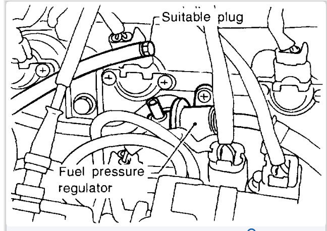

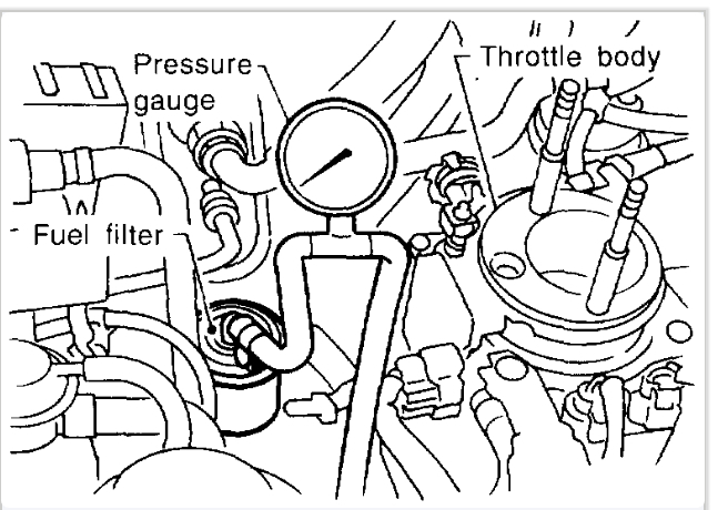

If the MAP shows the proper data the next step would be to verify fuel pressure. It should be 34psi minimum with the vacuum hose connected to the regulator and 43psi with the hose disconnected. Also check the hose to the pressure regulator and see if any fuel comes out of it. I've seen small tears in the diaphragm do this. You'll need to install the pressure gauge inline after the fuel filter. Be sure to plug the vacuum line to the regulator when testing. I'll post pictures below showing gauge set up and regulator location.
