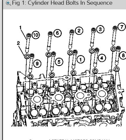

Start with misfire on number three cylinder. I have changed the plugs and plug-leads and coil-pack. combustion chamber stays black and spark plug, if take off cylinder head, but valves is white.
