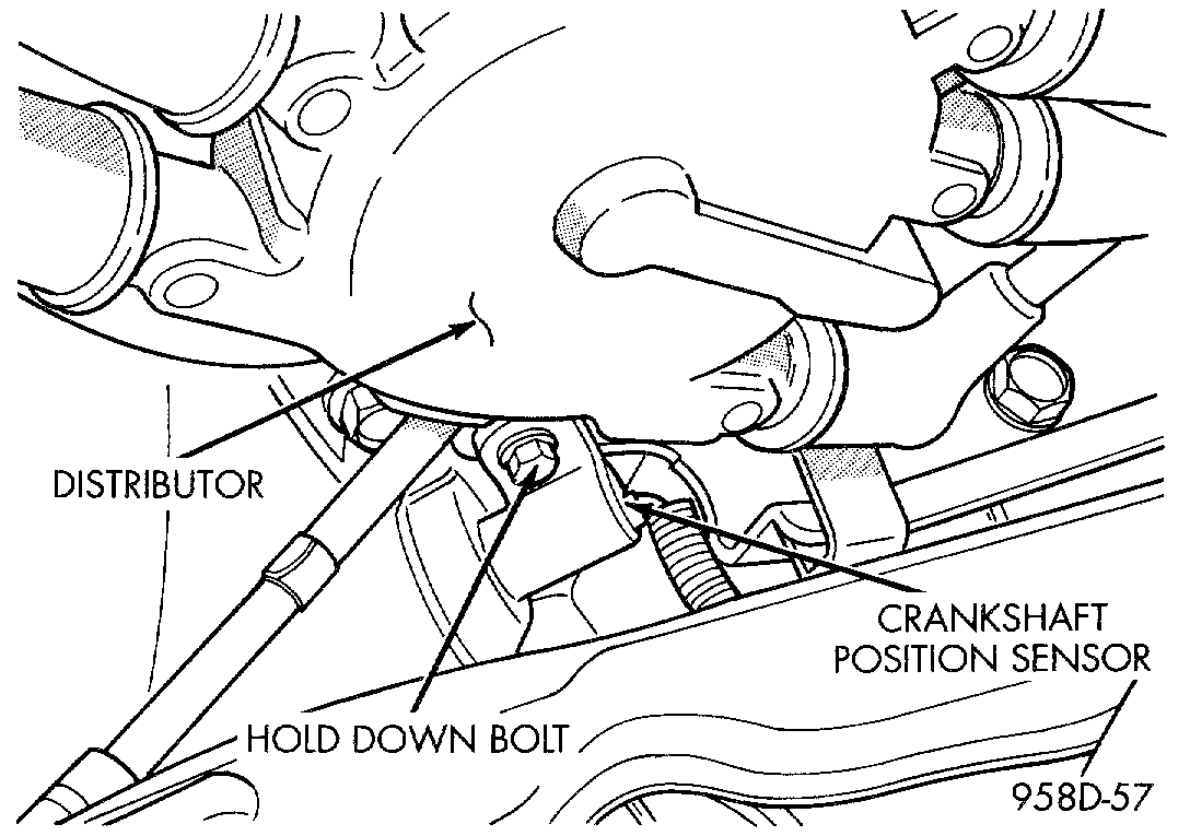

What you described sounds like a bad crankshaft position sensor. When they start to fail, heat will have an adverse affect on them. Take a look through these two links. The first one describes the sensor and the second describes common symptoms.
https://www.2carpros.com/articles/how-a-crank-shaft-angle-sensor-works
Let me know if the symptoms described in the link mirror what you experience. The sensor on this vehicle is located on the transmission bell housing, so I will give you directions for replacement if you want to give it a shot.
I did attach a pic of the sensor.

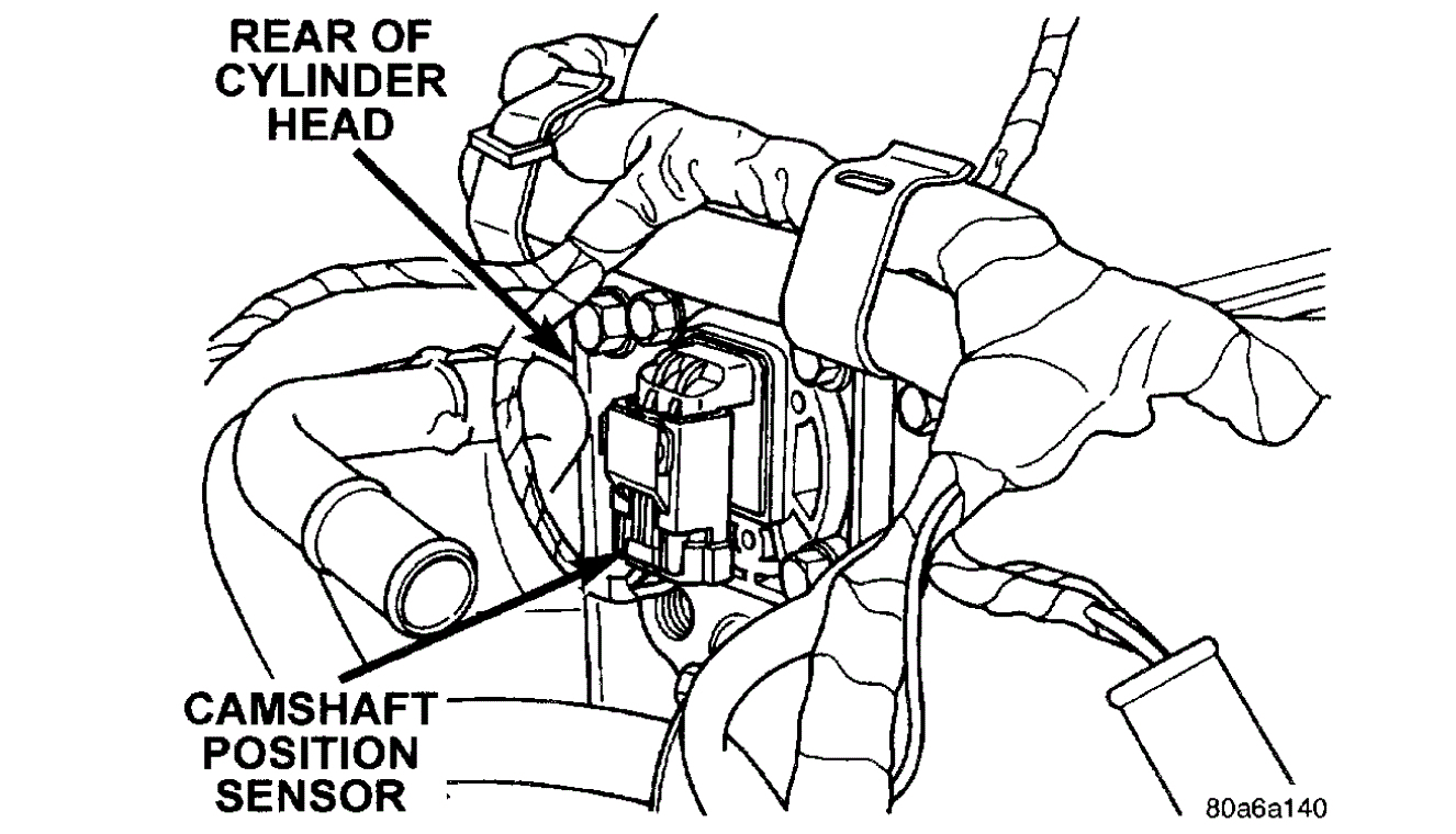

Is there any chance the cam sensor(s) could be causing this? P1391 refers to both (cam and crank) is the main reason I ask, and the fact that I replaced the distributor which is where the cam sensor is located.
Bottom line I need to get it scoped after it gets heated up and mimics symptoms. Take the guessing out of it. Appreciate your input. Wilson
Aug 3, 2020 at 12:27 AM
Absolutely it can. The PCM determines fuel injection synchronization and cylinder identification from inputs provided by the camshaft position sensor and crankshaft position sensor. If one is failing, things will be off time.

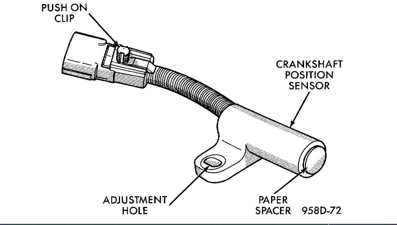

1. Does the flywheel (flex-plate) need to be in a certain position before installing new sensor in order to ensure proper gap?
2. Something is telling me that once the motor heats up, it expands and that expansion distorts the gap which affects sensor's performance (misfires).
3. I lightly glued (Elmer's paste stick) .030 paper onto end to create the gap. Is there a better way to create this gap?

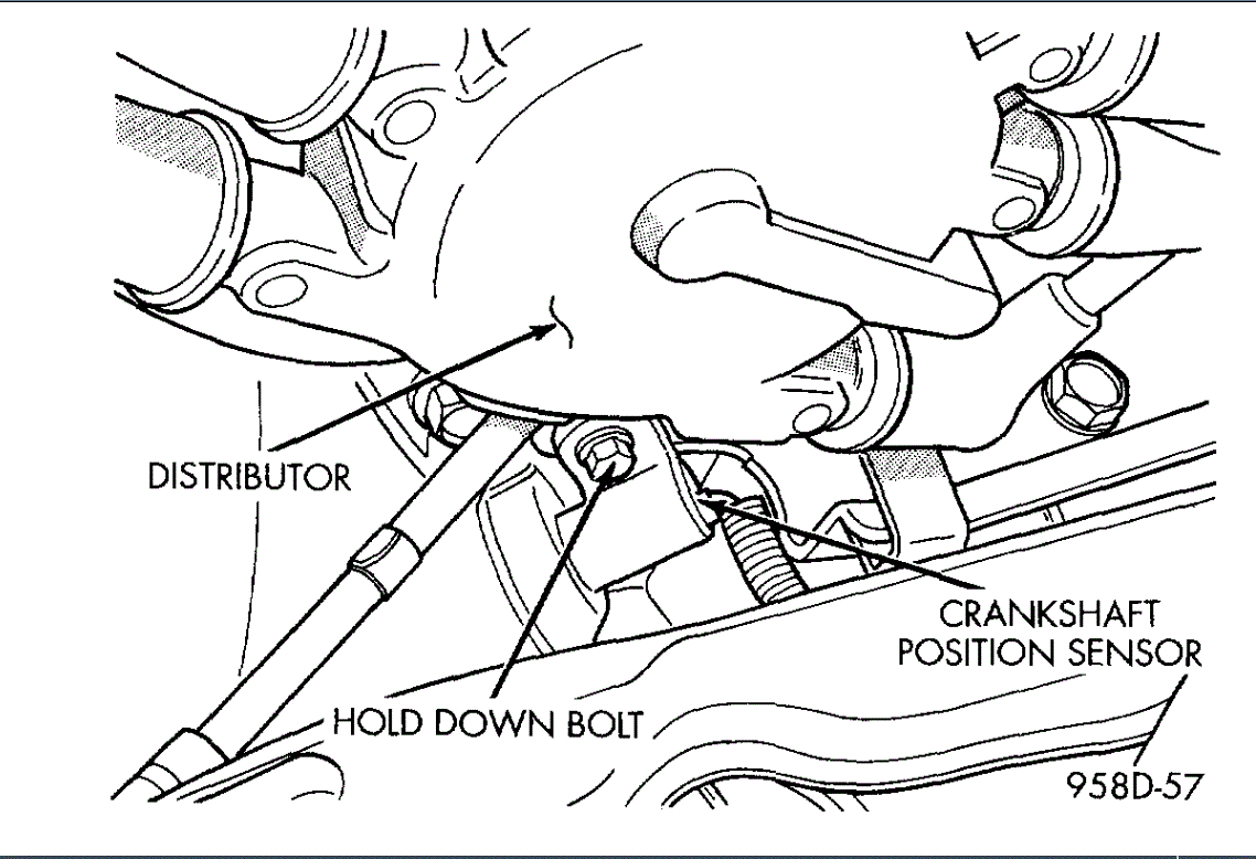

I know there is a paper spacer. Is that installed? Here are the directions from alldata. See if there is anything you are missing.
1999 Dodge Stratus V6-2.5L VIN H
Procedures
Vehicle Powertrain Management Sensors and Switches - Powertrain Management Sensors and Switches - Computers and Control Systems Crankshaft Position Sensor Service and Repair Procedures
PROCEDURES
pic 1
REMOVAL
1. Remove speed control servo from driver's side strut tower.
2. Remove crankshaft position sensor retaining bolt.
3. Pull crankshaft position sensor straight up out of the transaxle housing.
4. (Disconnect crankshaft position sensor electrical connector from the wiring harness connector.
INSTALLATION-ADJUSTABLE
All vehicles will be equipped with an adjustable crankshaft position sensor. This can be identified by an elongated mounting hole in the sensor.
Crankshaft Position Sensor And Spacer
pic 2
NOTE: If the removed sensor is to be reinstalled, clean oft the old spacer on the sensor face. A NEW SPACER must be attached to the sensor face before installation. If the sensor is being replaced, confirm that the paper spacer is attached to the face of the new sensor.
1. Install sensor in transaxle and push sensor down until contact is made with the drive plate. While holding the sensor in this position, install and tighten the retaining bolt to 12 N.m (105 in. lbs.) torque.
2. Connect crankshaft position sensor electrical connector to the wiring harness connector.
3. Attach connector to heater tube bracket.
4. Install speed control servo. Tighten nuts to 9 N.m (80 in. lbs.) torque.
If you did everything as described, I need you to get your hands on a live data scan tool. I need to know fuel trims when this is happening and I need the engine coolant temp sensor (ECT) reading when it's happening.
