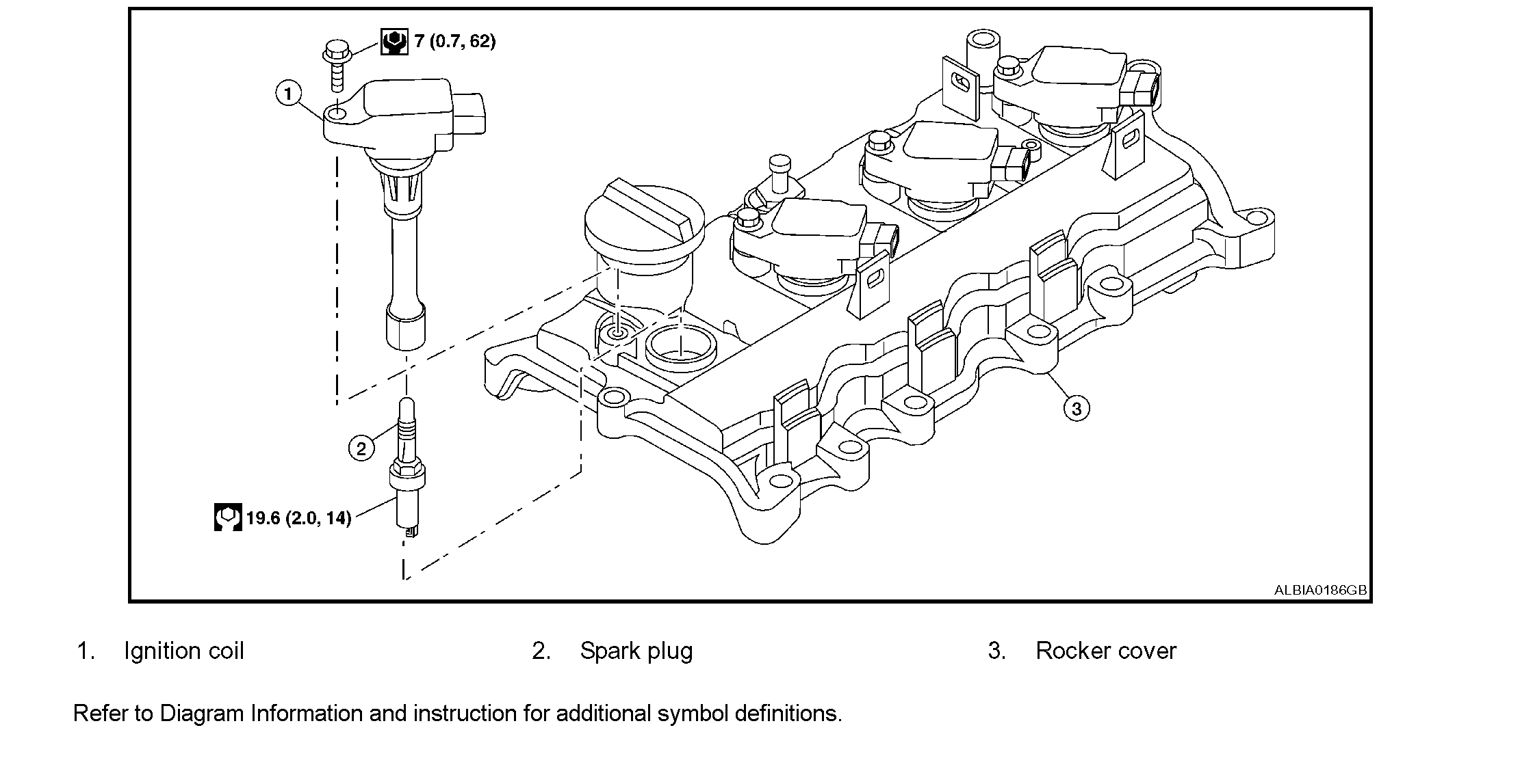

Here are the directions specific to your vehicle for spark plug replacement:
2007 Nissan-Datsun Altima L4-2.5L (QR25DE)
Removal and Replacement
Vehicle Powertrain Management Ignition System Spark Plug Service and Repair Removal and Replacement
REMOVAL AND REPLACEMENT
SPARK PLUG
Removal and Installation

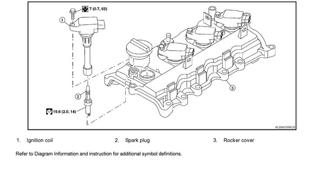

Exploded View EM-14
pic 1
REMOVAL
1. Remove the ignition coil.
pic 2

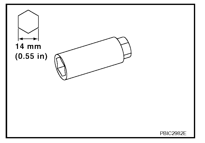

2. Remove the spark plug with a suitable spark plug wrench.

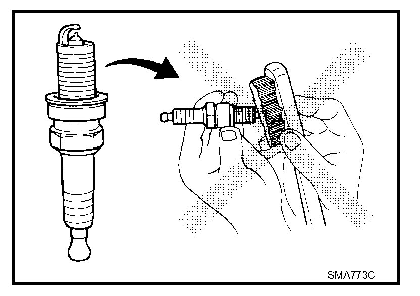

INSPECTION AFTER REMOVAL
pic 3
^ Do not use a wire brush for cleaning the spark plugs. Replace as necessary.
^ If plug is covered with carbon, a spark plug cleaner may be used.
Cleaner air pressure: less than 588 kPa (6 kg/cm2, 85 psi)
Cleaning time: less than 20 seconds
pic 4

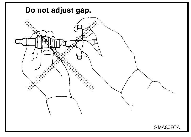

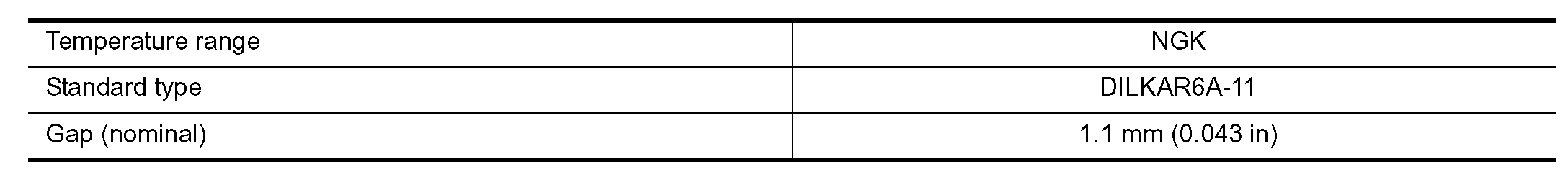

^ Checking and adjusting plug gap is not required between change intervals. If the gap is out of specification, replace the spark plug.
Gap (nominal): 1.1 mm (0.043 in)

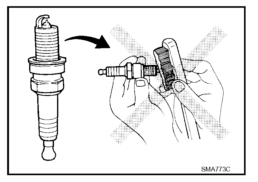

INSTALLATION
Installation is in the reverse order of removal.
