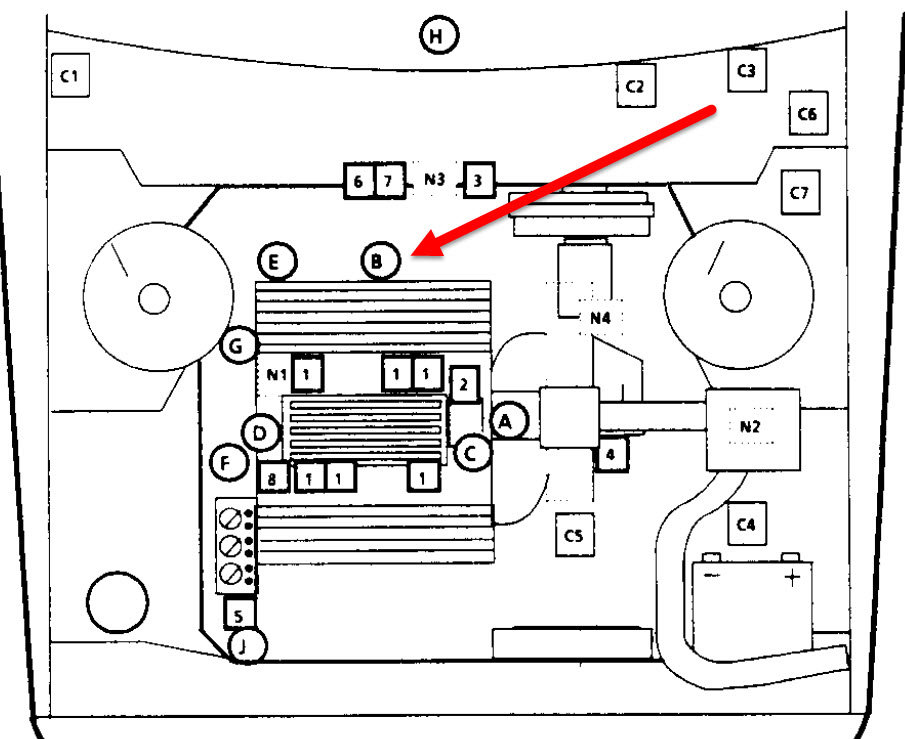

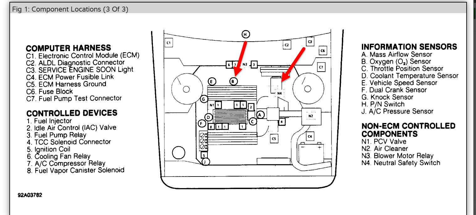

in my first reply I stated what the fuel pressure should be if not at minimum you have a bad fuel pump. code 13 is O2 sensor item b in pic and other is neutral switch item N4 in pic those are what your two codes are saying is wrong with car as well as you have a bad fuel pump. pump pressure should be checked with key on only.
