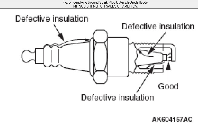

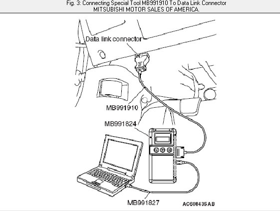

we have many things that can make misfire,ignition coil,spark plug and wires,injector,and engine compression.first read the fault codes to know which cylinder is misfiring.check the spark plug condition if not appear visually defect as in fig 2 then swap to another cylinder then recheck.
