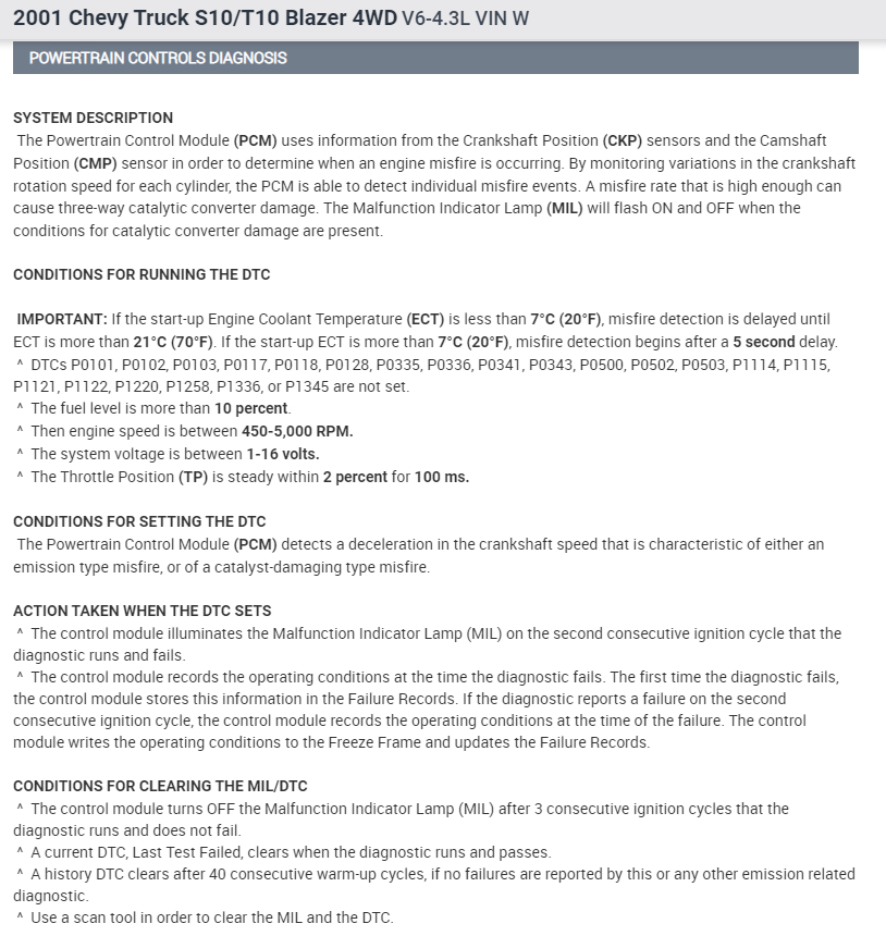

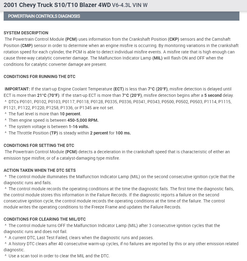

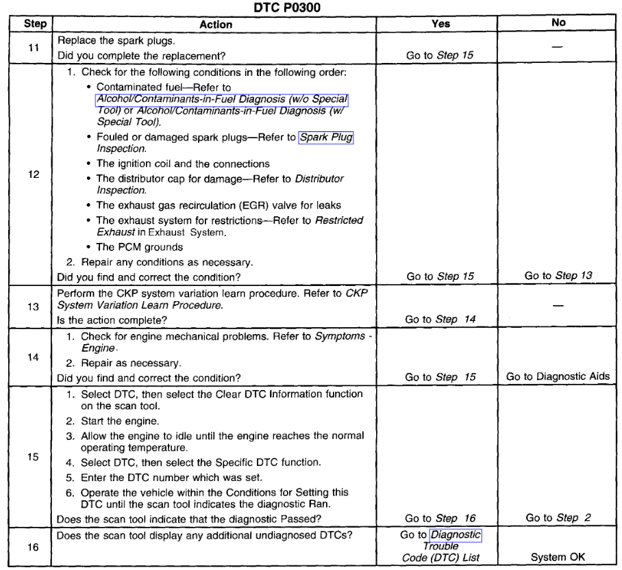

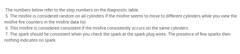

The P0300 can also get triggered due to faulty injectors among other things.
Take a look at this helpful guide:
https://www.2carpros.com/articles/engine-misfires-or-runs-rough

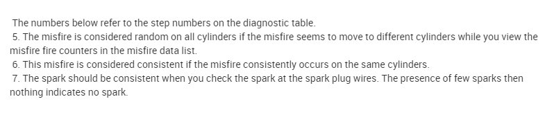

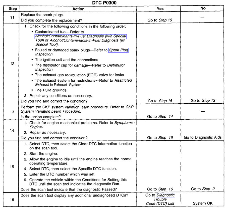

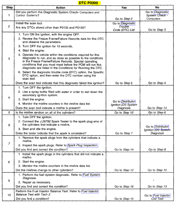

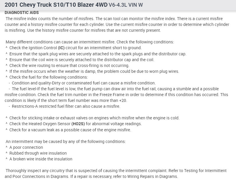

I have attached the troubleshooting guide for the code P0300 below.
Follow those steps as it can help you determine the issue.
Let me know of any questions.
