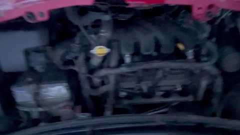

The symptoms started after a collision, but I don't think they are related because it wasn't a big hit. Damage was limited to the passenger side with the headlight busted out and the hood pushed back along with the hood mount bracket.
The issues started with the vehicle stalling a couple of times, while driving it at lower speeds. The following error codes popped up.

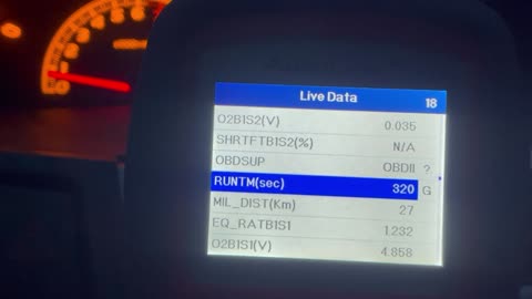

MAF - ODB live data looks ok. I tested by checking the value at idle and then doubling the revs and the sensor showed double value. I also cleaned it with MAF cleaner
Air filter, plugs and coils have been replaced
O2 sensor appears to be OK based on the live data
