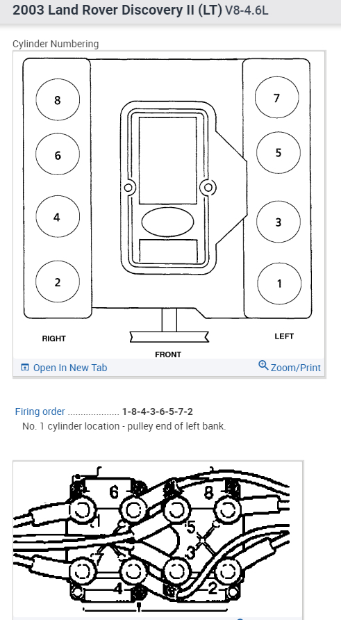

We changed the injectors, fuel pump, spark plugs and high-tension cables, still it's misfiring. kindly asking for the coil pack firing order.

I have attached the coil pack firing order along with the cylinder locations.
Thank you.
https://www.2carpros.com/articles/engine-misfires-or-runs-rough
Apr 15, 2022 at 8:03 AM
EMMANUELNGANDU
  • 29 POSTS

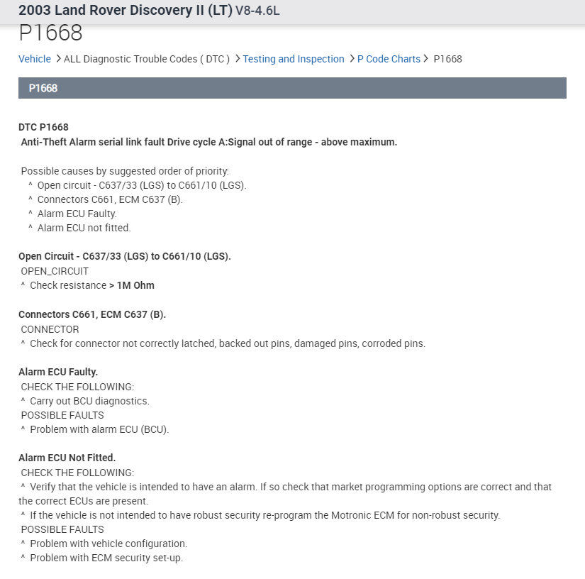

Thanks, I followed the firing order you gave me it performed better than before, now it's showing a p1668 code.
Apr 16, 2022 at 2:14 PM
SQM
  • 6,383 POSTS
The P1668 is an anti theft code, typically gets triggered due to an issue with the alarm.
I have attached some helpful info on the code below for your reference.
