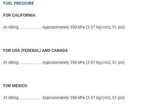

Misfiring cylinder 4, changed all spark plugs, cylinder 4 ignition coil. Started running perfect, started misfiring again cylinder 4 so swapped out spark plug and ignition coil with cylinder 1 still the same. Nissan computer through codes P0301 and P0304. Checked all spark plugs and ignition coils all were good. Any advice would be appreciated. Thank you.
