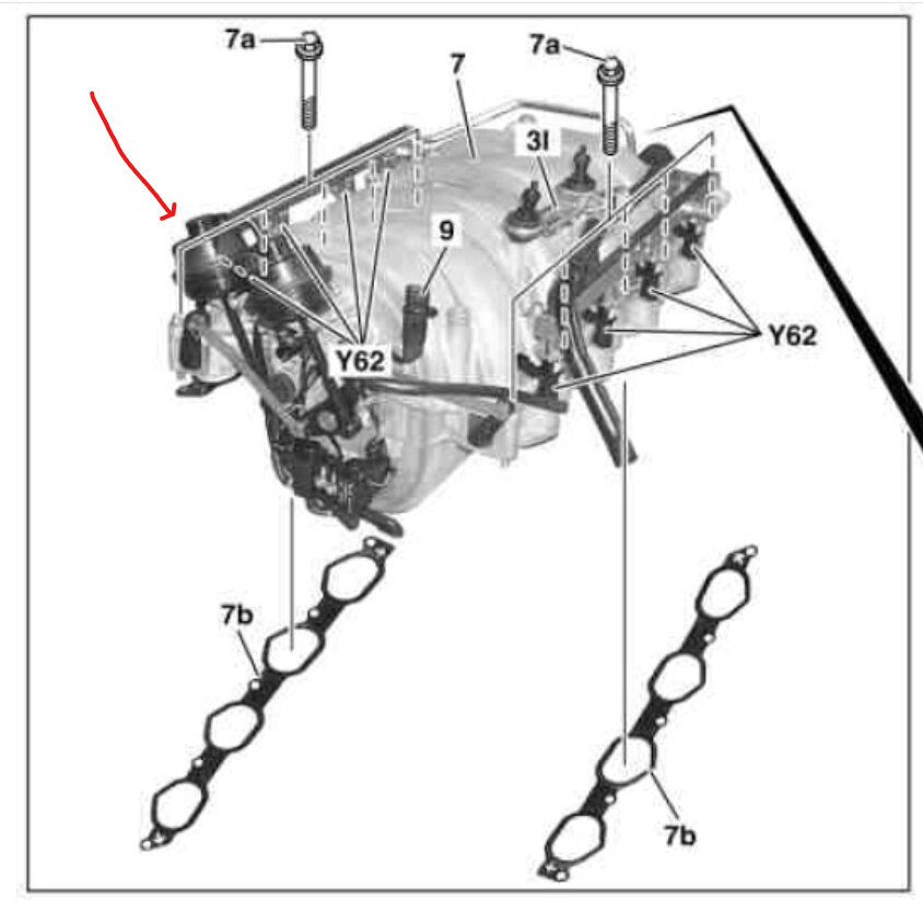

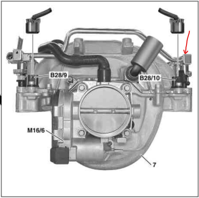

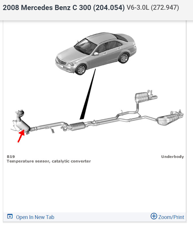

This happens when the catalytic converter starts to clog up, or there is a problem with the intake port shut off motor. I would remove them for inspection. Here is the location so you can see what needs to be done to help fix the problem. Check out the images (below). Please upload pictures or videos in your response to the problem so we can see what's going on.
