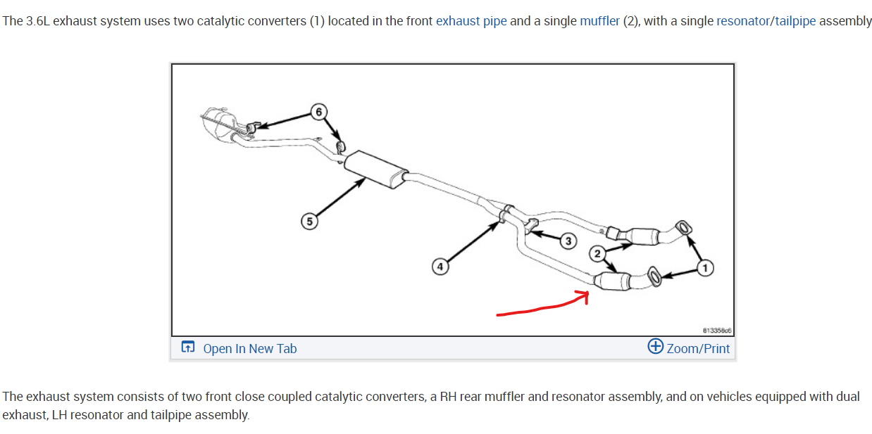

When there is a bank of misfires it is not the spark plugs, coils or injectors. The problem will be the swirl valve control, or you have a clogged catalytic converter on that side. Since your car does not have swirl valve inside the intake it just leaves the catalytic converter. Here is the location of the cat in question, check out the images (below). Please let us know what happens.

So, how would I be able to get the cat unclogged on that side?

You will need to replace it, usually the catalytic material falls apart and blocks the outlet. I don't think cat clean will work.
