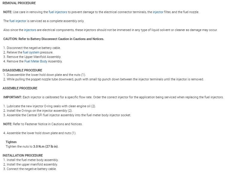

Diagram/instructions for replacement are attached below
