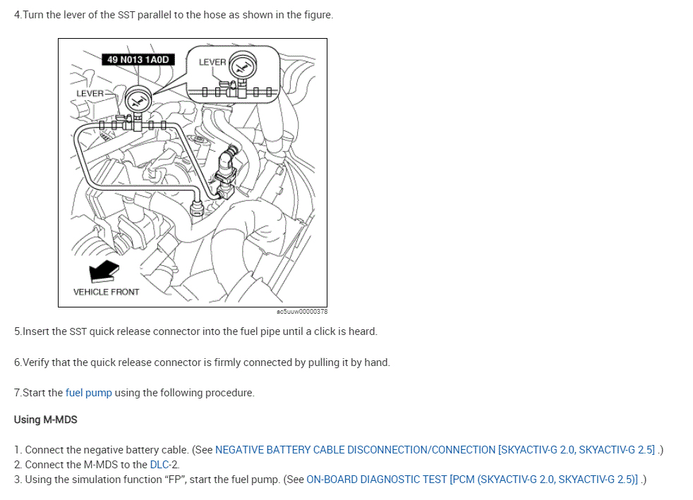

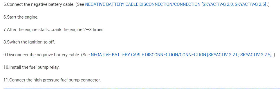

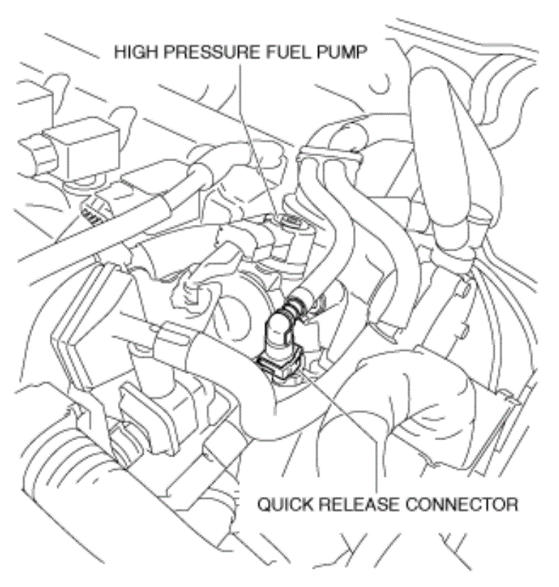

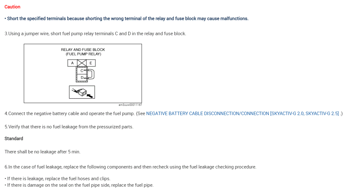

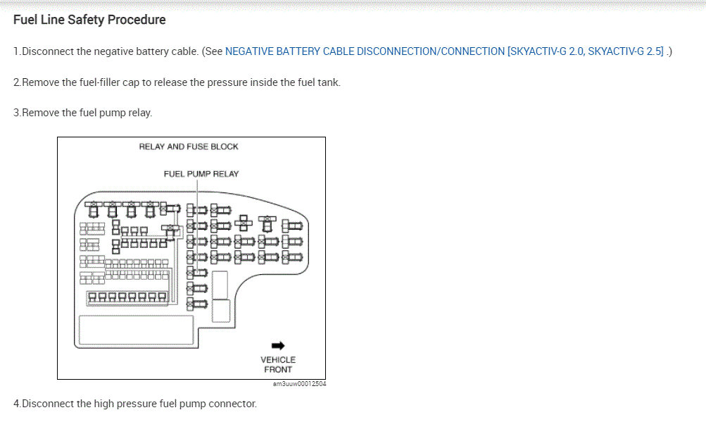

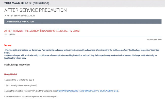

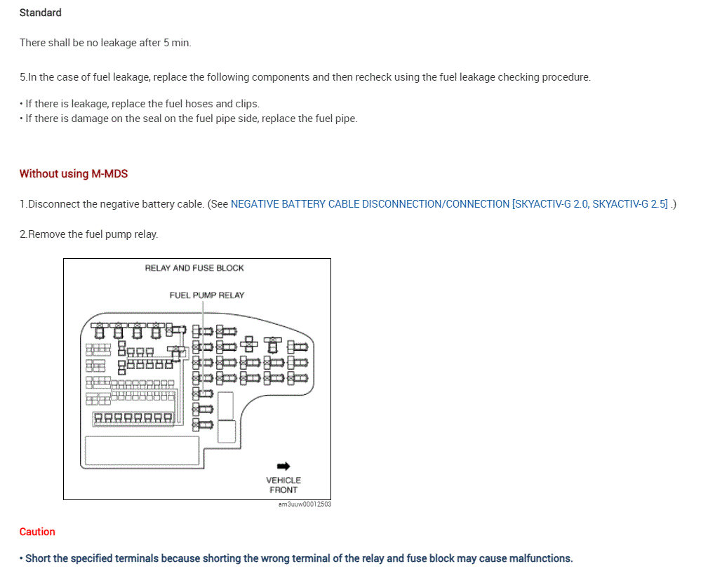

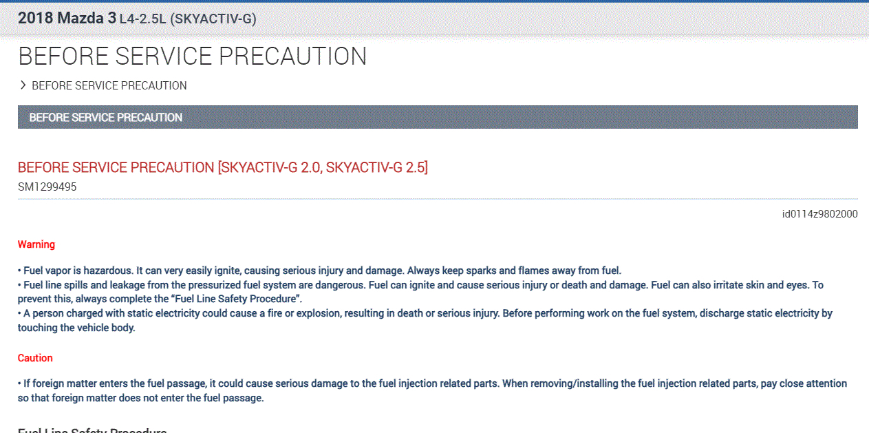

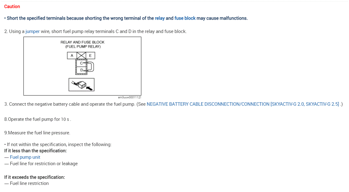

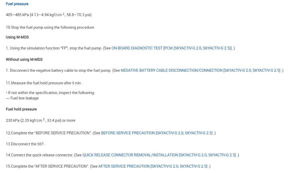

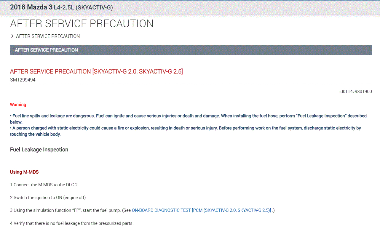

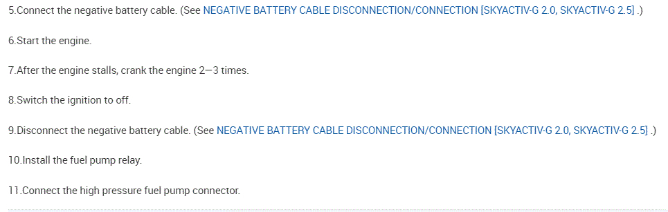

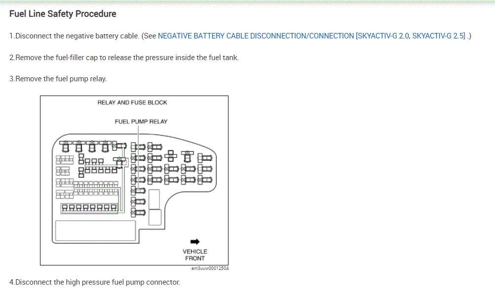

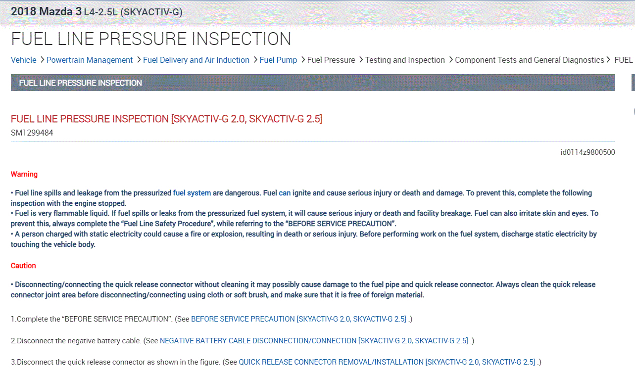

Do me a favor. Take a rubber mallet and tap on the exhaust system to see if you can reproduce the rattle you hear. If you do, note where it is coming from and let me know.

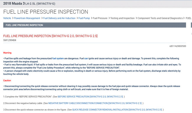

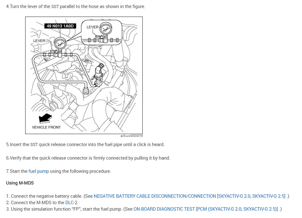

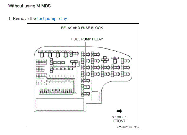

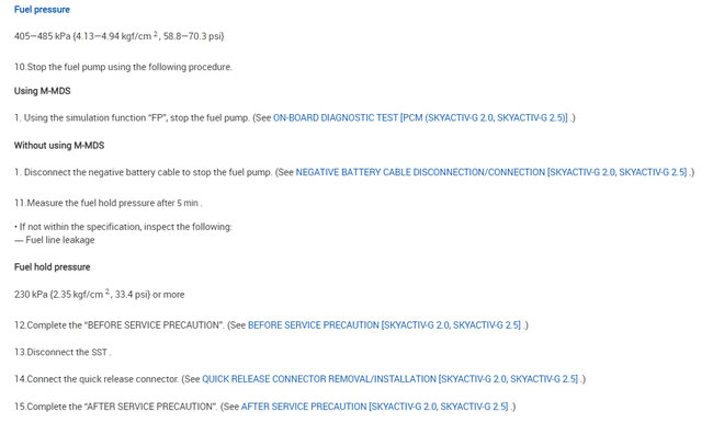

As far as the fuel pressure is concerned, here is a link that explains how it is done:
You will need a fuel pressure gauge, but most parts stores will lend one to you.

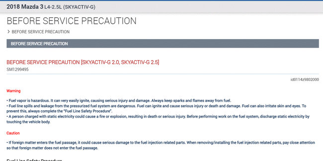

The pics I attached below are the directions specific to this vehicle. I included both the preservice precautions and after-service precautions. The manufacturer's fuel pressure specifications are included in the directions.
See pics below.

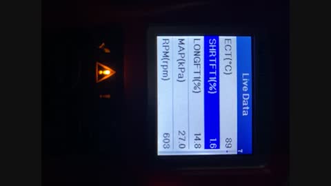

Absolutely too much or little fuel pressure can cause this. By any chance, do you have a live data scan tool? If you do, can you let me know what the short-term fuel trims are?
Apr 15, 2022 at 8:28 PM
KAYVA
  • 18 POSTS
Hi Joe,
They seem to oscillate between -6 (negative) to 4 (positive). The car is parked when the numbers were read. When I do city driving the extremes are larger. I inserted a video below with car in park.
Thank you,
Kayvan
Apr 15, 2022 at 10:02 PM
Okay, this doesn't add up. It indicates a lean condition, but watching the STFT, they appear normal. In a perfect world, you want them at 0%. However, between -10% and +10% is considered normal.
When the scan tool was providing live data, was the engine running rough?
Apr 16, 2022 at 4:44 PM

Hello Joe,
The engine was not running rough. What if it ranges -17 to 12 a few times when I’m driving the car?
Thank you,
Kayvan
Apr 16, 2022 at 5:14 PM
That would be normal under a load. I need the STFT when it is running rough. That will let me know if the cause is related to a fuel ratio issue.
I realize that may not be easy to do. LOL If possible, try to get it and let me know what you find.

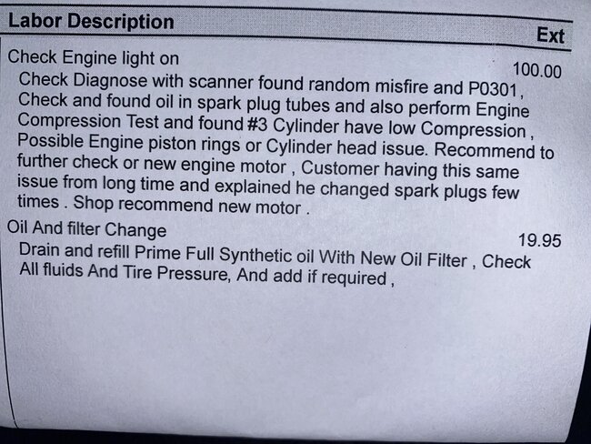

It’s been a long time since our last email, hope everything is fine. I have an update for you, in short, the motor needs to be replaced, it’s wearing out. I inserted a picture of the comments from the mechanic.

Thank you for the update. By any chance, did he provide the compression readings? Also, the P0301 is likely because oil got into the spark plug tube. If cylinder 3 compression is low, I would have expected a P0303 as well.
If you do have the compression readings, let me know.
It's nice to hear from you. I hope you have a great Christmas and holiday season.
Dec 17, 2022 at 10:42 PM
KAYVA
  • 18 POSTS
Yes, he told me cylinder 3 is 30 % lower, and the others are a bit off as well. And yes, there is oil getting onto the spark plugs. I hope you have a good holiday as well.
