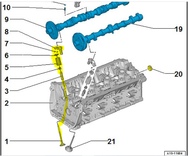

Did a smoke test nothing, changed plugs and coils as it was misfiring on all, now just cylinder 4 is. Compression is zero, all the rest are 120 PSI. Top of all cylinders look the same with scope, cylinder 4 a bit more wet. What are the chances a valve is bent rather than a piston ring issue? Starts from the first time, does not smoke or overheats. No other codes.
