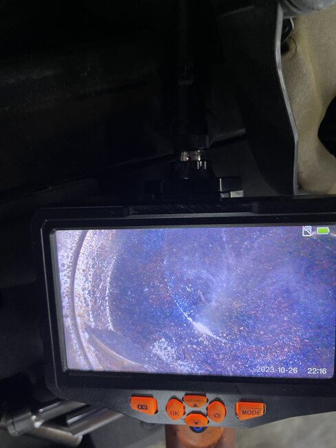

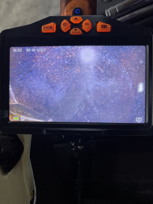

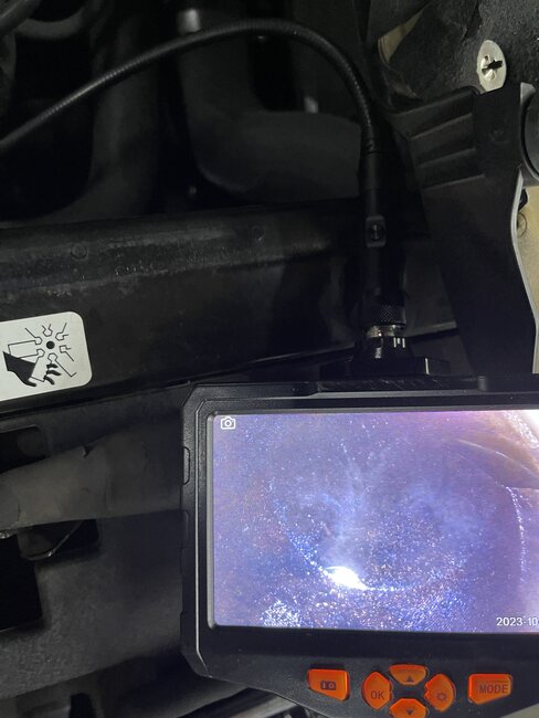

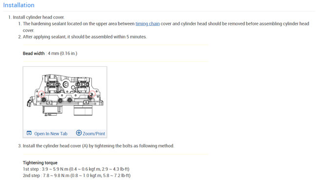

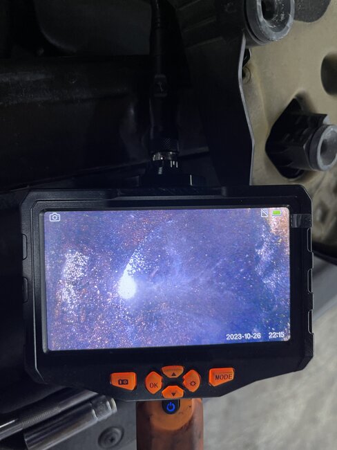

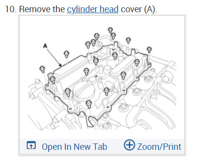

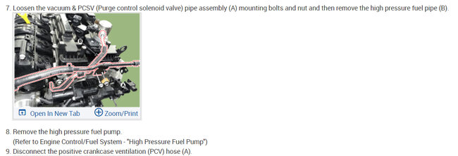

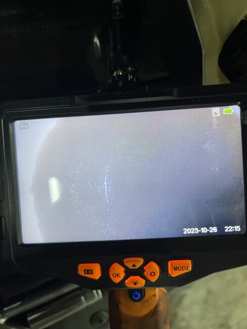

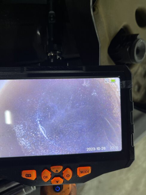

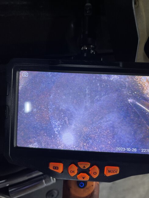

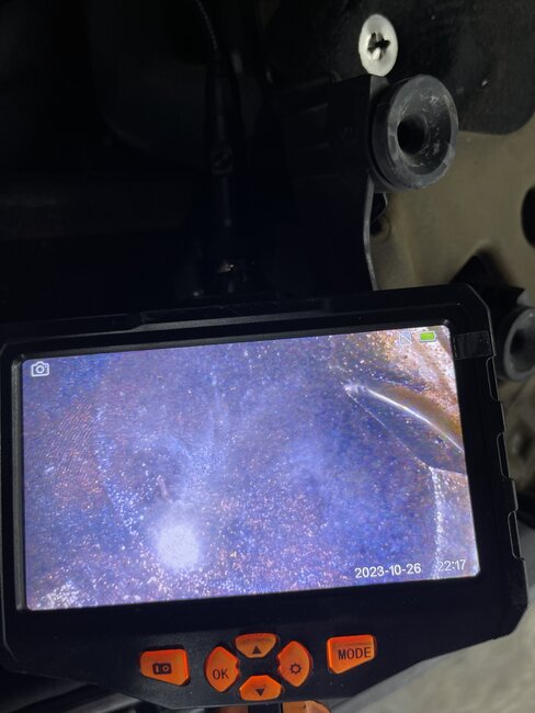

Super clean car with a 2.0T engine. Bought it cheap as it misfires on cylinder 3. Swapped coil and spark plug, same results. Only code is misfire on cylinder 3. Checked compression and its zero, cylinder 2 had 120 PSI. Ugh, do these usually have issues with pistons or valves? Recommend removing valve cover to see? I took some pictures using the camera, maybe you can see something. The plug had a lot of fuel on it.
