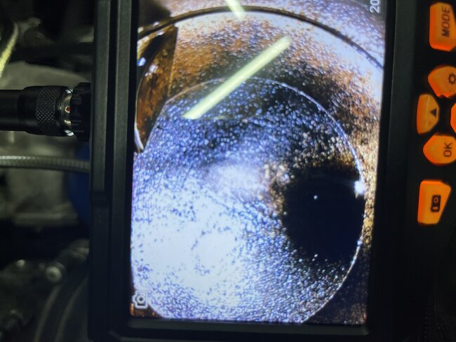

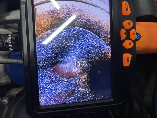

That is correct. You can perform a wet compression test which indicates if it is a ring issue. However, at 30 psi, I didn't feel the rings were the issue. That's why I didn't recommend it.

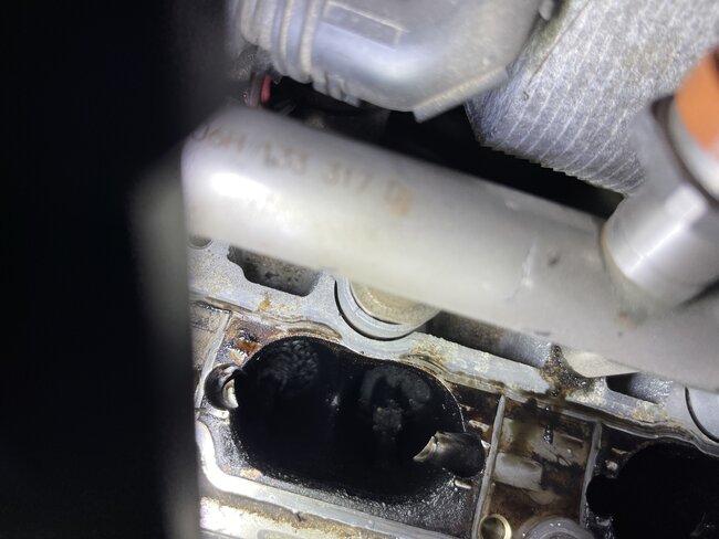

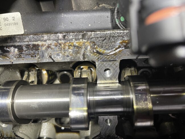

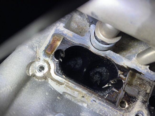

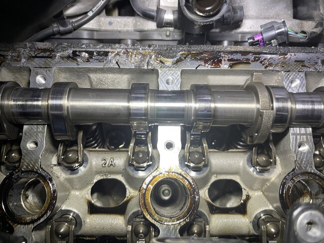

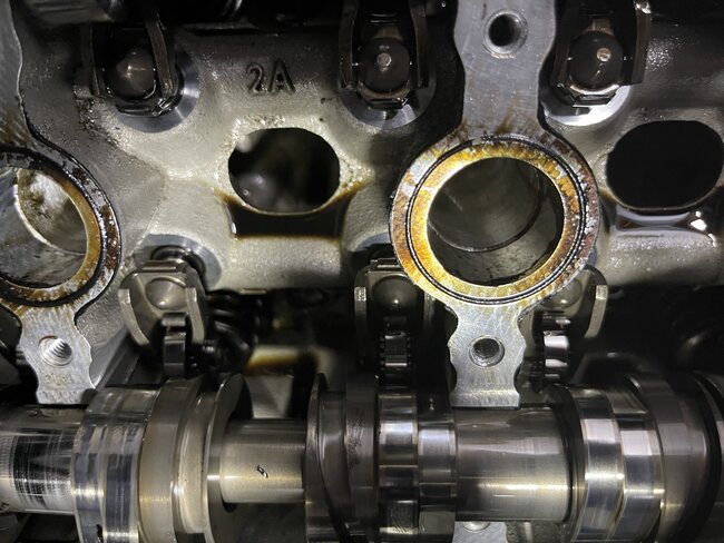

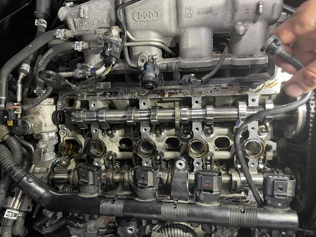

At this point, the only thing we can do is remove the valve cover to see if there is anything that obviously stands out. If you still have 30 psi, a valve would have to be nearly closed because if was excessively open, you would have 0 compression. Also, there is a chance (slim) that the head gasket has failed.
Also, although you don't feel the misfire at a higher RPM is simply because of the engine speed. At 30 psi, the misfire is still there. It just can't be noticed.
Let me know your thoughts or if you have other questions.
