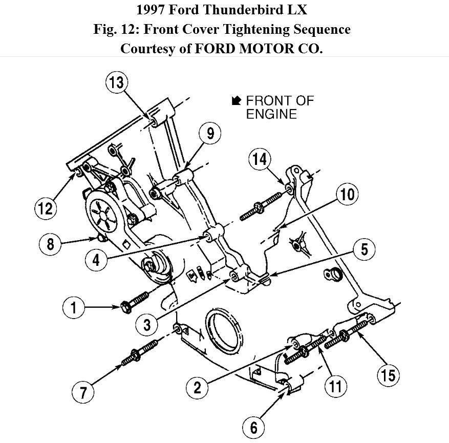

How would I check that out? the manual talks about voiding the A/C system and removing the compressor yada yada!
Jun 13, 2013 at 11:29 AM
KHLOW2008
  • 41,814 POSTS
Yup, not an easy job. The front cover has to be removed to gain access to the cranksensor pulse wheel, which would mean a host of components to remove..
