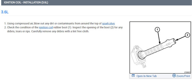

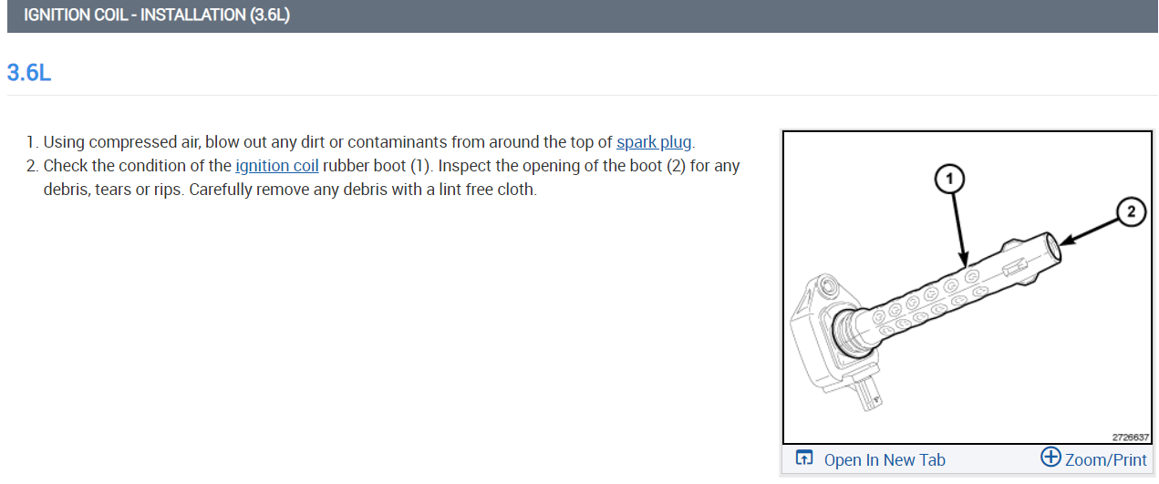

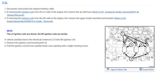

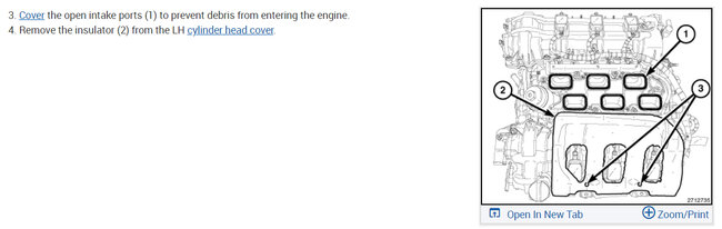

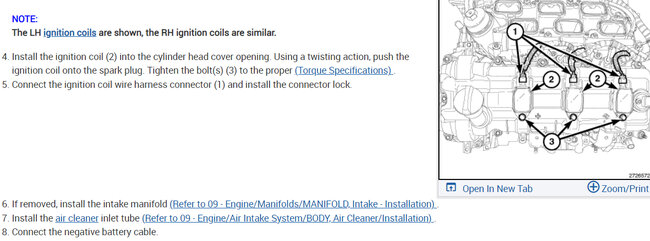

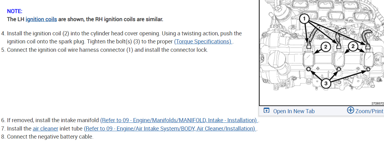

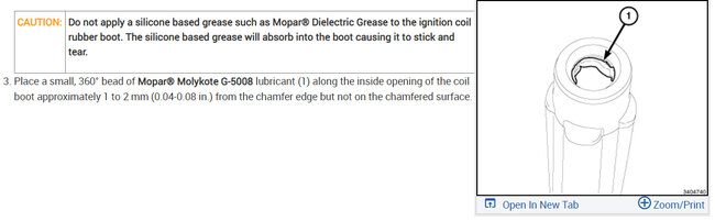

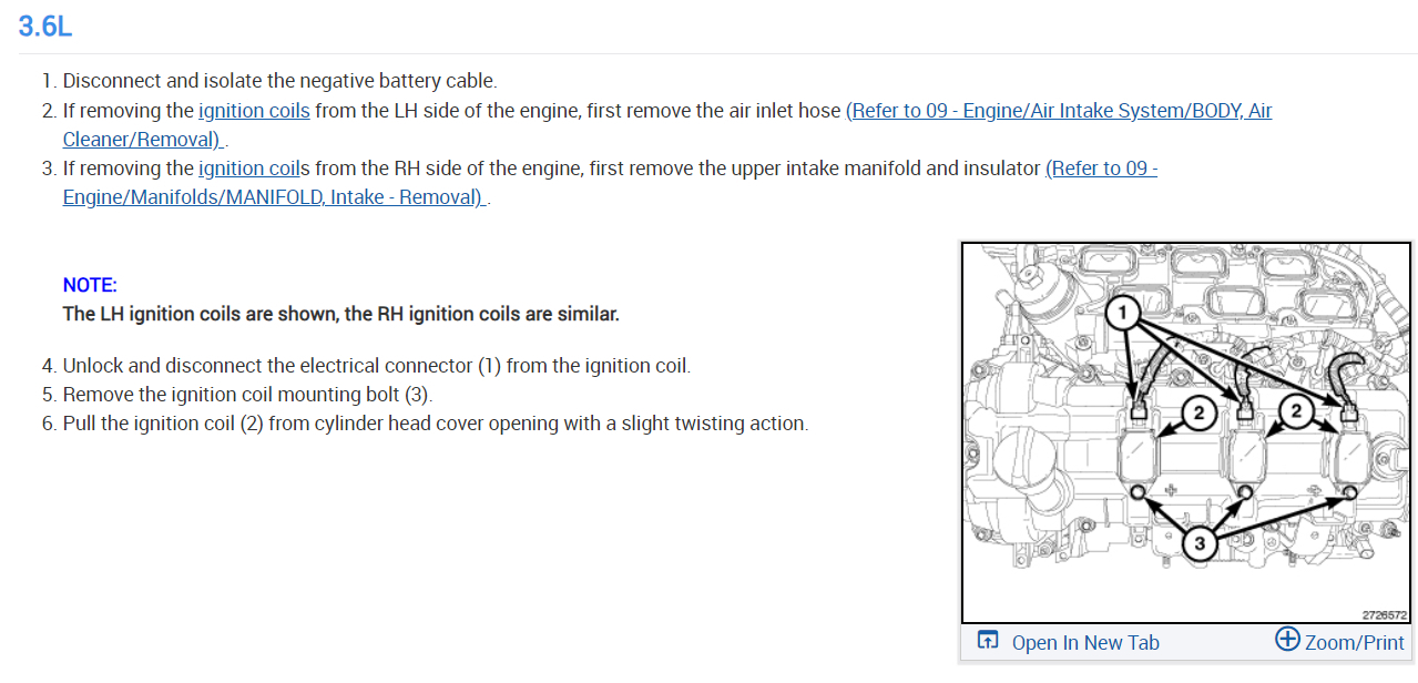

I would test the ignition coil which can go out, here is a guide to help you and how to change out the ignition coil as well:
https://www.2carpros.com/articles/how-to-check-for-ignition-spark
and
https://youtu.be/baq_aEWNQ0Y?si=qSRwJwUDVoHnXPHq
Here is a guide to help with the problem as well:
https://www.2carpros.com/articles/engine-misfires-or-runs-rough
Can I ask how the engine sounds when running, is there a ticking sound? If so, can you upload a short video of the noise so I can hear it, you may have a roller follower that has gone bad. Check out the images (below). Let us know how it goes.

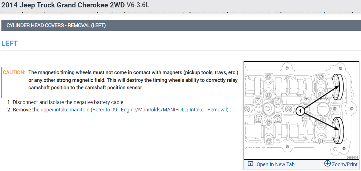

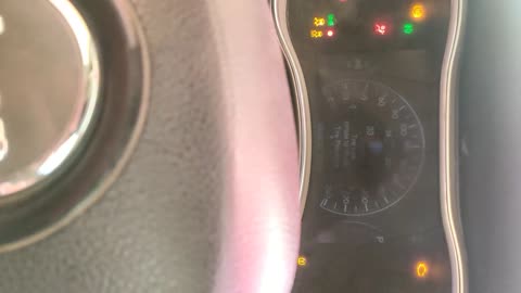

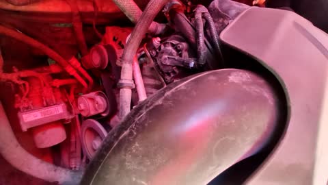

Thank you, Sir, for your response. This a video from inside and outside car, there is a little sound of ticking especially when idle. i noticed something yesterday the light inside the car when turn on at idle have little fluctuation otherwise the car performance is good at all.
Dec 1, 2023 at 4:25 AM

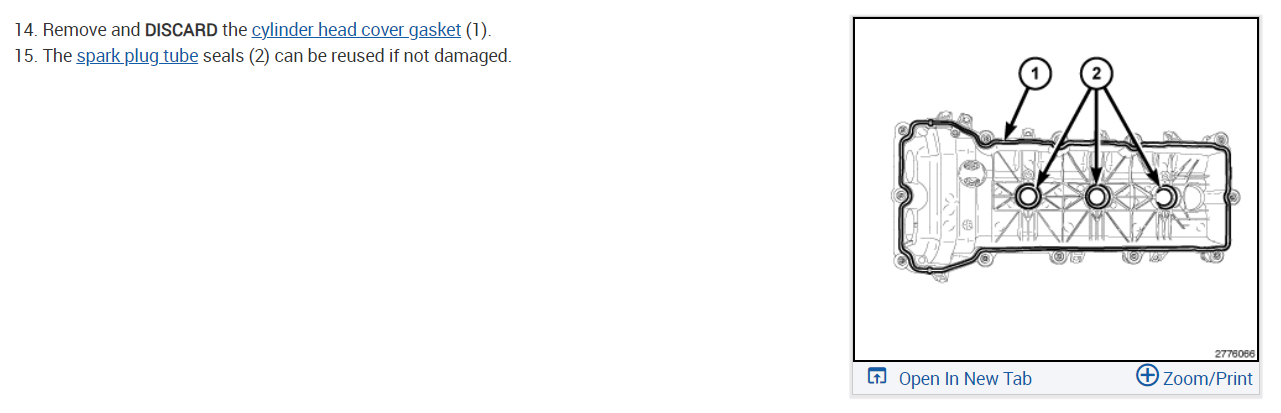

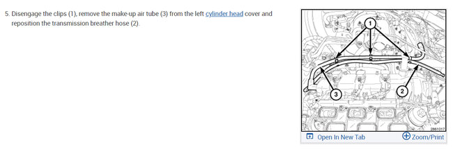

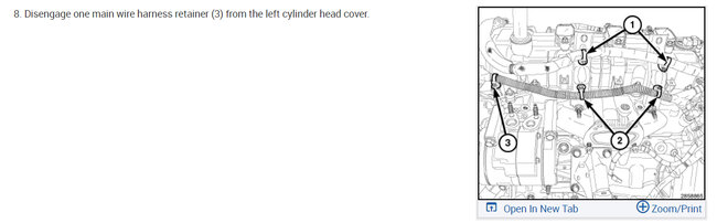

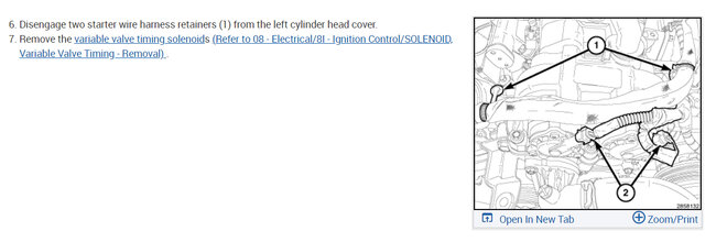

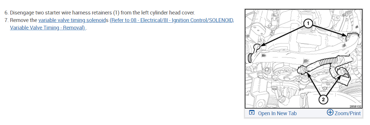

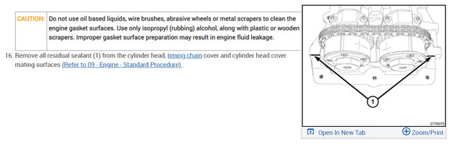

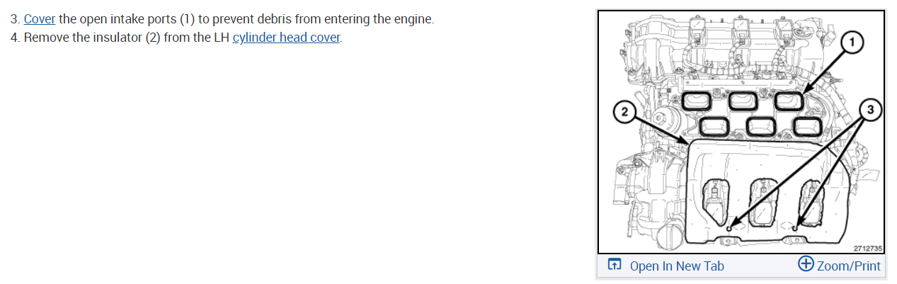

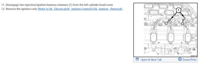

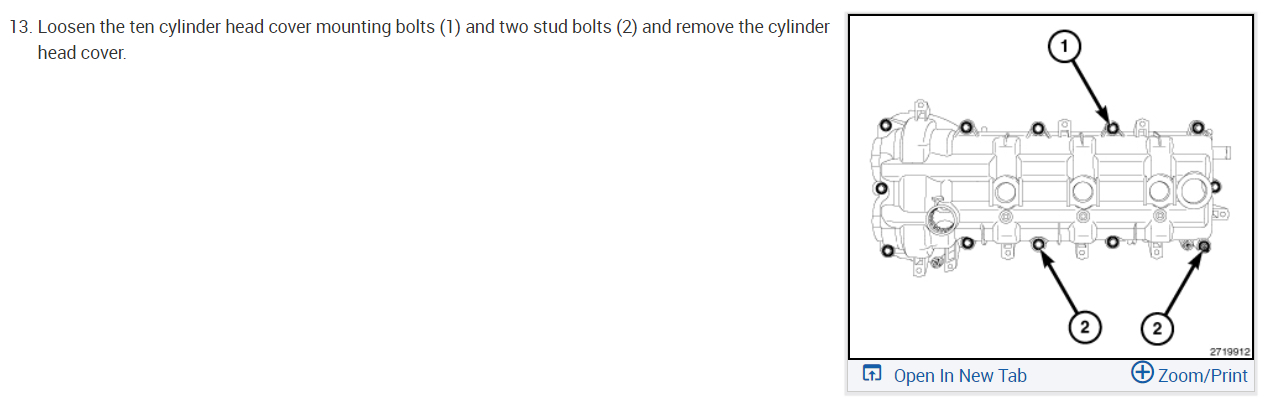

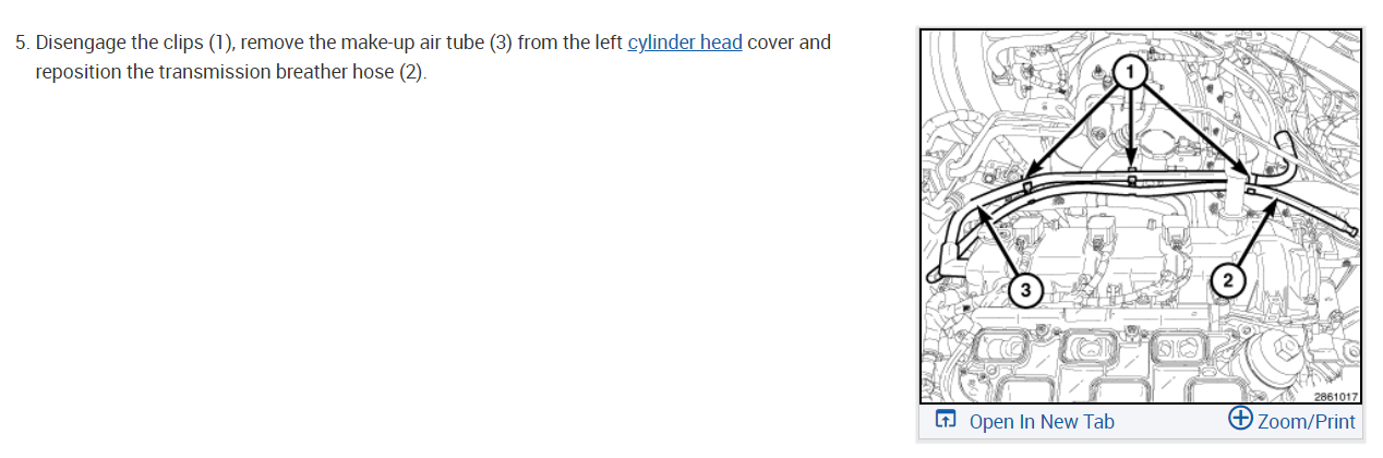

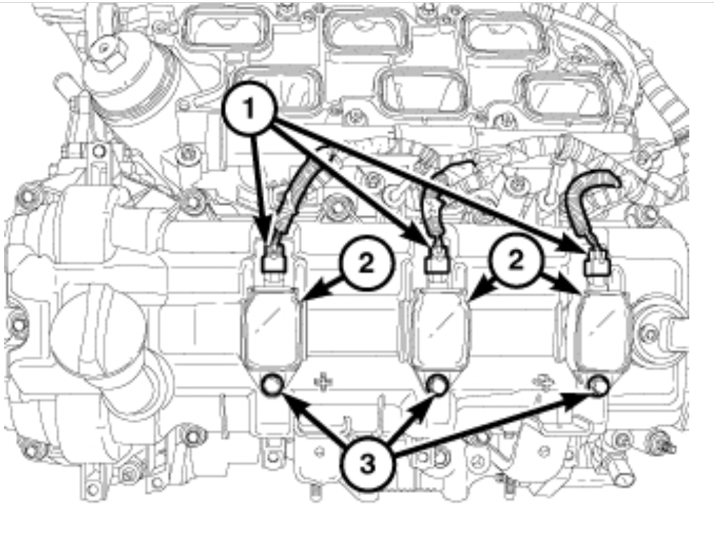

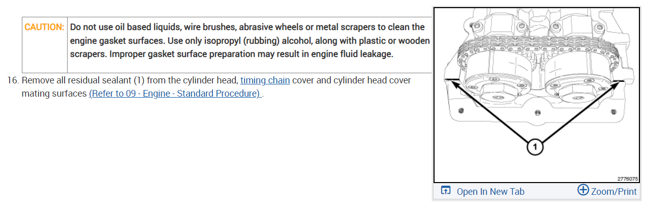

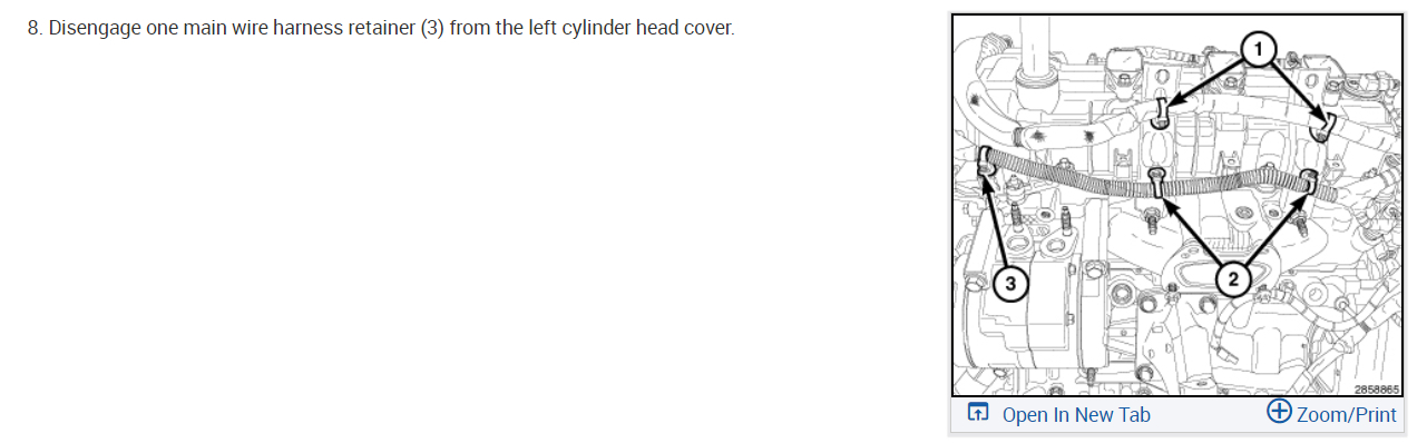

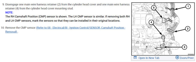

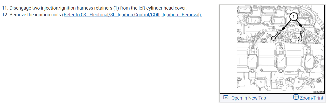

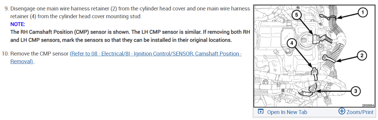

Thanks for the videos, yep it sounds like a roller follower that has come apart which is common, here is how to remove the valve cover so you can inspect the roller follower for #6 cylinder which is on the driver side rear cylinder. If the roller follower is bad it will cause a misfire codes even though the engine seems to be running pretty good. Check out the images (below). Please upload pictures or videos of the problem so we can see what's going on.
