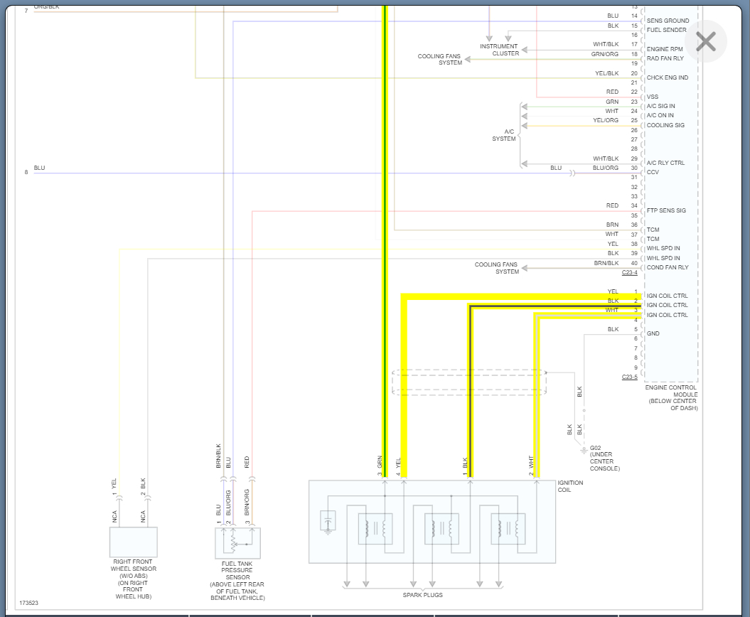

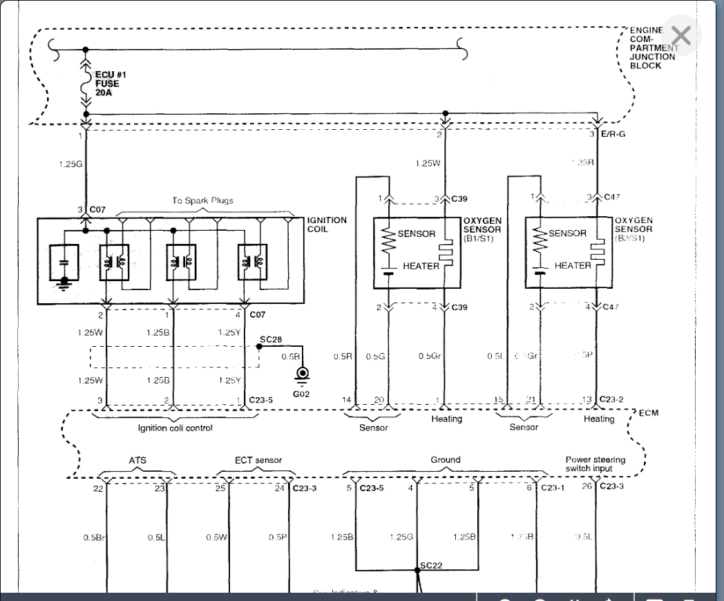

I’ve already gone through all the troubleshooting steps coil is in good working order plugs all good.
Did a Resistance test as follows on the four pin Molex plug going to the ECM.
GRN -> >
Wht. 4m ohm
blk. 4m ohm
y. 8k
I’m not sure if the driver circuit for “y” is it a default closed position or if this is indicating a problem, I have verified everything. I swapped the coils plugs and it’s definitely the driver circuit that is not firing the coil. My last attempt is to read the resistance directly at the ECM and depending on results run a separate wire from the ECM to that coil.

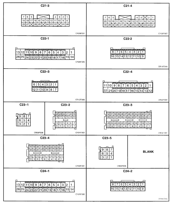

Any advice would be appreciated, and I was wondering if you could send me a picture of the plug C23-5 as it is difficult to see and navigate in that area. I’m assuming it is the nine-pin plug right next to the power plug. What has me a little confused is that it appears that the wire size at the ECM or a smaller gauge than what is in the engine compartment at the Molex plug going to the harness. I don’t want to start cutting wires if I don’t need to. I look forward to your response. Thank you
