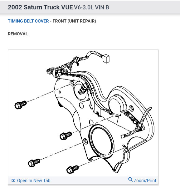

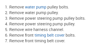

Scot,
If it has the original belt, I have a feeling it is stretched and causing valve timing issues. The idea that all cylinders on one bank or the other misfire, the belt is my first suspect.
I attached the directions below to remove the timing belt cover. I would open it up and inspect it for damage, dry rot, cracks, and tightness.
Let me know if you are comfortable doing this.
See pics below.
