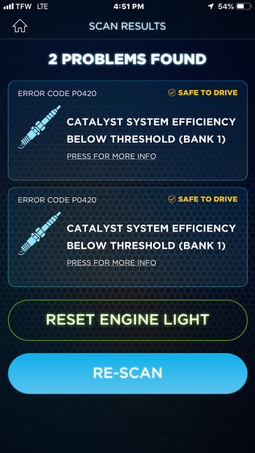

As far as the codes, what one is coming up for the catalytic converter? Is it a P0420? Also, considering the mileage and the two cylinders are next to each other, we may have an issue with a head gasket. You will need to check engine compression to confirm it is within spec. Also, I need you to check for a head gasket issue.

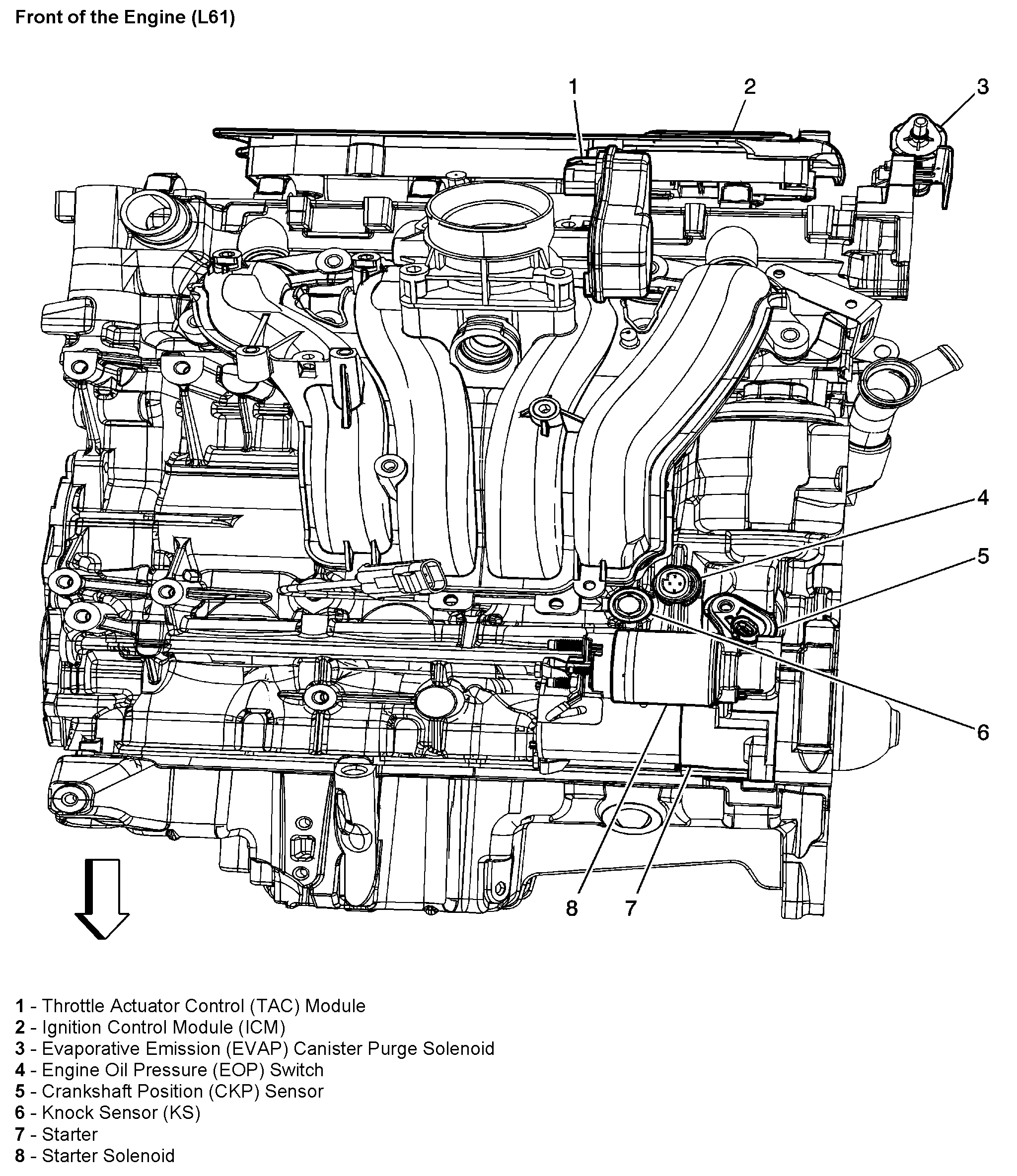

Here are the directions specific to your vehicle for testing compression. In the directions, it says to disconnect the ignition module. I attached a picture of its location.
