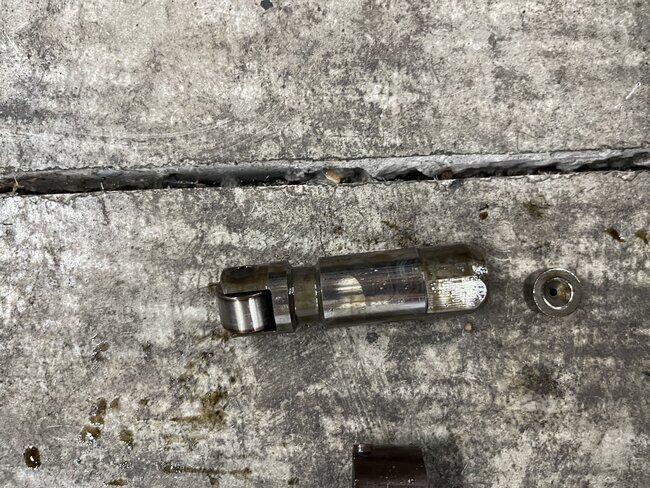

Is it possible that if the rocker arm or lifter tapping is on the same side where the misfire is that it can be due to the lifter? As in the lifter being bad causing a misfire? I replaced lifters on Hemi's before but didn't have a misfire.
