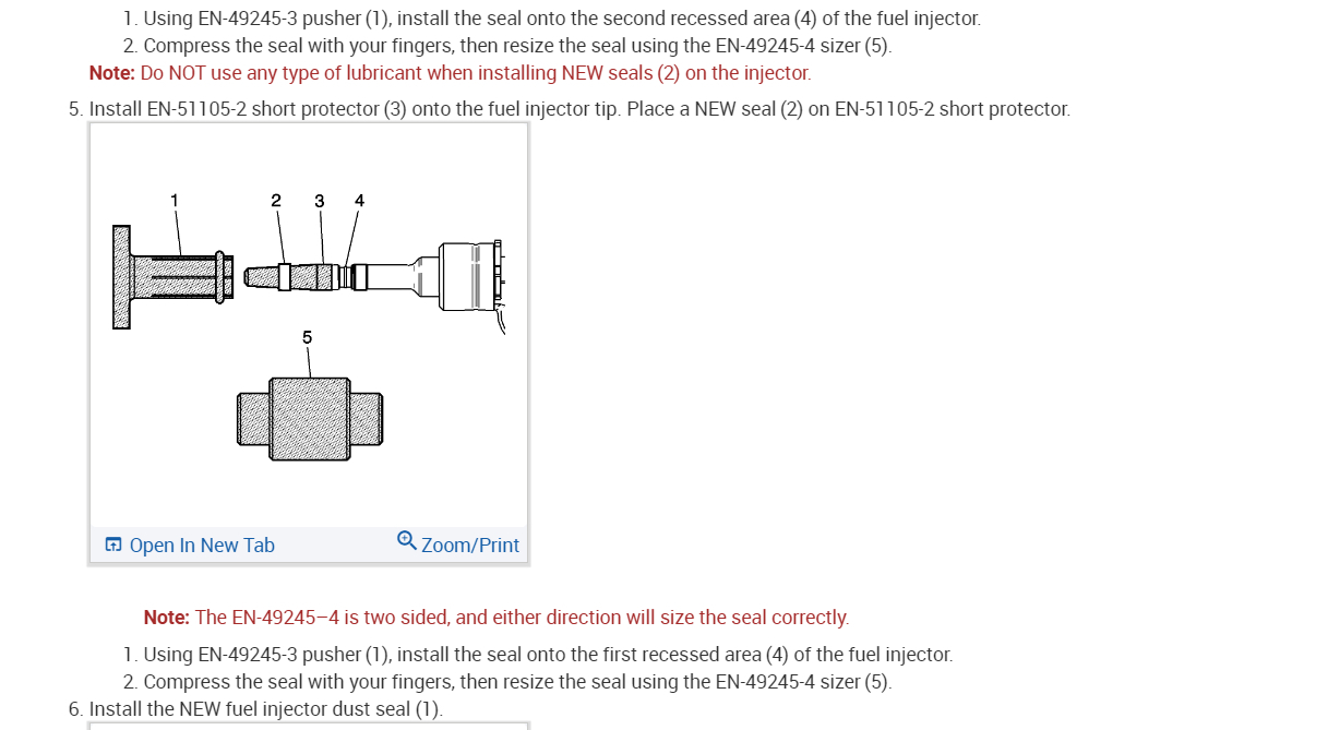

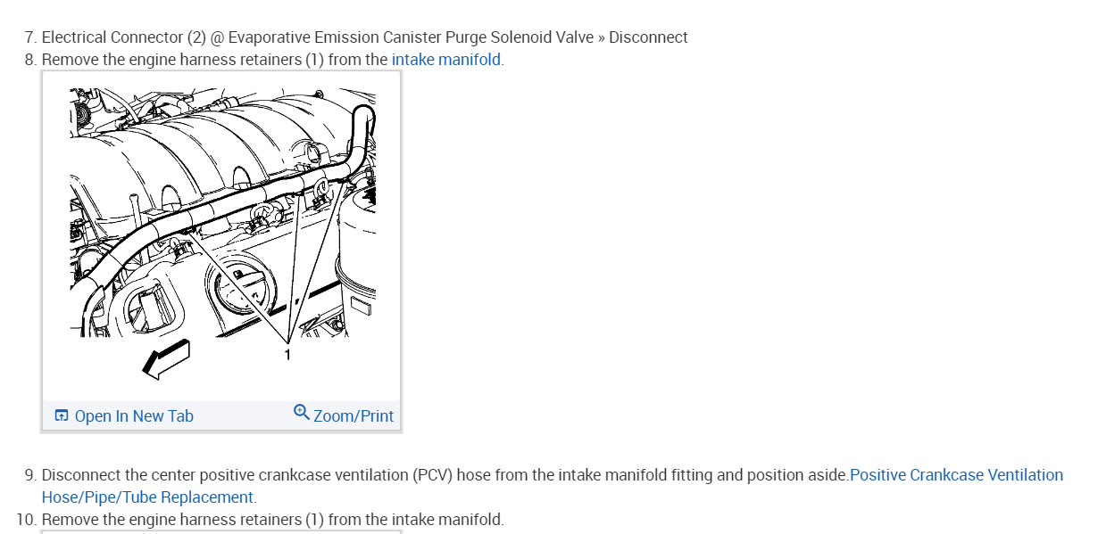

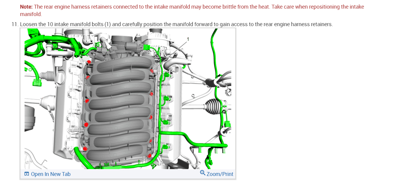

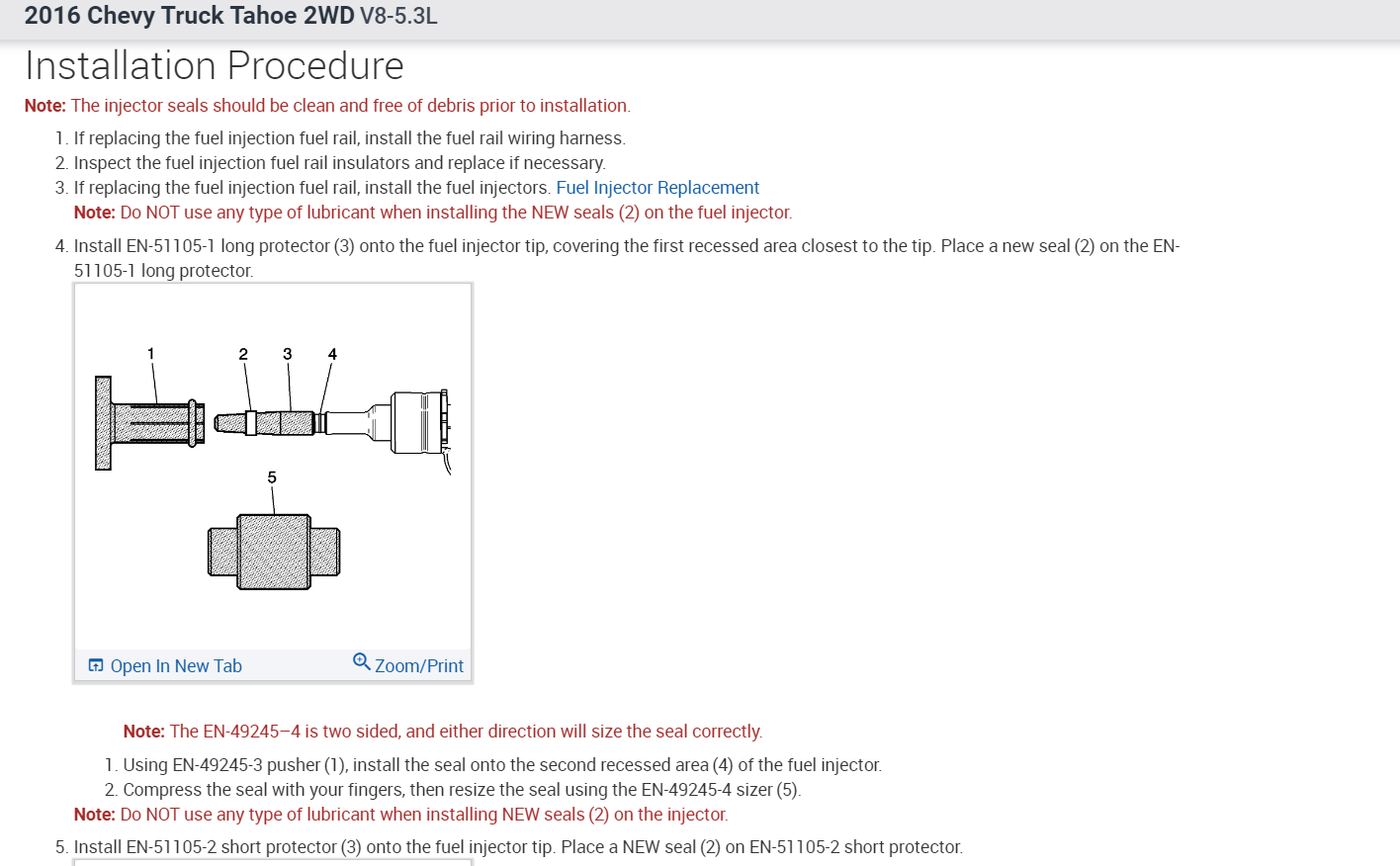

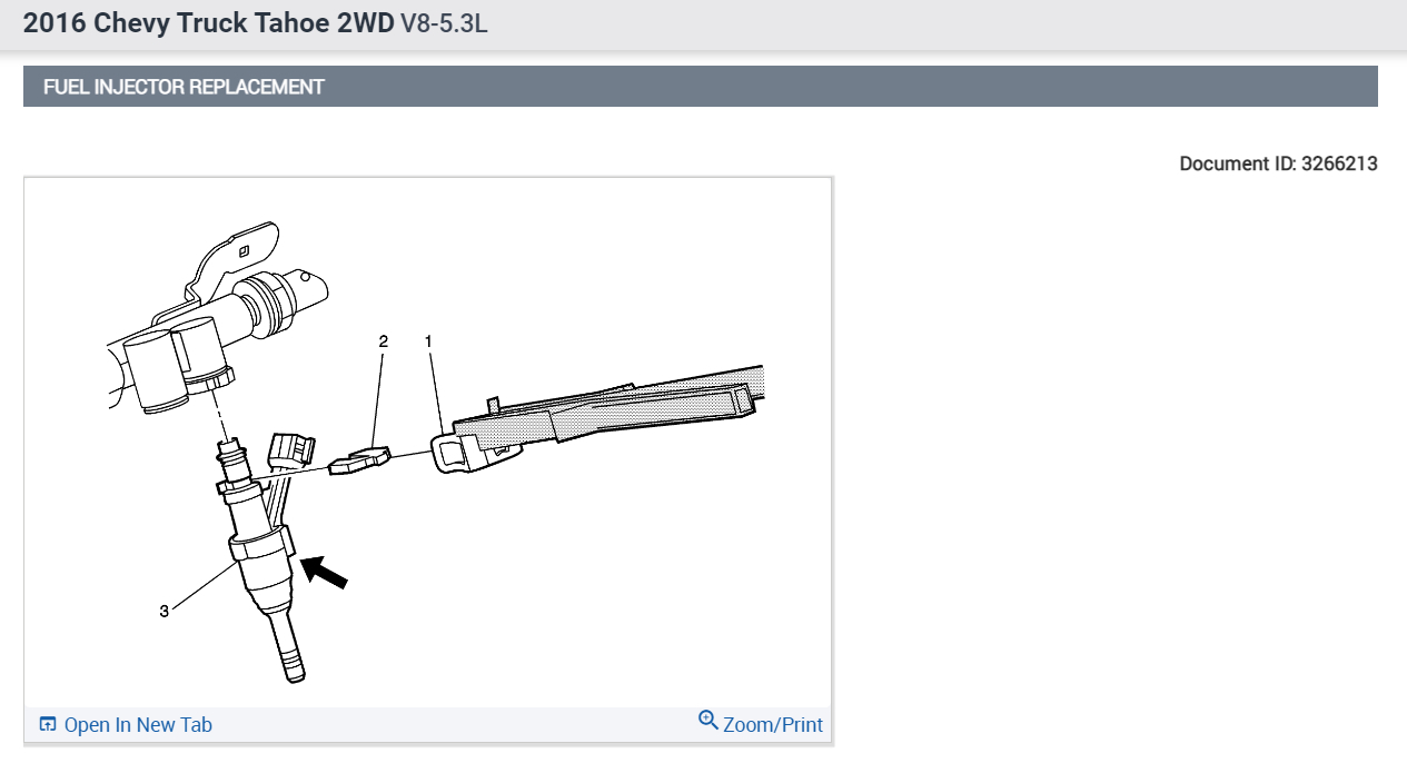

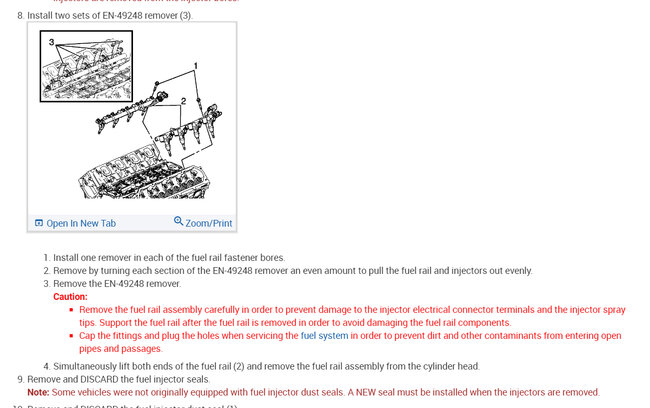

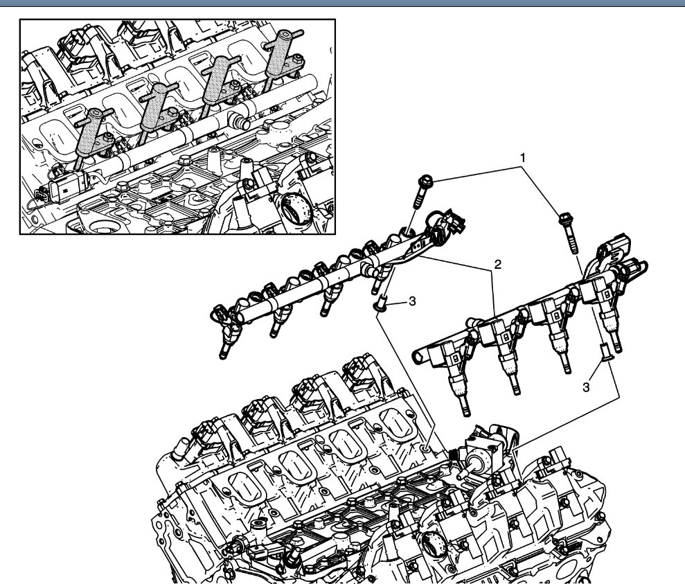

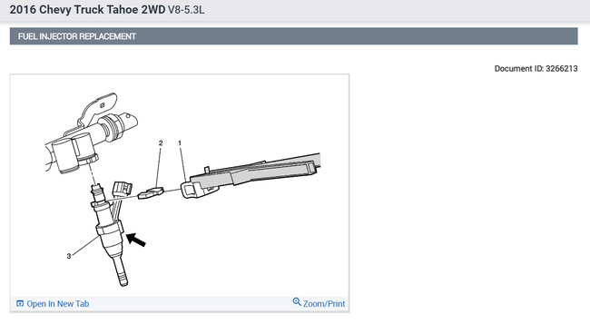

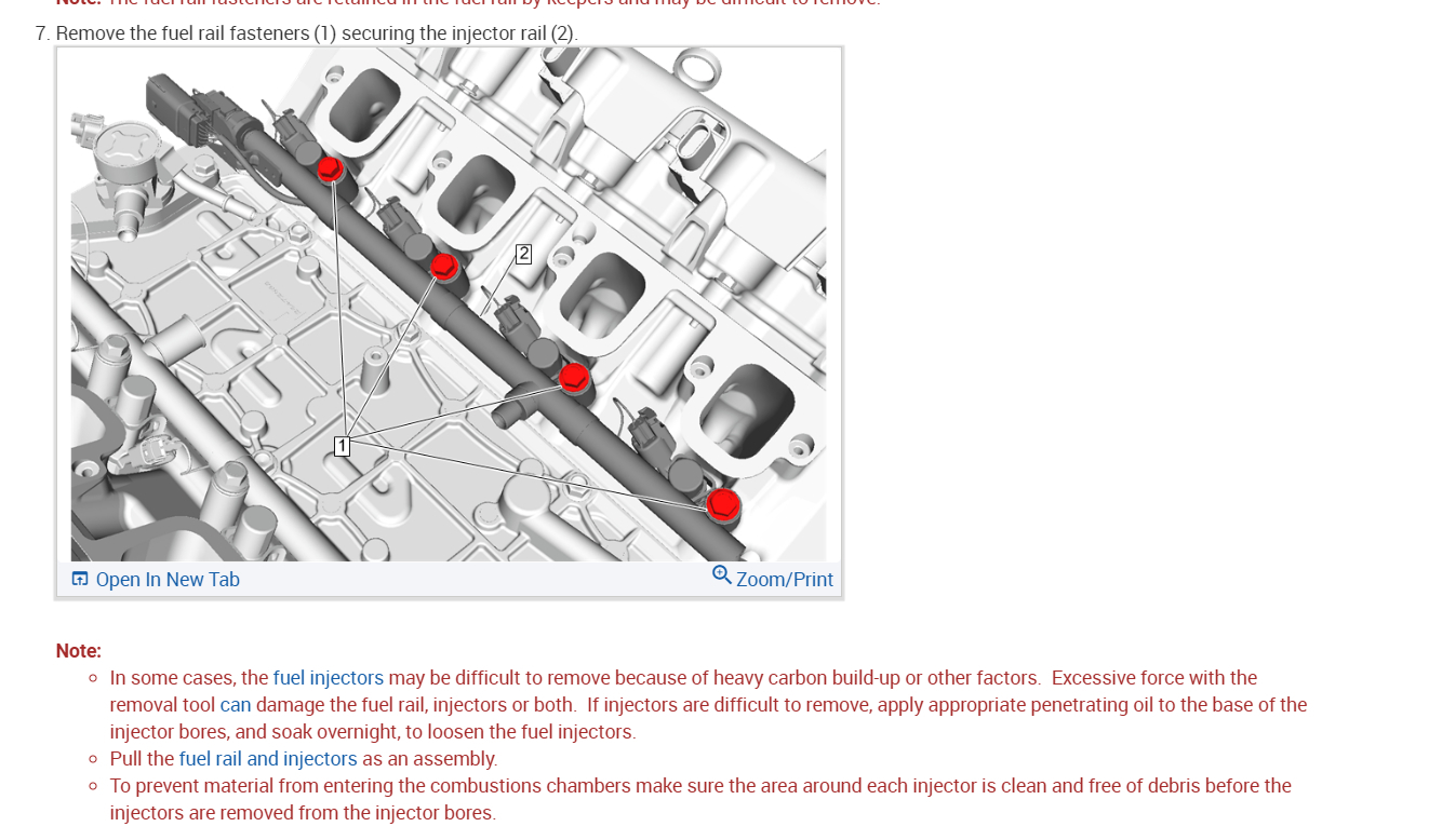

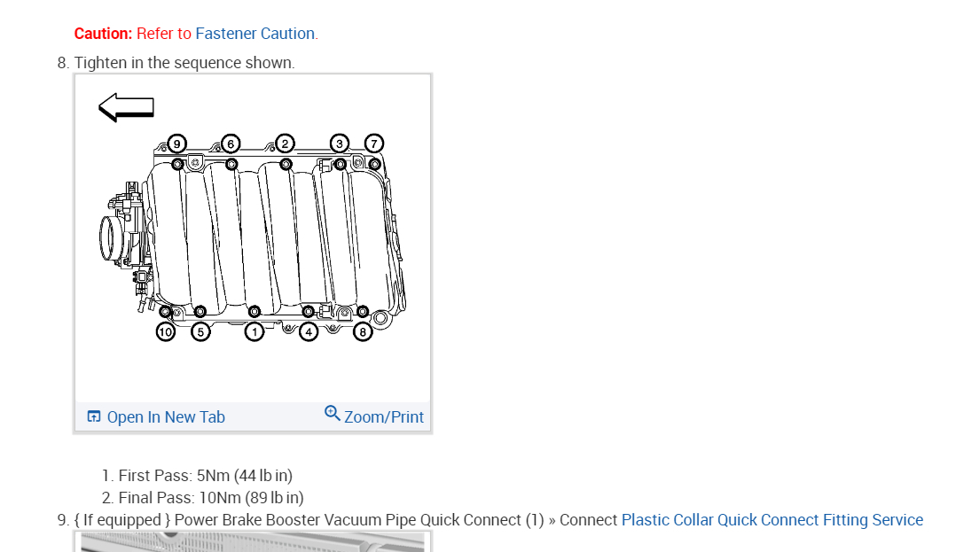

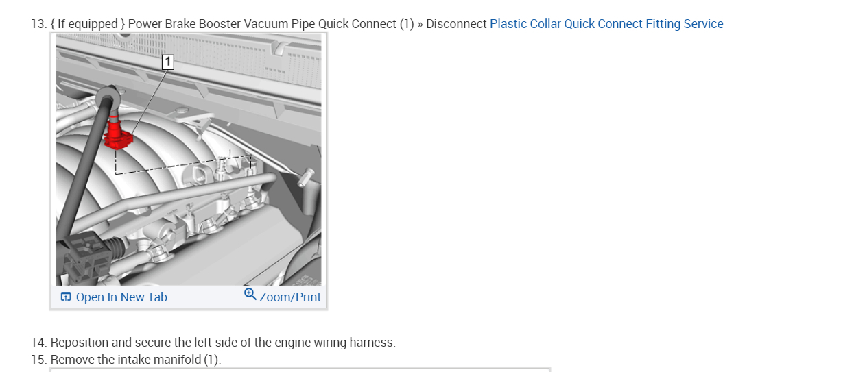

We only handle one problem per thread. We need to remove the spark plug to see what it looks like, if it is clean or like new there is no fuel getting into the cylinder and the fuel injector needs to be changes out here is the instructions so help you do the job and I have included this guide which may help as well.
https://www.2carpros.com/articles/engine-misfires-or-runs-rough

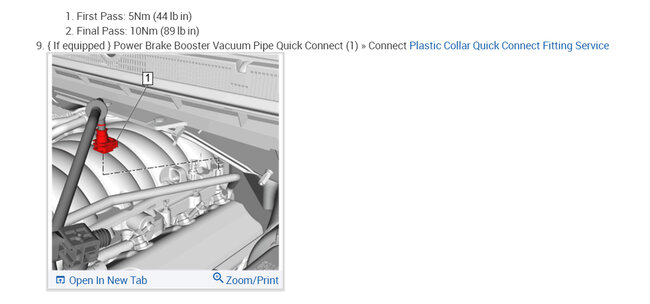

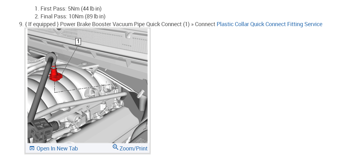

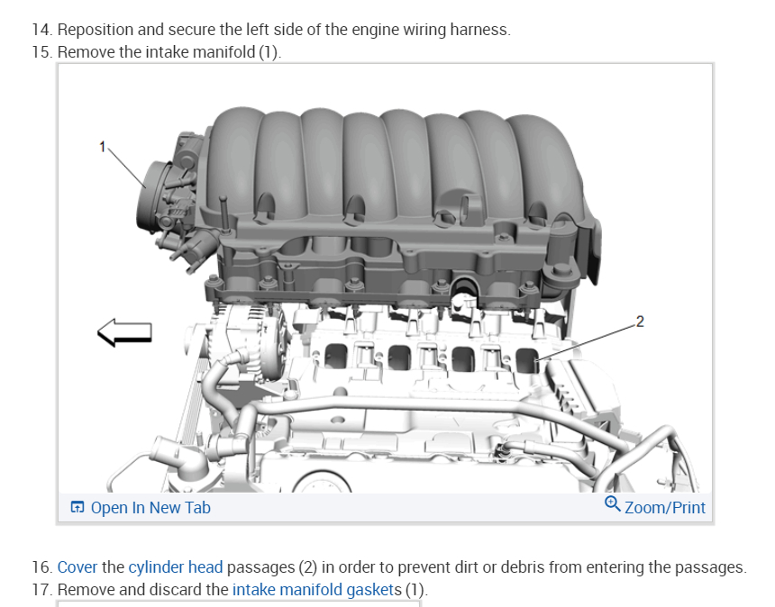

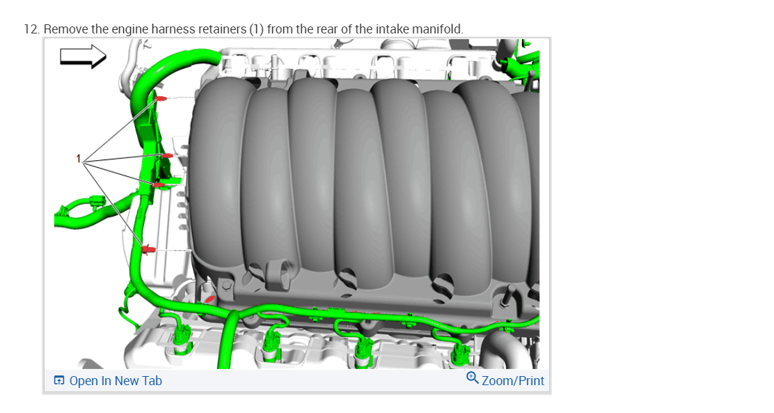

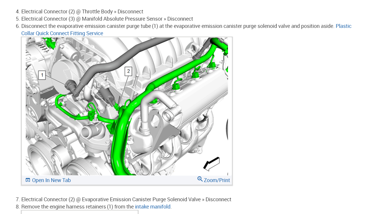

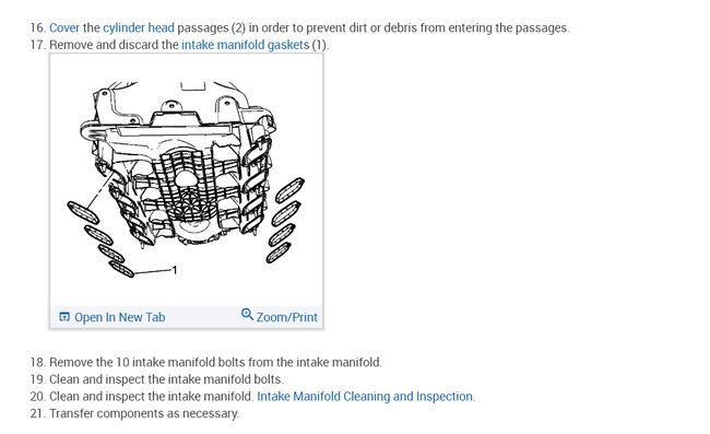

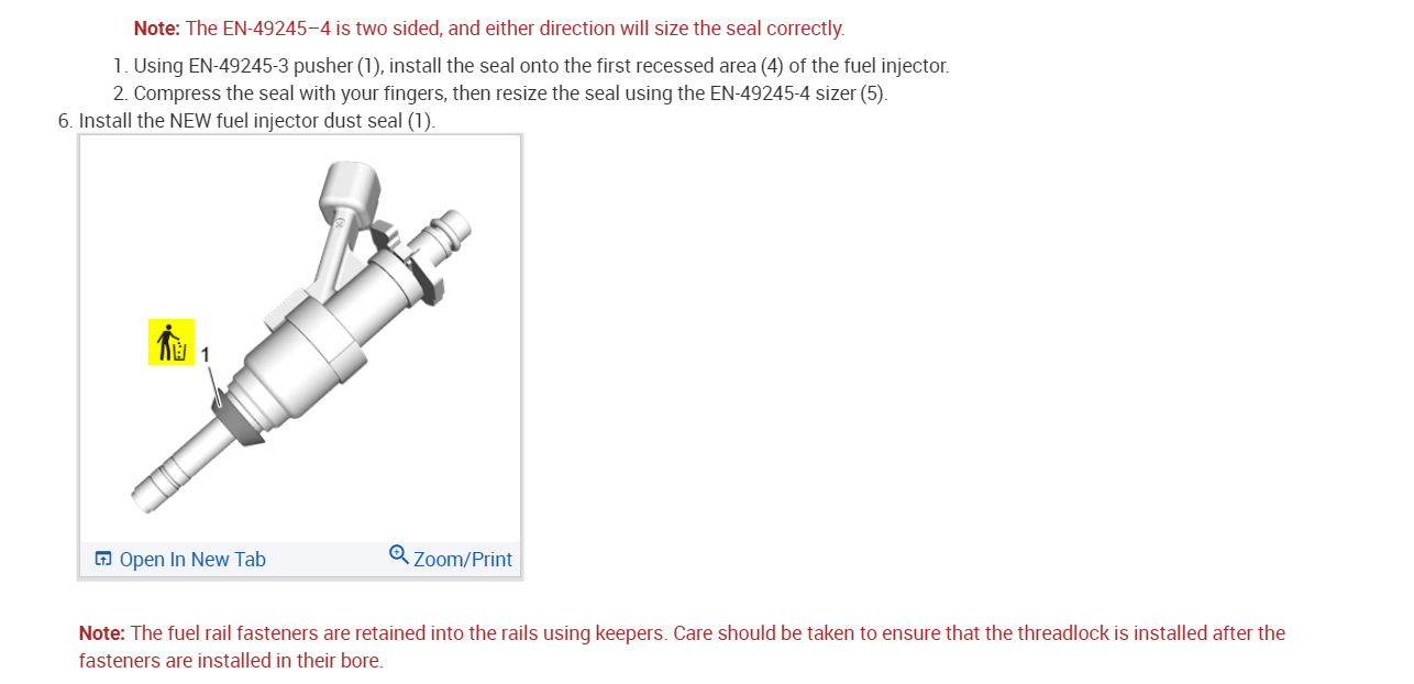

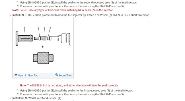

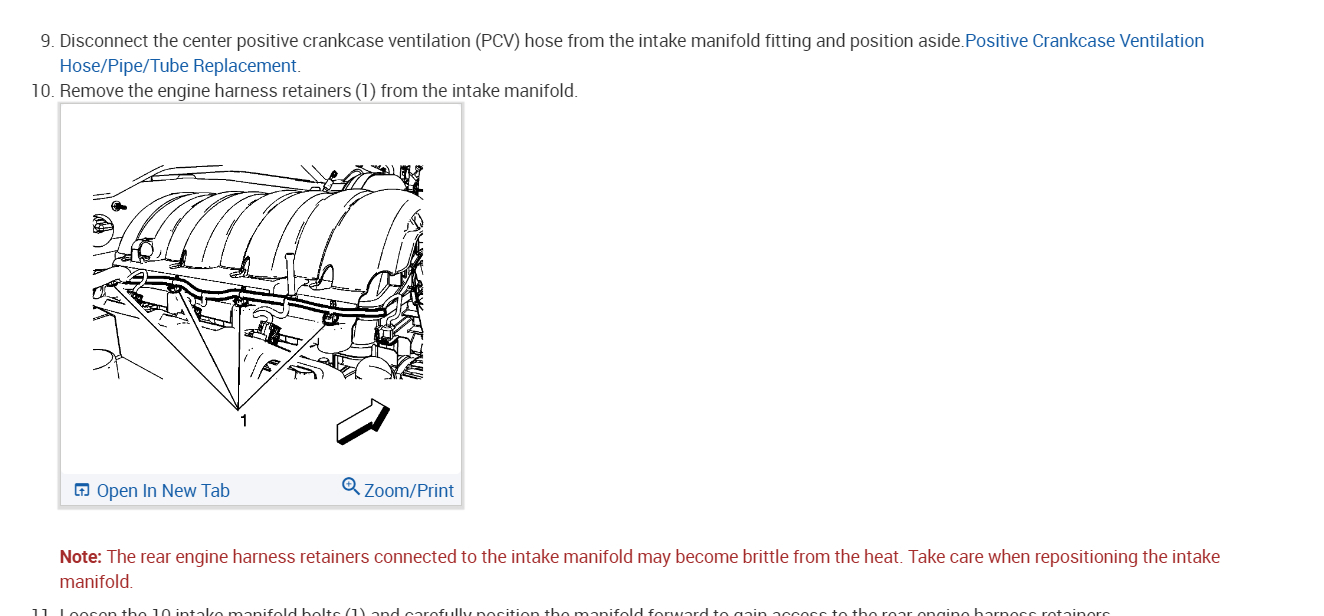

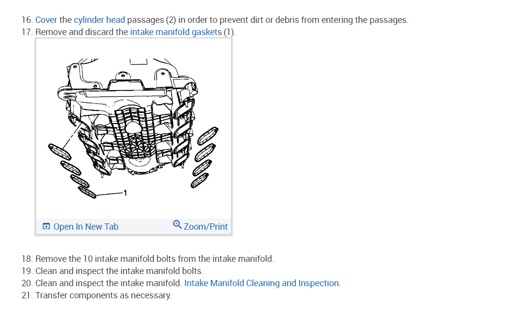

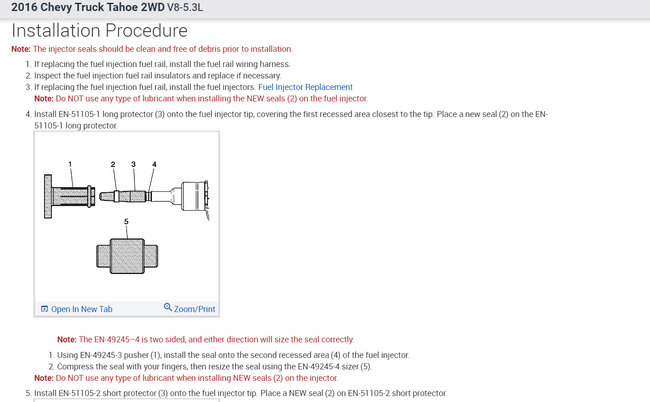

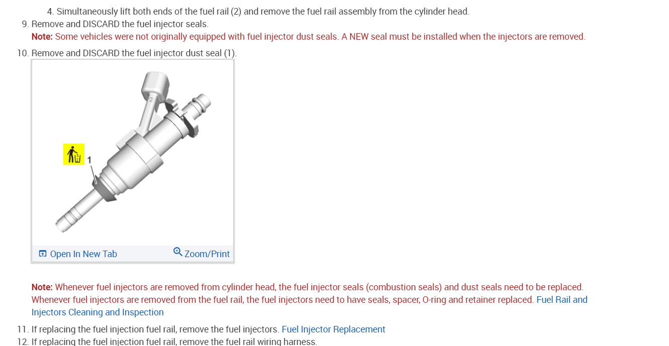

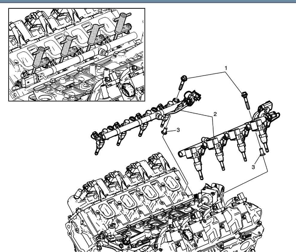

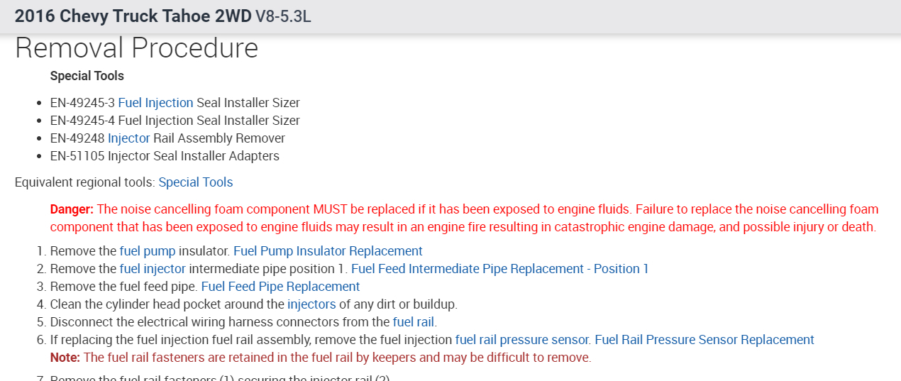

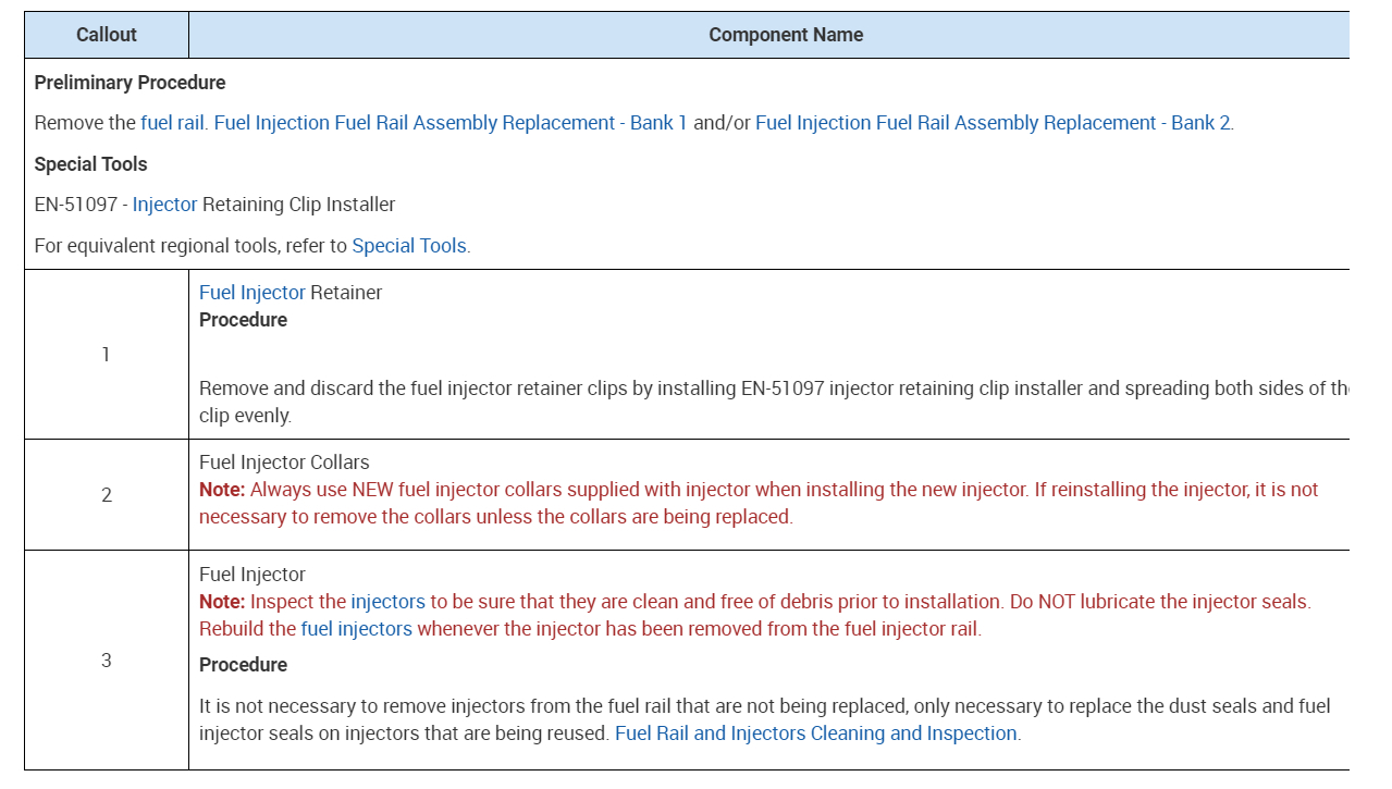

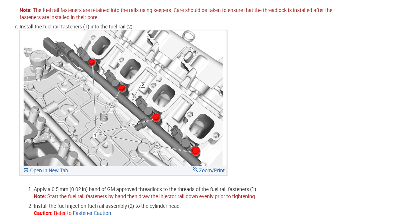

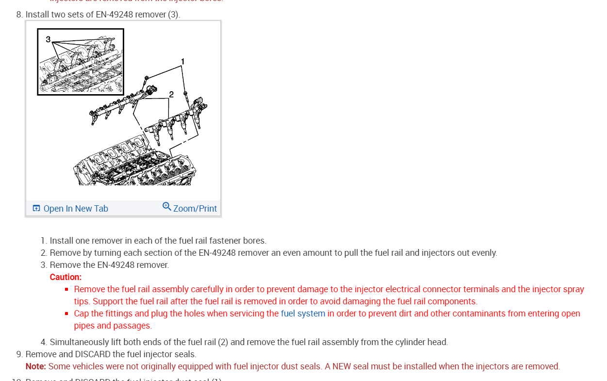

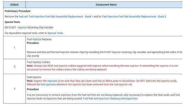

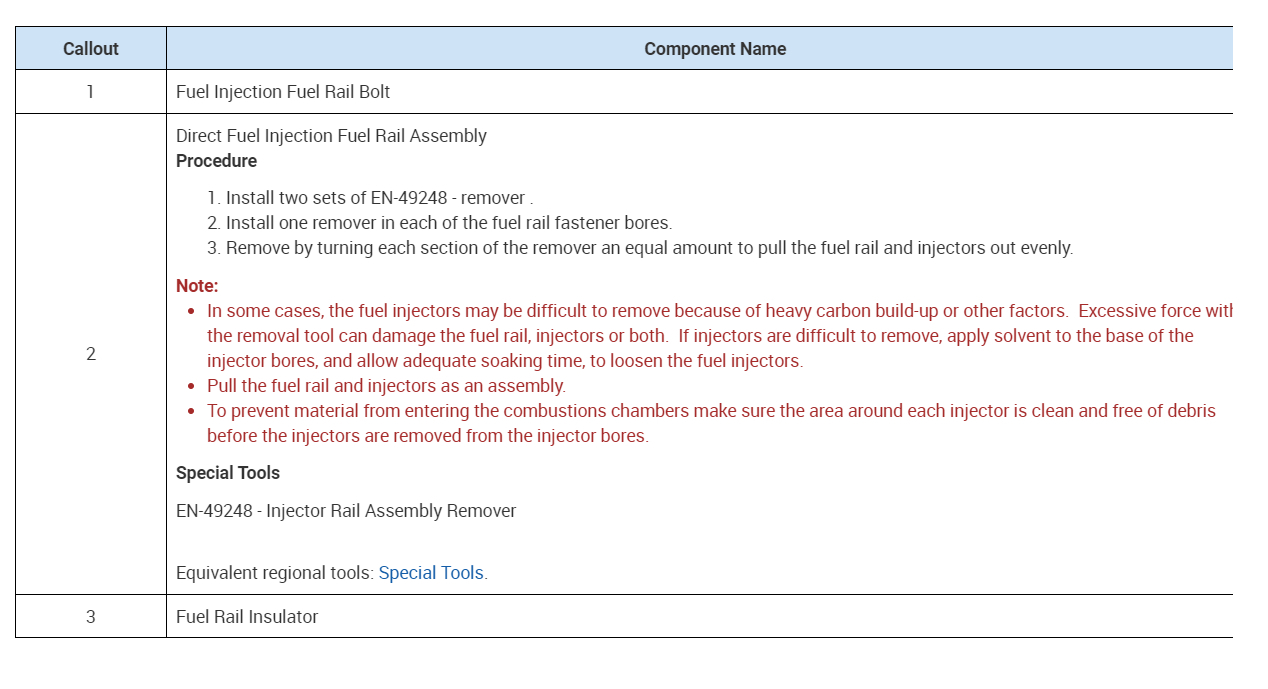

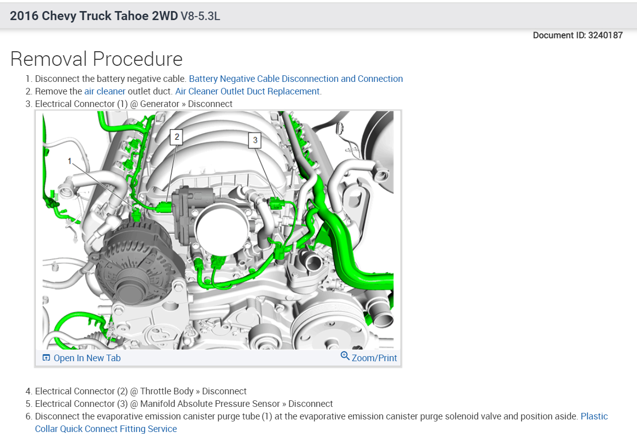

You will need to remove the intake manifold which I have included instructions on as well. Check out the images (below). Let us know what happens and please upload pictures or videos of the problem so we can see what's going on.
