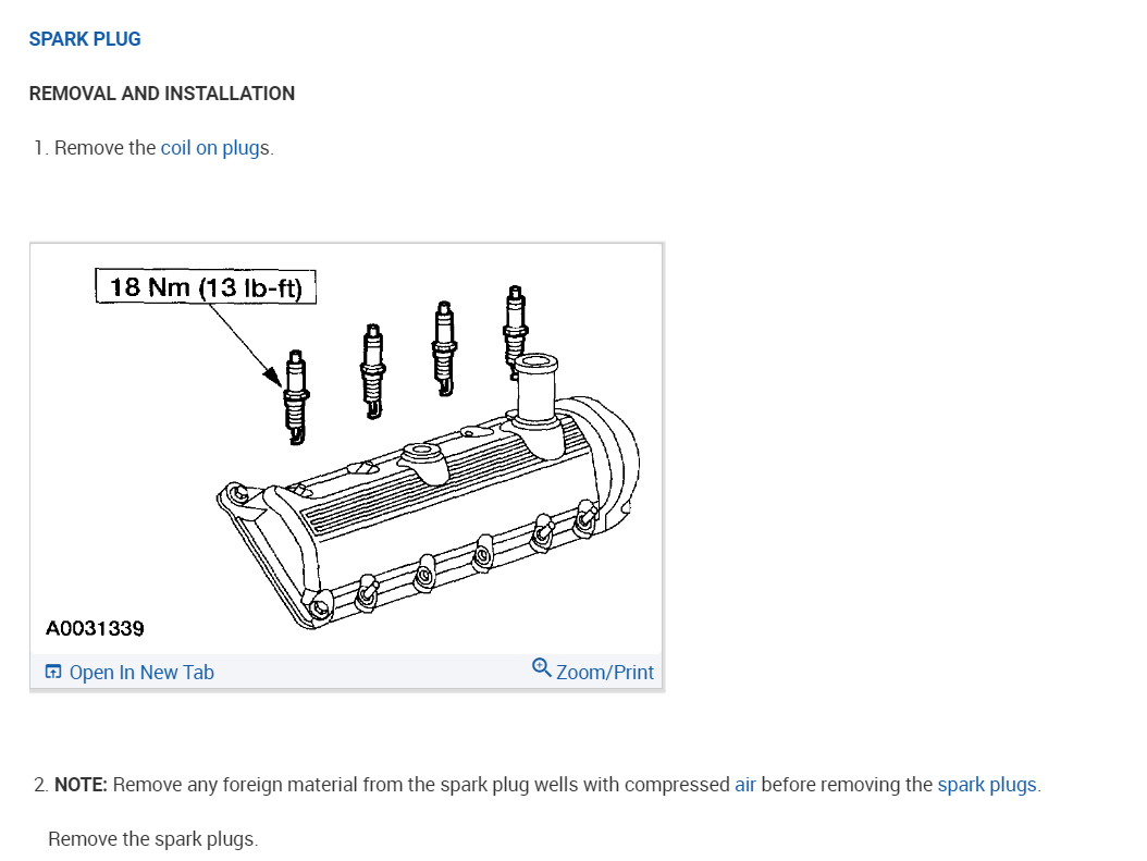

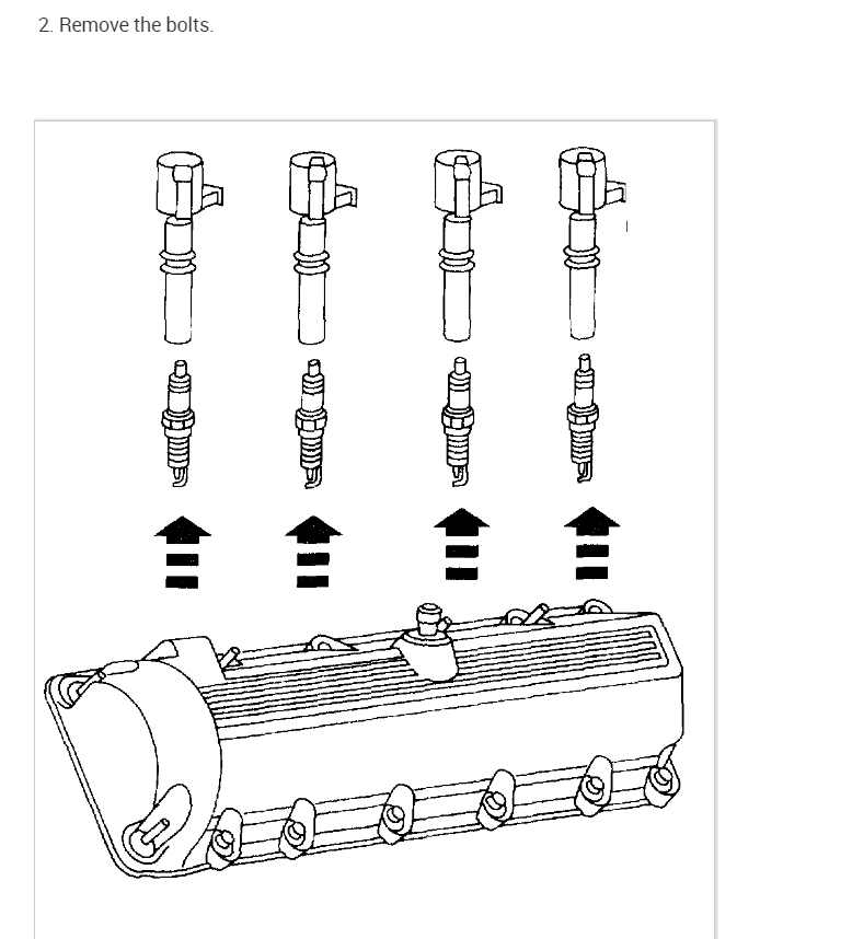

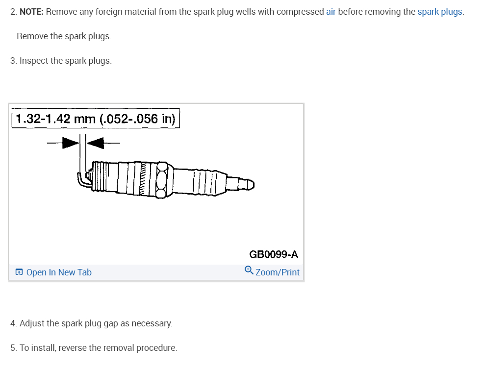

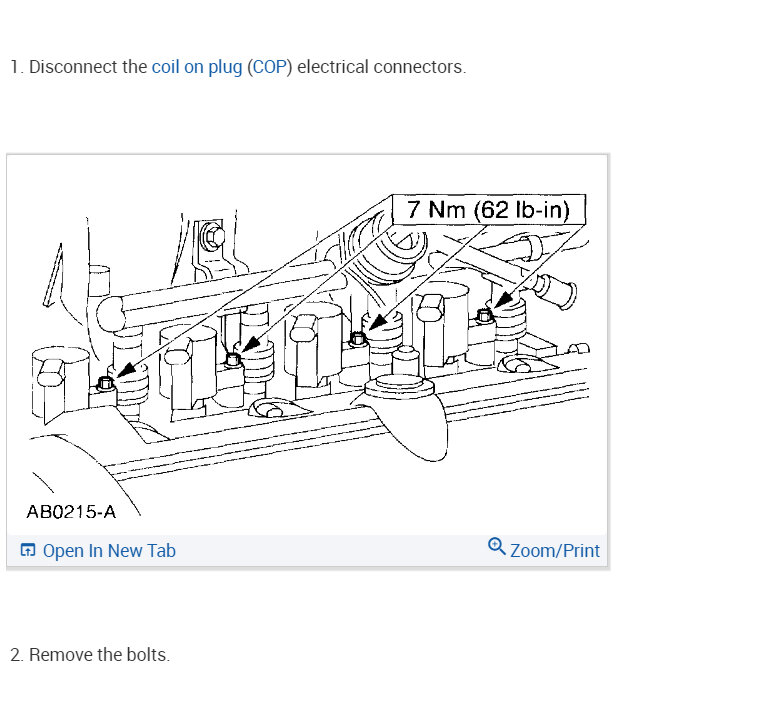

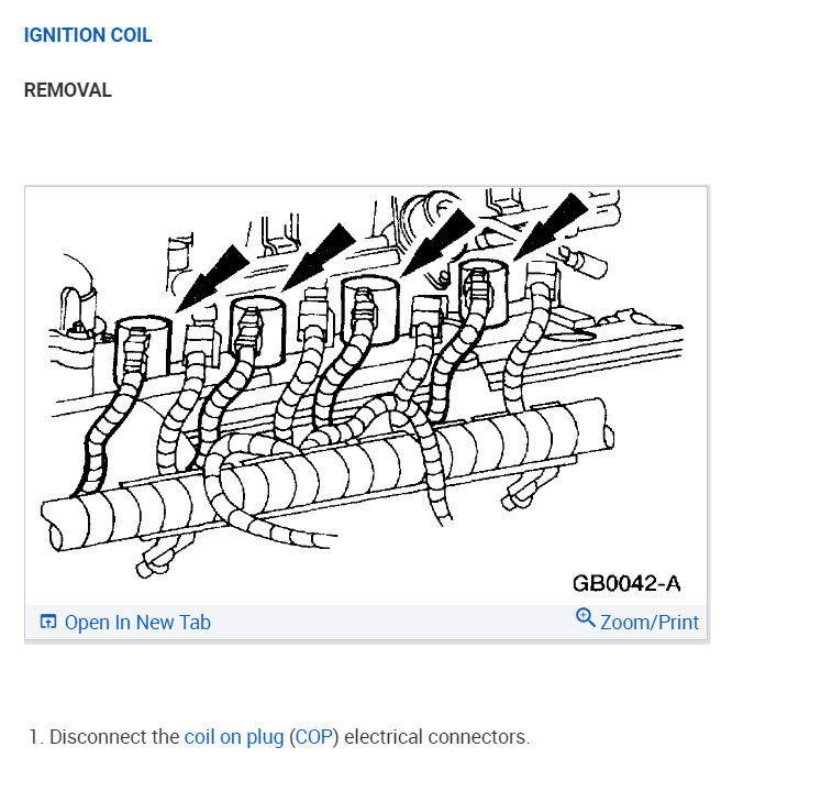

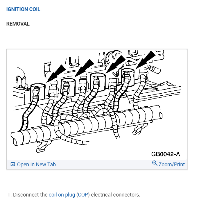

So, it sounds like you have a spark plug or ignition coil that has failed, I would remove the coil and spark plug to replace them because this is a big problem with these engines here is a video to show you how.
https://youtu.be/E6oier7agkY
Spark plug type .................... AWSF-22W
Here are instructions in the images below as well. Check out the images (below). Let us know what happens and please upload pictures or videos of the problem.
