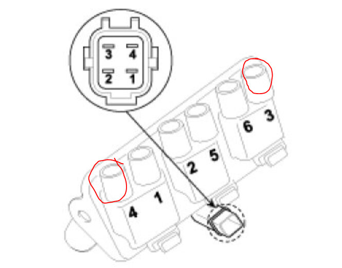

I changed my spark plugs and coil pack which were the reasons the check engine light was on in the beginning. I disconnected my battery as well while doing this. I plugged my battery back in after installing new spark plugs new spark plug cables and coil pack and my car is flashing check engine light saying that's a third and fourth cylinder are misfiring why is that.
Mar 17, 2023 at 9:10 PM
If the light is flashing, that indicates a misfire is occurring. The first thing I suggest is to confirm you have the spark plug wires in the correct positions.
I attached a pic below showing the coils and identifying what cylinder each wire goes to.

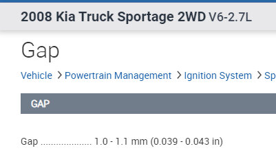

Next, if the wires are correct, remove cylinder 3 and 4 spark plugs and make sure the gap is set properly. Also, make sure dirt didn't get on the electrode when you were installing them.
(See pic 2)
