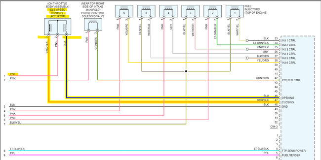

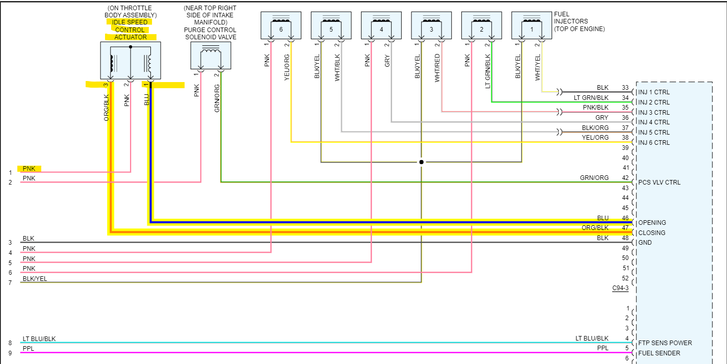

This is not referring to Ignition coil 1 and 2, it is the Coil windings inside the Idle Air control (IAC) valve. There is a resistance test on the 3 wire IAC valve while unplugged, engine off. As well as a power feed check if you have a basic multimeter. But we also need to know MAF code is setting.

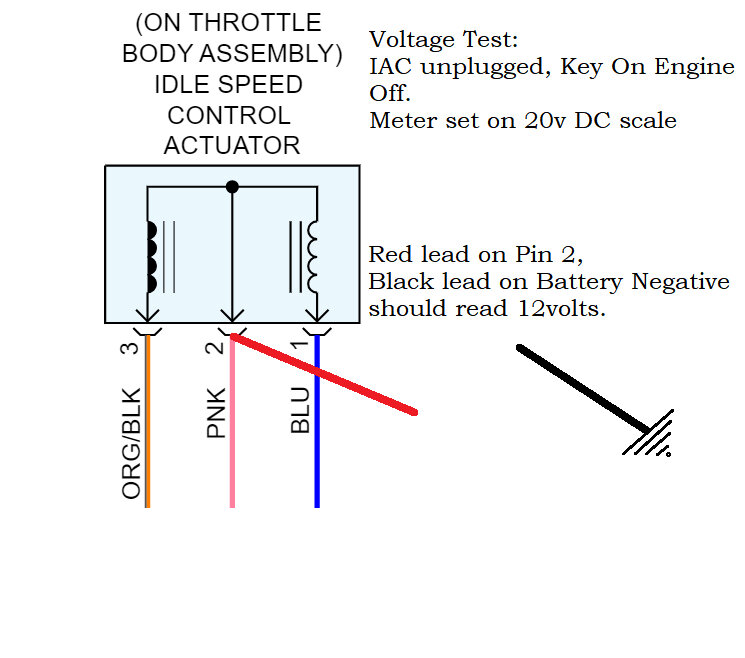

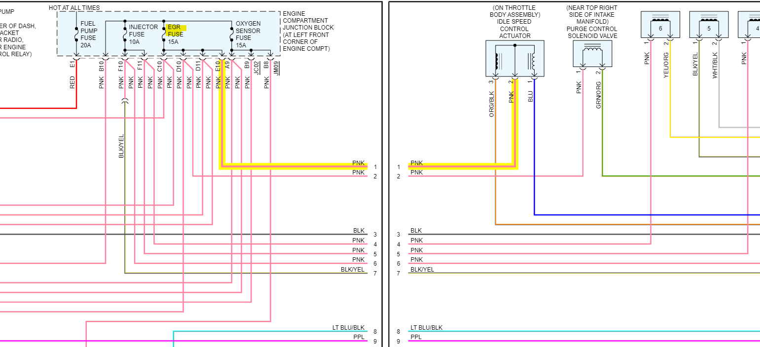

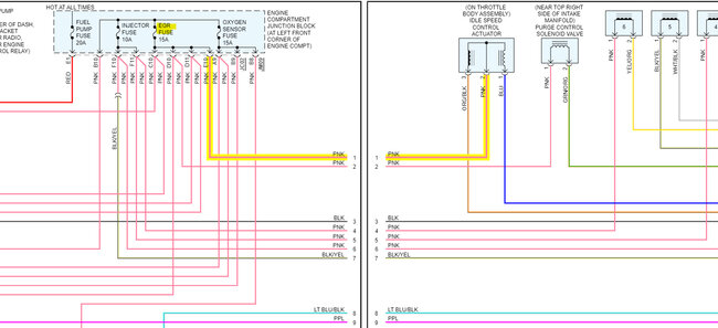

The first thing to check with these two codes (P1505 and P1507) is the 12v power feed to the IAC, with the IAC unplugged and Key On engine off, check the pink wire with the red meter lead and the other meter lead on battery negative. There should be a full 12volts on the pink wire.

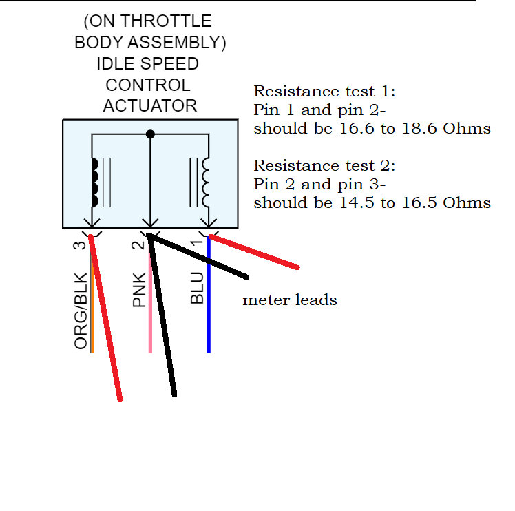

The 2nd test is checking the internal coil windings to the IAC.

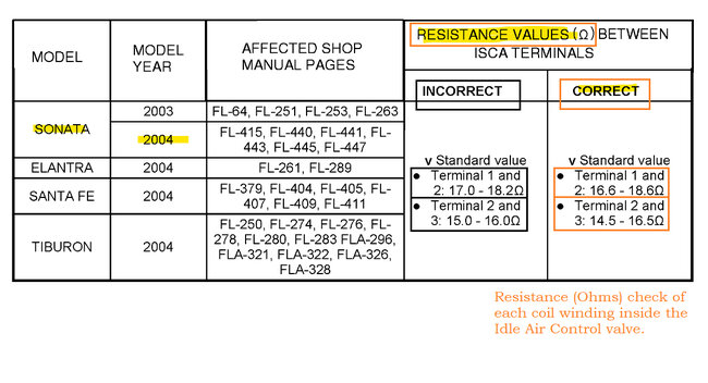

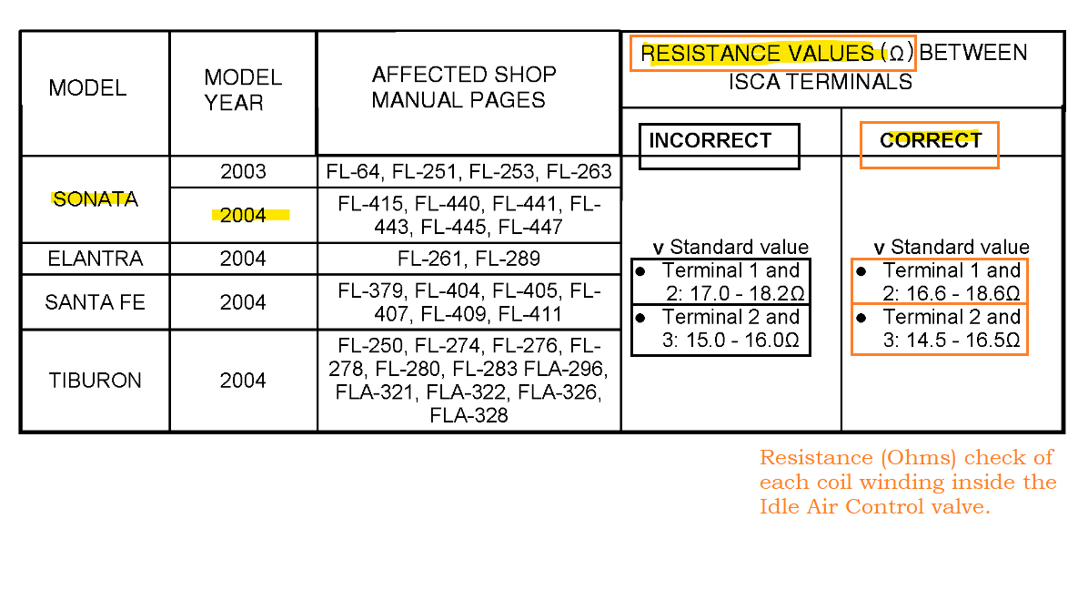

There are updated measurement values for the IAC resistance. So, you would unplug the IAC and check across pins 1 and 2, and then 2 and 3. (Diagrams below)
