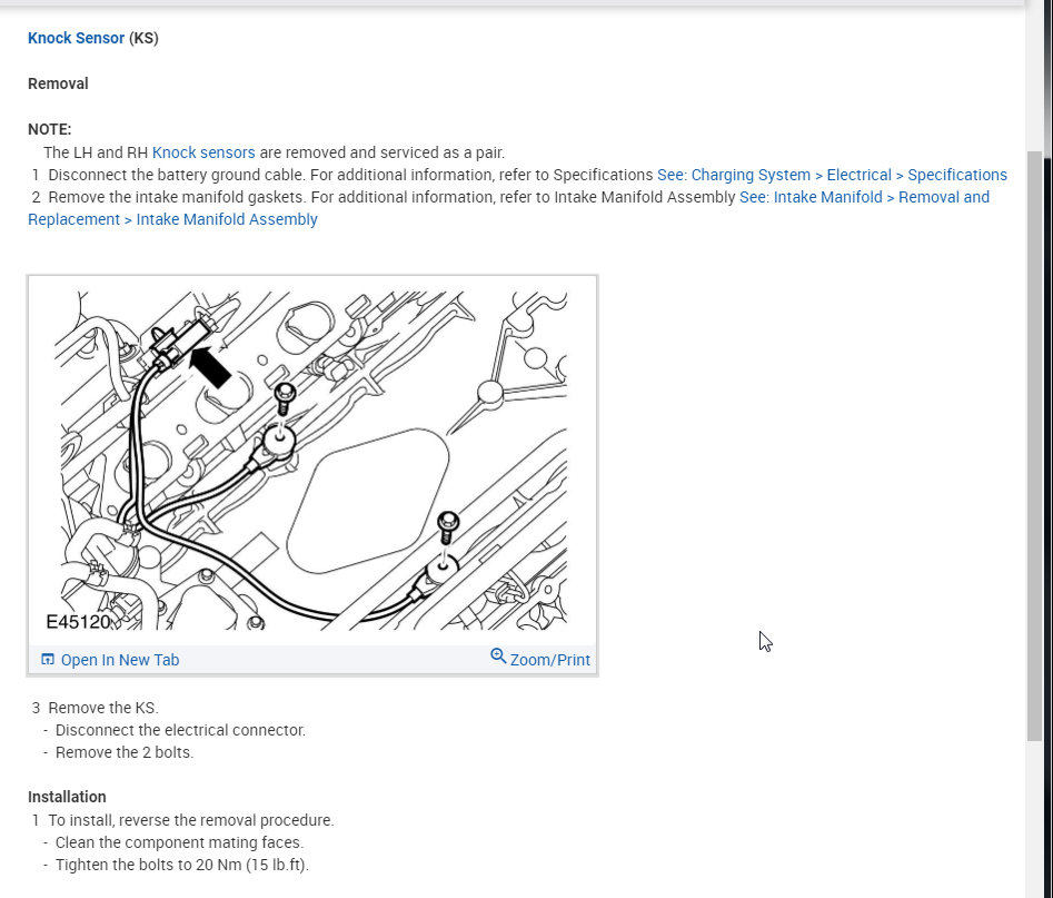

Also a knock sensor code p0322 or p0332 can't remember.
Do these have carbon build up issue as being common? Could a knock sensor cause it to misfire?
