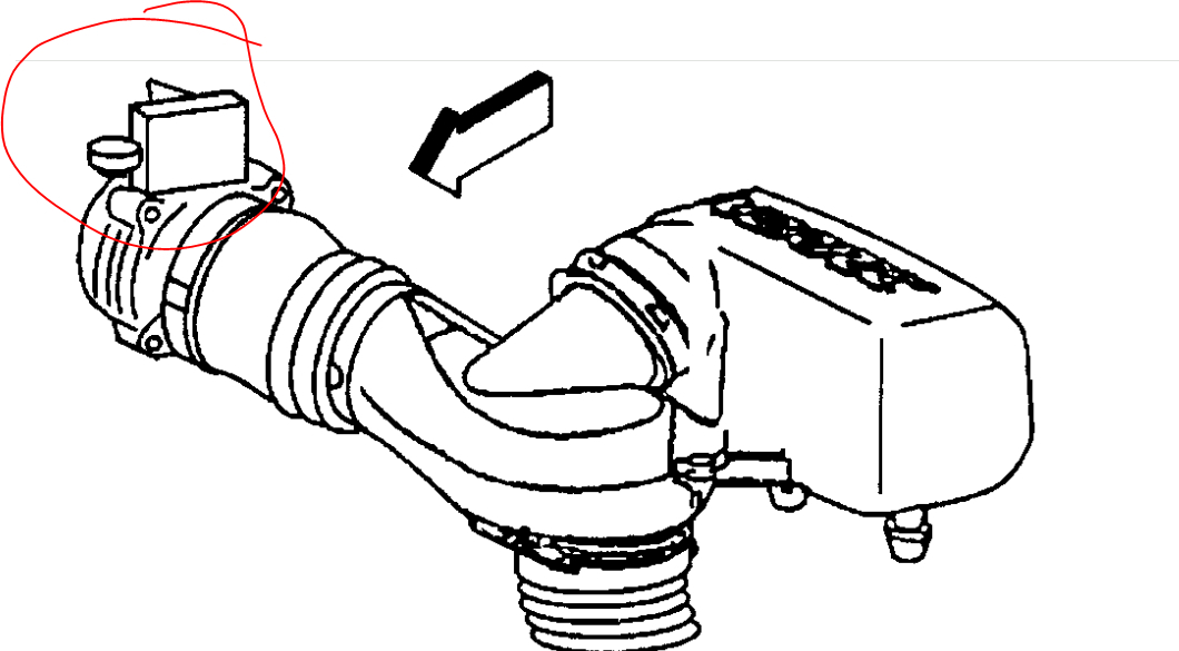

If you removed the air intake, you may have damaged the mass air flow sensor. Since this started after you removed the cold air intake, that would be my first suspect unless there is a leak because something isn't fully mounted. Any air that gets into the engine that is unmetered (after the MAF) will cause problems.
Since you have an aftermarket cold air intake, I'm not certain how it is set up. However, there has to be a MAF in there at some point. (pic 1 below shows the OEM type) If you bumped it or got any solvents or cleaners on it, chances are it is damaged.
Check that first, make sure the wiring to it is properly connected and not damaged. Also, make sure the inlet is fully seated not allowing unmetered air to get into the engine. Also, if you disconnect it, the engine may run better if in fact it is damaged.
Let me know what you find.
